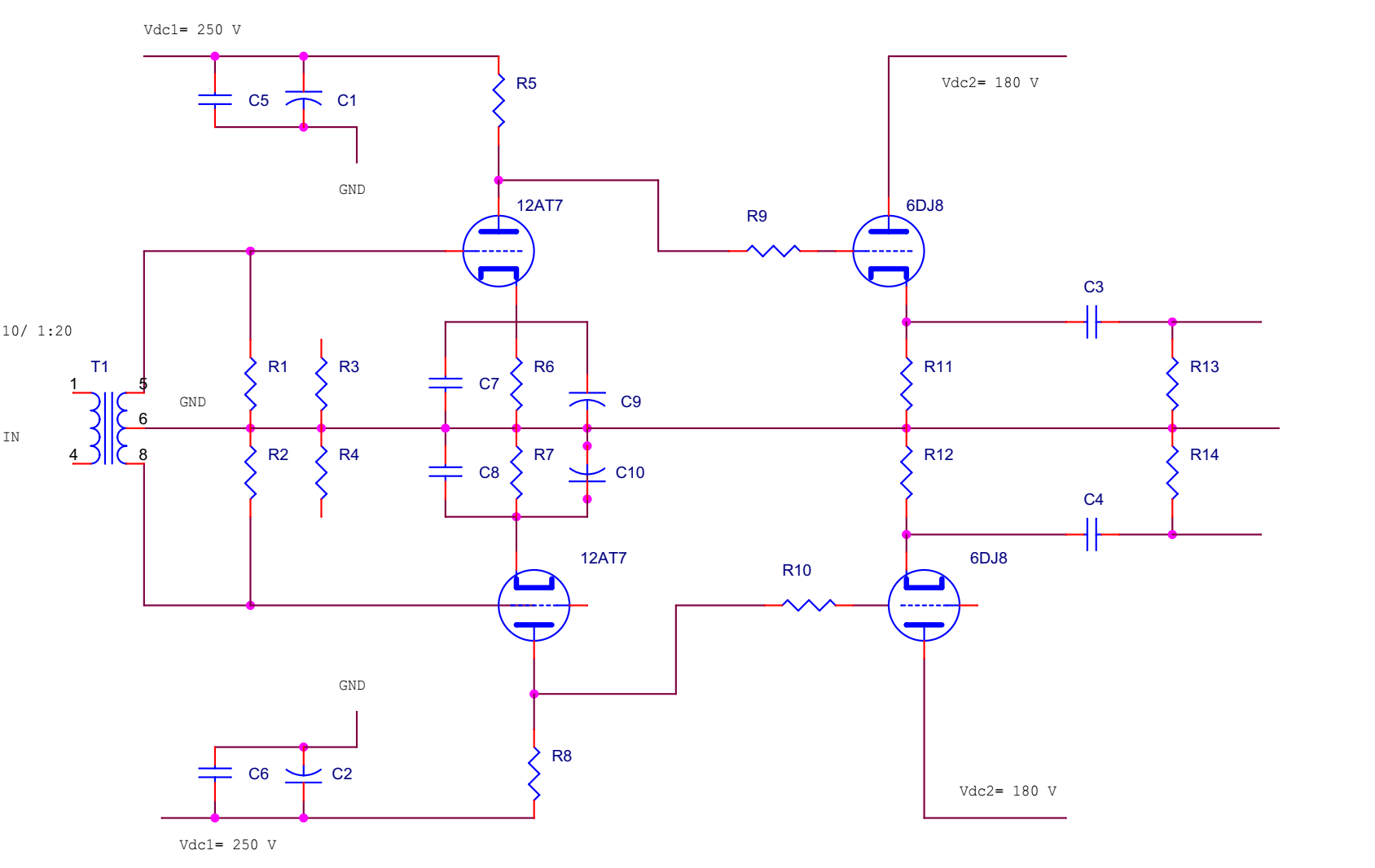

The amplifier following the mic amp is Behringer audio interface. The input impedance is not given by the manufacturer but generally mix preamps are 1.5-2K.I don't see any need for (60 €) output transformer. The White cathode follower can supply easily 300...600 ohms load. What is the input impedance of the amplifier following the mic amp?
I wanted to preserve the 1:10 impedance bridging principle, and besides, have a balanced signal for the XLR input on the interface. You would need a differential output to drive 600 ohm balanced line if no transformer.
Improvements to the SNR and CMRRR and ground loops at the cost of -12db gain in the 4:1 transformer.
Can you please further elaborate on this idea? Does that imply following a differential topology all the way through including differential output?Why not configure the 6N1 as a differential input?

Please see post #7.Can you please further elaborate on this idea? Does that imply following a differential topology all the way through including differential output?
Very interesting. Thank you!One other solution can be a :
Input trafo ratio 1:10 and 1:20 to cover most of the mics
Ecc81
CF with Ecc88
A good selection of the components needed.
full balanced
Zout around 200 ohm
An example
Is missing the 48 vdc but is simply
Walter
One important consideration is the power supply that can be very accurate with a perfect decoupling between the stages.
It will have a great impact on sound and residual noise
Walter
It needs the first twin triode cathodes tied together & that tied to some kind ofOne other solution can be a :
cathode tail resister for improved balance, just as any Diff Amp.
No, just make a good selection of tubes with a good testerIt needs the first twin triode cathodes tied together & that tied to some kind of
Amplitrex is one good choice
Or with an good audio card and Arta or REW software is possible to check the gain and noise
Walter
Thank you! E88CC is the choice for WCF for sure, but I wanted to shoot for grounded DC heater supply vs. elevated.I would say looks good, I prefer E88CC over 12AU7. Decouple the first stage supply.
In the final build I will give that due consideration.One important consideration is the power supply that can be very accurate with a perfect decoupling between the stages.
Walter

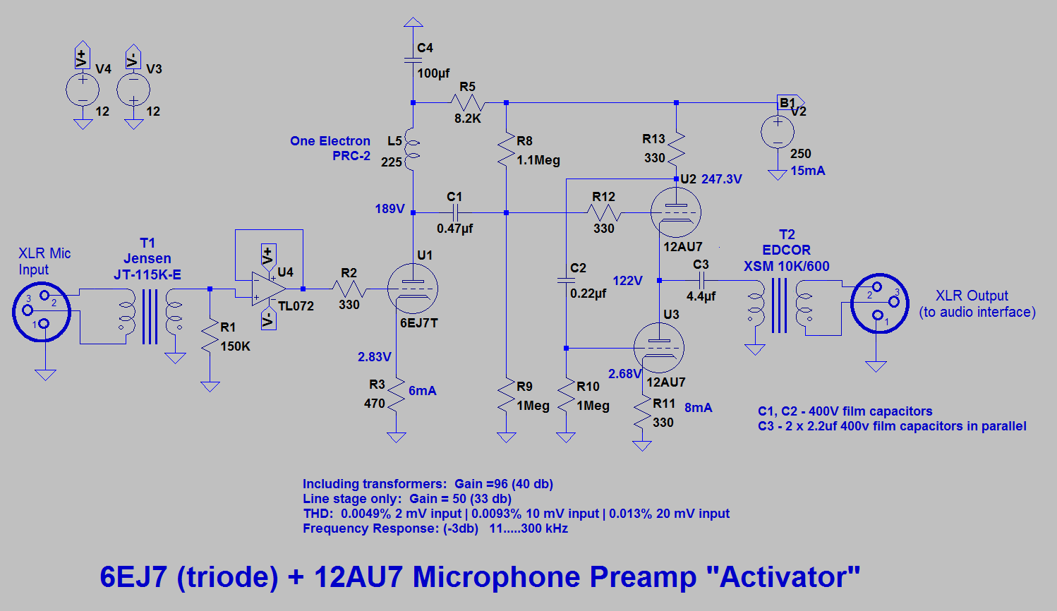

Well, I have also gave some thought again and reimagined my older idea of using triode-strapped 6EJ7/EF184 here. This probably deserves its own thread but will post it here for now.
I recall some old threads on this site about that tube. What an interesting possibility, hi gm, hi mu and low rp. Seems that Miller capacitance (that is on the order of 200 pf) is a problem considering the high mu.
And it is!
One stage choke loaded has plenty enough gain. And the distortion is pretty low with choke load and unbypassed cathode, no need for global NFB. The distortion spectra are nice, triode 2nd harmonic milk and honey and less high-order products. No need to worry about NFB loop stability either.
But if the 1:10 mic transformer is connected directly to the grid of 6EJ7 "triode" and is driven by a 150 ohm source, the -3db rollow due to Miller C is around 36 khz. One could live with that, maybe. The actual impedance of, say SM57 is around 300 ohms and that, reflected, brings the -3db rolloff down into the 19-20 khz. And if the source is 1.5K then its even lower.
But what if we are not afraid of going a little hybrid and just drive the tube with a low Zout unity gain buffer, like an opamp? That will shunt the Miller C and voila! Flat out to 300 khz and beyond. I've used a lowly TL072 because it was an easy cut and paste from another project, but I can come up with a OPA2134 in my box of junk parts easily enough. Maybe there are even newer and better devices out there that approach an ideal unity gain follower. Will need a dead quiet dual polarity +/-12VDC supply though.
This is one way to have the life more complicated.
The SM57 is declared to have -3dB at 15 kHz and the cost of it is around 99$.
The question is:
if I would spent time and money for a complicated circuit ( this only in the virtual world, it is a simulation) or is better to adjust a more simply one.
Considering that the chocke must be a good stuff , so not cheap.
Then, I will amplify the signal then I reduce it in output by 4:1 ratio (12 dB!!!) using a trafo that is not so cheap.
For which reason?
Walter
