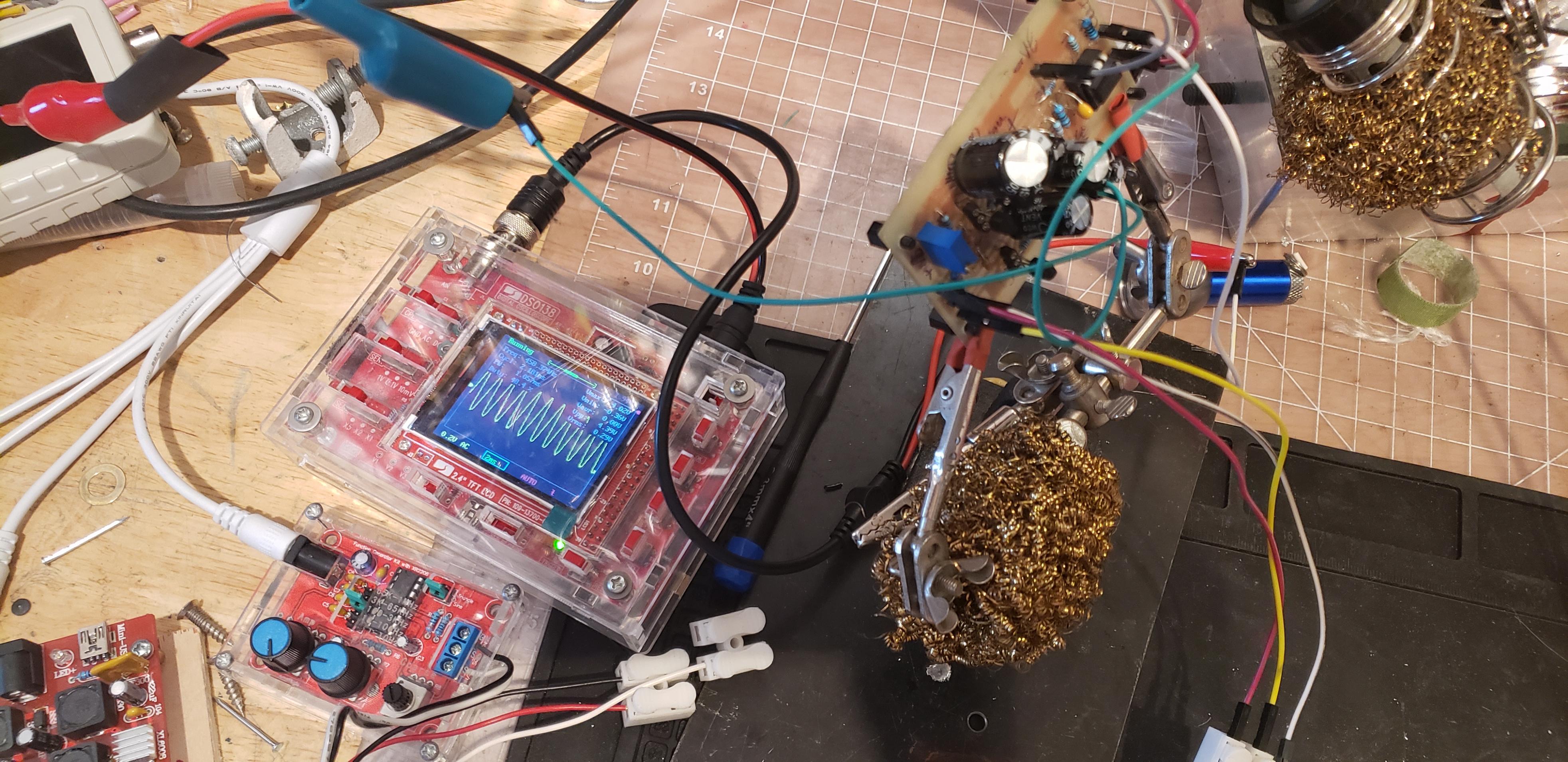

A while ago I built a P66 mic pre from ESP. Copied the schematic directly and did my layout in EasyEDA.
I don't have 2N4403 transistors so I'm using BC549 and BC559, both "C" type gain.
Testing it with a signal generator and a scope reveals that a portion of the negative swing is clipped- visually it's about a third of the negative swing.
Reducing the amplitude of the input signal doesn't help- the signal shrinks, but the portion of the signal that's clipped doesn't change.
altering the gain/attenuation pot on the board also doesn't cure the condition. Changing the frequency of the signal doesn't alter the clipping.
I pulled the transistors and verified they work. Their gains are also quite closely matched
I'm at a dead end. Anyone have any idea what's wrong or some advice?

.....Testing it with a signal generator and a scope reveals that a portion of the negative swing is clipped- visually it's about a third of the negative swing.
Reducing the amplitude of the input signal doesn't help- the signal shrinks, but the portion of the signal that's clipped doesn't change....
This strongly suggests the signal generator has a problem which looks like clipping.
Can you post a waveform?

Check all the DC conditions before doing anything...
The opamp output should be near to zero volts DC.
The voltage on the emitters of the two PNP's will be about +650 millivolts.
The voltage at the junction of the 680/2200 resistors will be about one half of the negative rail value. For eg on -/+ 9v supplies you should see about - 4.5 to -5 volts. For -/+15 volt rails you would see -7 to -8 volts approximately.
of course. seemingly normal operation
now the device works properly. I reinstalled the transistors into sockets and no clipping. I've had this thing built for a looong while now, this is it's first proper operation.
my signal generators have been working fine.my other DSO Oscope (top left of the frame) has some kinda issue, but my older one works fine.
now I just gotta case it, remote locate the pot, decide how I'll power it (perhaps some kinda phantom feed or a seperate PSU.) and maybe put a polarity switch in.Then give it to my father, who's when I talk about my ongoing projects and gear, been saying "you know what would be REALLY cool, is if you built a mic pre!"
I appreciate everyones input, because perhaps indirectly, you all got the device working properly.
