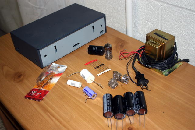

I've rummaged up some parts.
3 9 pin sockets
4 6KT8's
Bogen TM-200
0.47uf film cap
0.047uf film cap
4 100v 2200uf caps
35v 1000uf cap
20vct transformer
rectifier diodes
terminal strips
chassis
I was just playing with Duncan Amps psu tool. A voltage doubler circuit with the 40vct transformer using the 2200uF 100v caps may squeeze about 90vdc out. I'll have to find something for the heaters.

Absolutely. The PT was pulled from a yucky power amp, so I'm guessing it's good for at least 1A at 40v. I just realized that it probably won't fit into the chassis I have sitting there.
I do have an unhappy Realistic MPA-95 (100W mono). It could be a donor for a chassis, XLR sockets, and Power Transformer. I'll check it out tonite.
I'm liking the Realistic as an iron donor. The PS appears to generate about 65vac, which should be good for about 140vdc from a voltage doubler circuit. That should be fairly optimal for the tubes involved. I'll just need to use higher voltage rated caps on the smoothing end of things.
