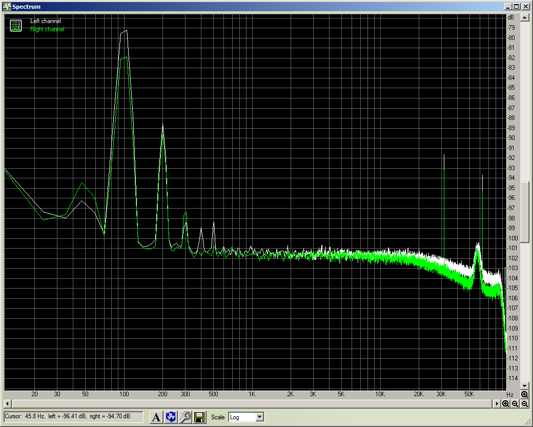

I've posted this in my measurements thread, but thought I'd post it here as well 🙂
comparison between the 100Hz ripple (and harmonics) on the output of the reg with 1000uf 3r3 1000uF 3r3 1000uF pre reg, and a single 1000uF cap pre reg.
Measurement taken with 10X gain before being fed into and recorded on the pc's sound card using audacity.
Tony.
Tony.
Tony, which curve is which? And dB relative to what? By "pre reg," do you mean you put the caps ahead of the regulator?
Hi Sy, I would have thought which was which was obvious 😉 Left is with the CRCRC
by pre reg I mean the filter caps after the rectifier.
The recoding is any non-dc component residual on the power rails . For a relative to what, have a look at the following graph. It is a comparison of the output of the reg, compared to the preamp feeding the sound card with the probe shorted (left channel is the basic noise floor of the sound card + external 10X preamp ) and right is the measurement of noise on the output of the reg. Note that this one probably had 1000uF 3r3 4700uF 3r3 4700uF

OK, prefiltering dropped the hum for sure. Now, what happens if you move one of those 1000uF caps to the adjust pin?
I will give it a try, but if you care to come over to my other thread I think you will see that with my circuit (implementation of Fred Dieckmann's suggestion) it won't make a hell of a lot of difference (I could be wrong). I'll also get out the scope set up the sound card to deliver a 10mv p2p sine wave and measure that on the 10X setting on the preamp so we have an absolute reference too 🙂 that has been bugging me a bit I don't know for sure that the sound card is running with no gain.
I can also change back to standard config of the reg, in which case I expect the big cap on the adj pin should make more of a difference.
But seriously I don't want to start hijacking another thread, we should discuss over in my LM317 experiments and measurements thread 🙂

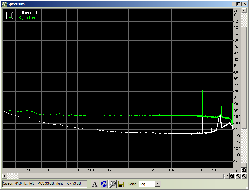

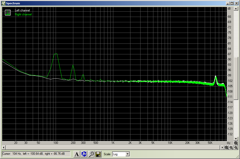

OK well it looks like I'm only going to get one measurement done tonight (the easiest one) so I'll post it now.
This is with the dieckmann mod (as I didn't have to reconfigure to do the measurement) and as I expected the bigger cap doesn't make a whole lot of difference. It does improve things, especially on the third fourth and fifth harmonics, but overall, at least with this circuit the CRCRC is much better value.
So what do we have:
1st pic single 1000uF elna silmic II as the filter capacitor.
left channel 4.7uF polyester bypass cap
right channel 1000uF elna silmic II bypass cap.
2nd pic shows the difference between a 1000uF cap (left) and 10,000uF cap (right) as the filter cap. adj pin was 4.7uF So brute force on the single filter cap does make a difference 🙂
Tony.
