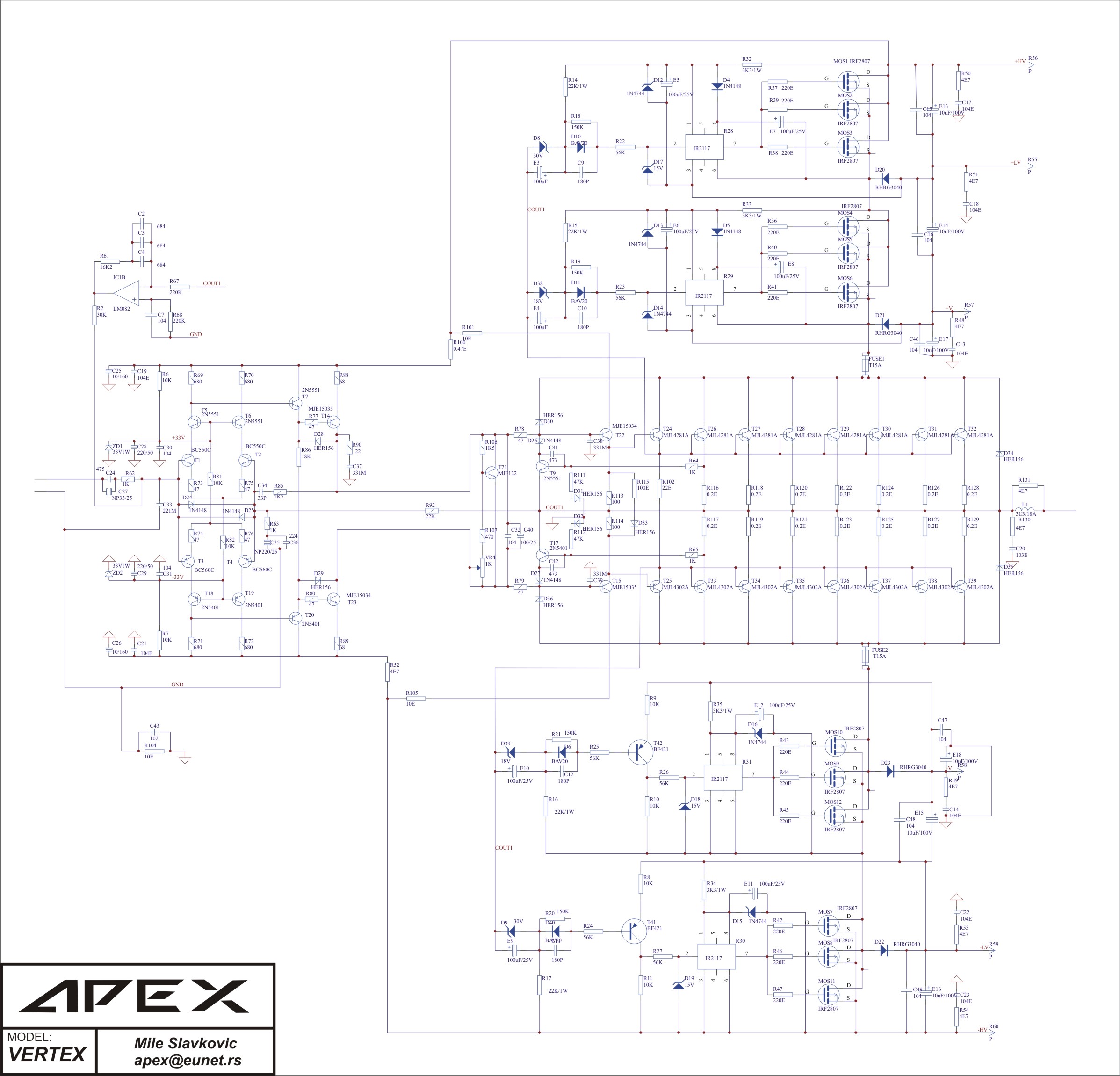

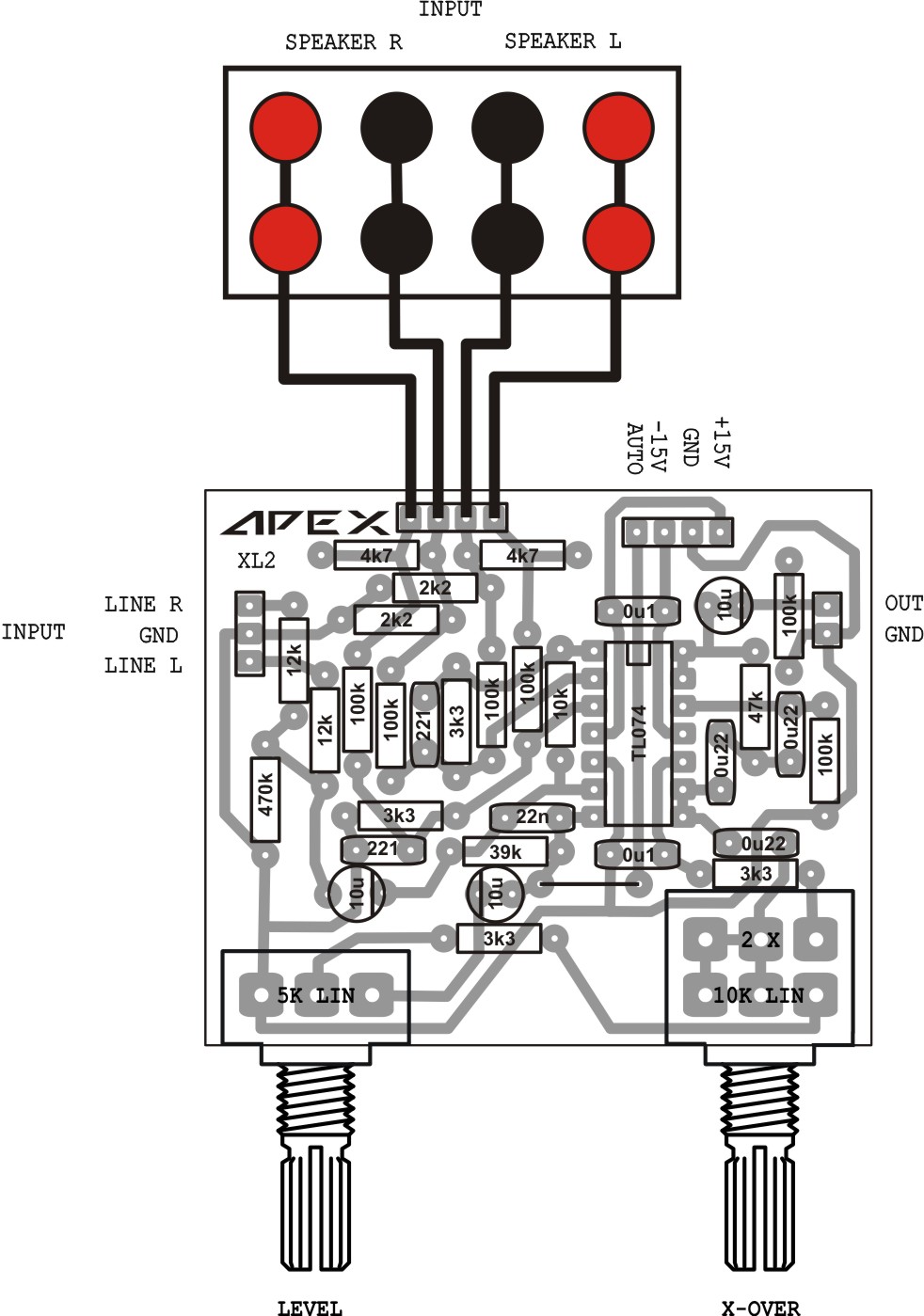

apex,
what are frequencies of the two x-over?
from pot zero to ten range,
can this go cover 150hz
sorry for vertex wrong posting

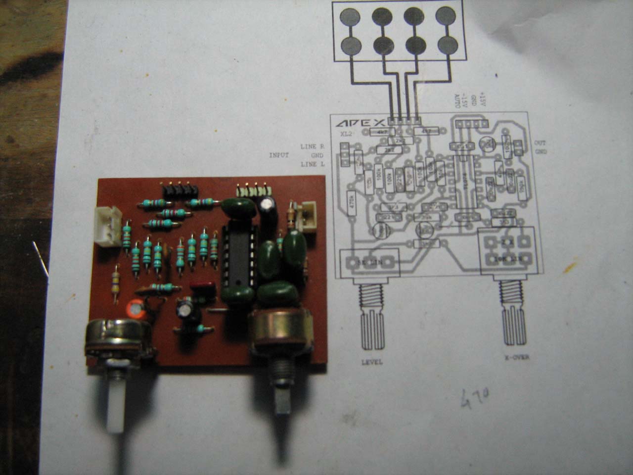

Making X-over

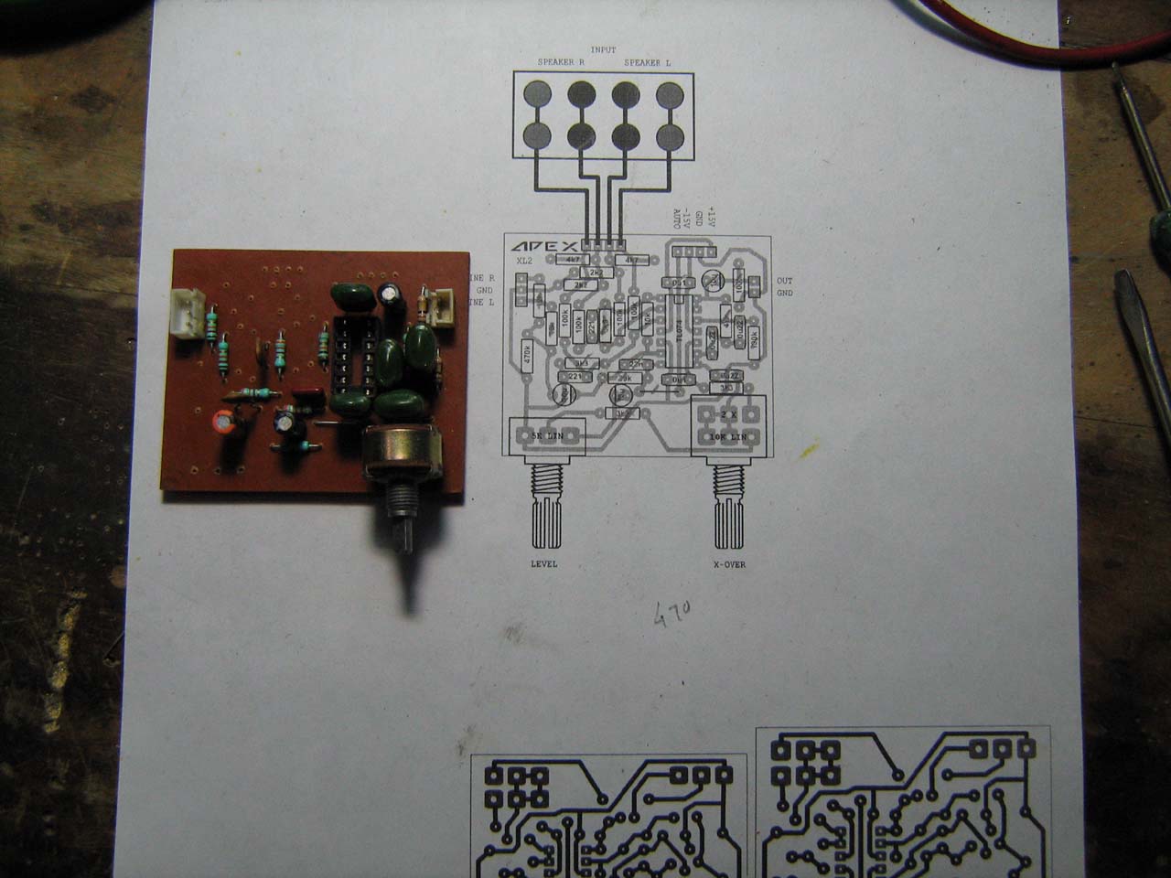

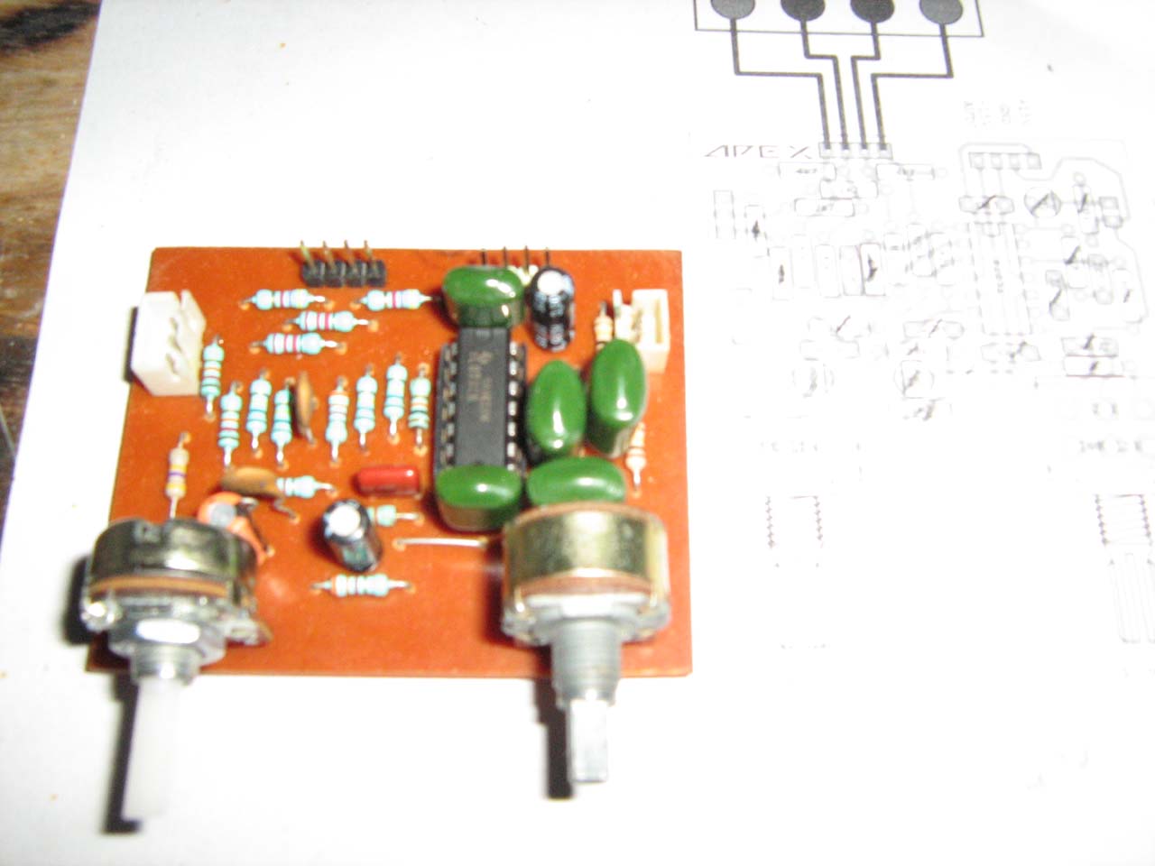

I am building X-over by "Apexaudio". Work in progress waiting for few components.
Ones complited will test this with my Subwoofer and then will share my experince about this.
I hope there will be no problem if i leave the "Auto" pin Not connected with any type of auto-start circuit.

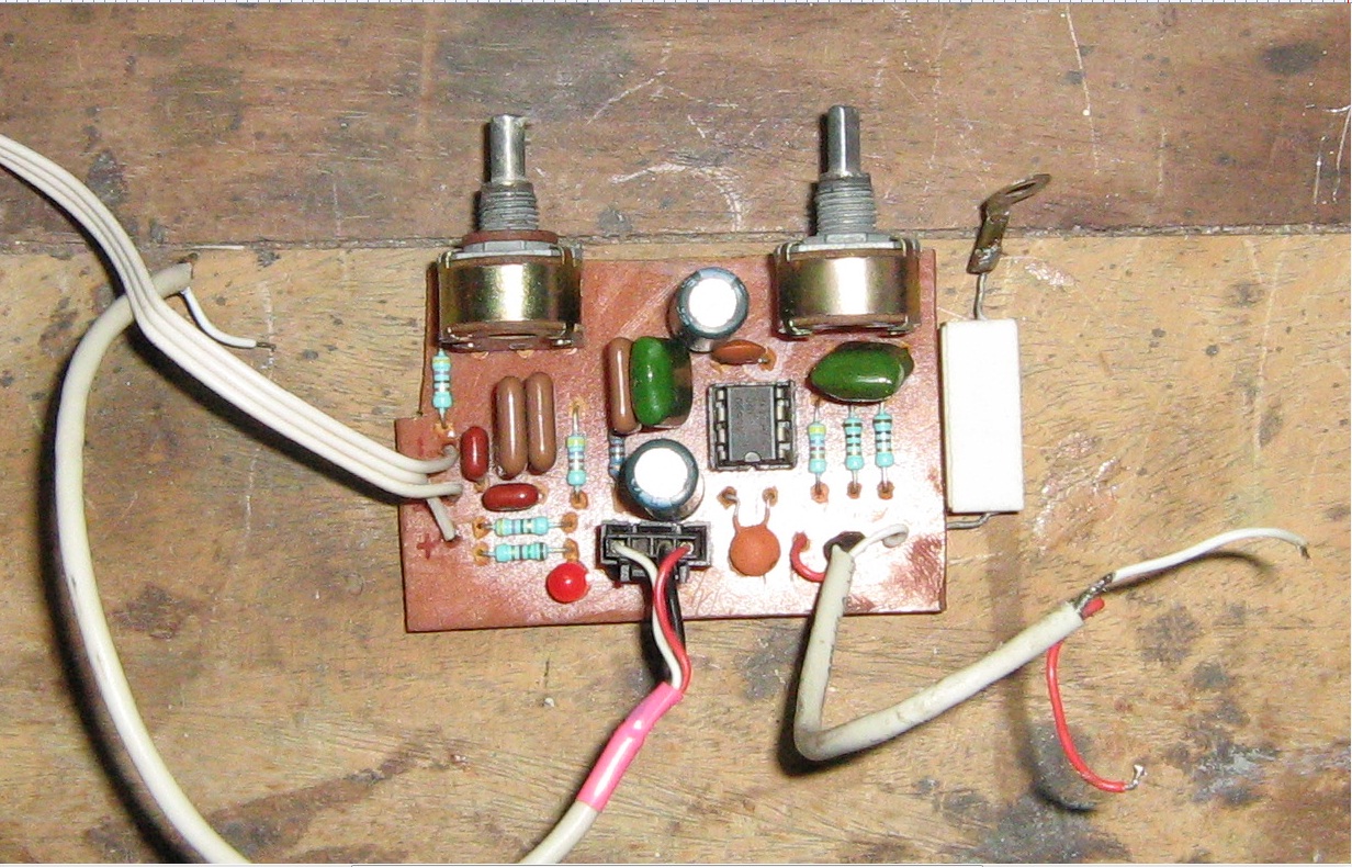

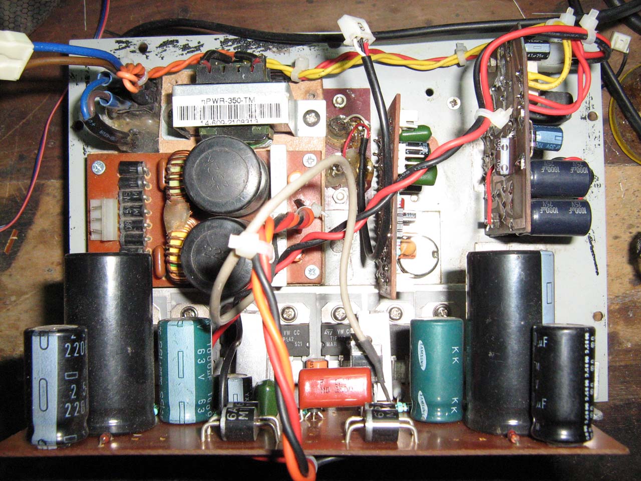

Apex Sir.
This Sunday I tested your crossover circuit with my subwoofer.
SUB = Sealed 15” x 15” x 18” box with cheap 12” car sub-drive and 400W power amp.
I have tried many sub pre-amps circuits till date, but sorry to say sir didn’t found your circuit as good in bass as the following circuit.
Above subwoofer + this low pass circuit + input from PC (Asus Xoner DX) sound card.
Make’s every window of my room vibrates like hell.
Apex sir please have a look on this circuit and share your opinion and also I would like forum members to try this circuit and give their experience about it. This is a very few parts Low pass circuit and it’s very good too.

This simple x-over work in range 20-100Hz, if you need this low pass instead 80-250Hz you can just use pot 2x50k instead 2x10k and sound will be same.
Regards
