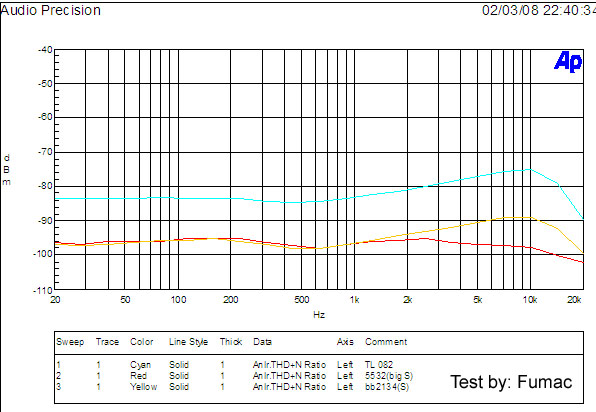

good etoastw, show you a pic of the preamp on board
we are doing research at preamp,
found that the thd of ne5532 is better than the op2134,
just because i cant find the new ne5532 here,
so i cant replace the op2134 with ne5532,
(i cant use 2nd hand components at mcd modules)
you can try to do it , ne5532 is cheap
we will do other researching of preamp.
happy Chinese new year
rg
this picture is +/-15v reg, 1k load, 6v rms output. 3x gain.
Eva said:TL082 is not designed to drive 1Kohm at 6V rms. Recommended load for this op-amp would be 5Kohm or higher.
yes eva,
we just do the hard loading test of the opamp.
6vrms to 1k
this will let us know : tl082 is not good at this.
at the first test, we use a 600ohm loading, and the tl082 cant run so we change to 1k,
rg

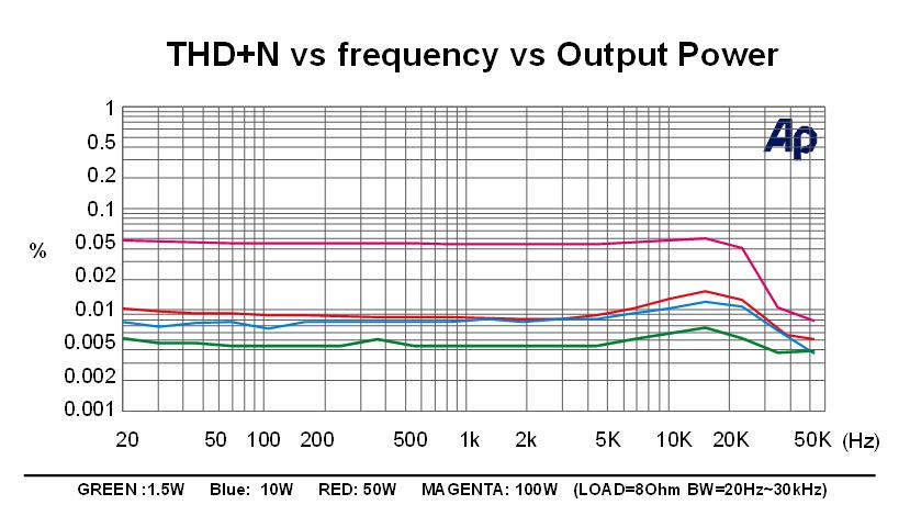

hi Kittikun
perhaps you can try our mcd-400
mcd-400 will be ready
here is the thd of mcd-400 by ap system
kittikun said:Hi Fumac,
How soon will your mcd-400 be ready?
Is there any sound characteristics different from mcd-255?
Kittikun
hi kittikun
1. more output power : 420w at 1%(thd)
2. separate preamp and power amp.(you can take out the sub board of preamp.)
3, the power supply will be better(-10db noise lower).
4.less thd (pls ready the picture, test BW=30k)
because we got a set of ap system, so we can make it better .
