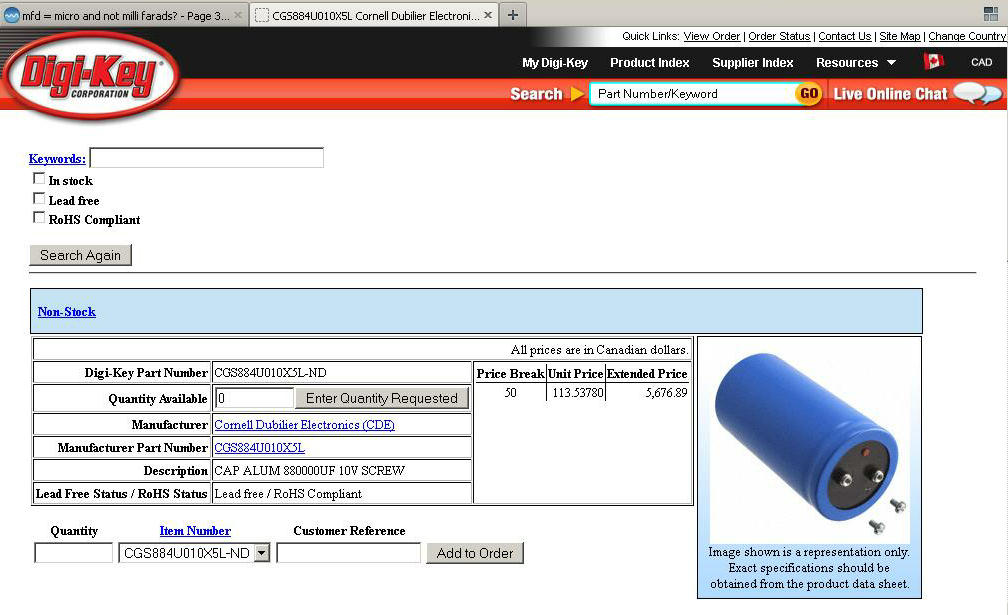

Apparently a rule that is not often applied, and not used by DigiKey.
That cap is measured in UF; what multiplier is 'U'? I know 'u' is used for micro because inserting Greek text is so messy, but 'U'?

All those zeros and a capitalised U make it difficult to read.
Now where are my spex and maybe I will see if DigiKey meant 88mF or 880mF
Difficult indeed, there should be a space between the number and the units (no space is a pet peeve of mine, though I am probably guilty sometimes too). I presume that Digi-key avoids using "mF" for a good reason... the same reason that this discussion exists, and that so many different opinions are being expressed here.
