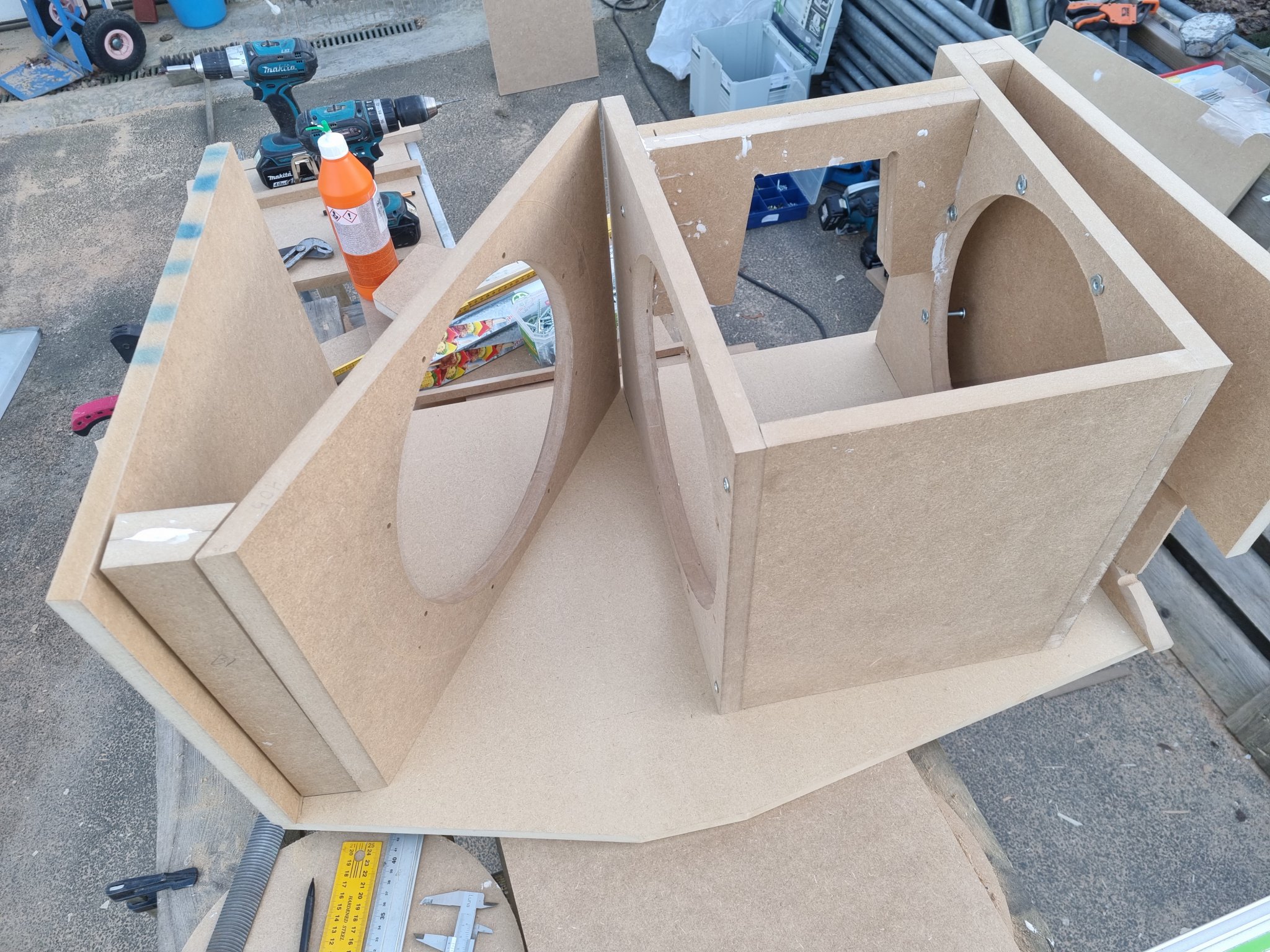

Since it is a Dipole project and i have no need to do frequency extension (fs in free air is 20 Hz and i will only use the dipole between 27Hz-120Hz) my only goal is to reduce distortion. And in Dipoles there is a lot of excursion=distortion at low frequencies.
This is why i want to optimize the feedback circuit (working point of J310 and the current mirror) to achieve as low distortion as possible.
Next thing is to keep the bandwidth of the servo loop high enough to reduce the harmonics up to.. lets say 9th. -> 9*120 Hz is 1080Hz and that gives a C12 of 15nF and C16/R28 tuned to 1kHz as well.
My Dayton IB woofers has a nasty breakup at 1100kHz but this frequency will not be played, I use 24dB filter at 120Hz = attenuation of >72dB at 1100Hz.
Any thoughts or comments?

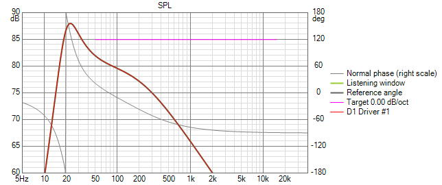

Maybe I am mistaken, but there is something strange in the measurement: from 20Hz to 10Hz it looks as if the slope is about 24db/Octave, yet the phase between 20 and 13 Hz only gradually rises. With a 4e order roll off, phase should reach + 180 degrees much sooner.
I made a very quick n dirty sim of your curve, that shows phase should rise much quicker to +180 degrees than in your picture. Its this the result of 2 channel measurement?

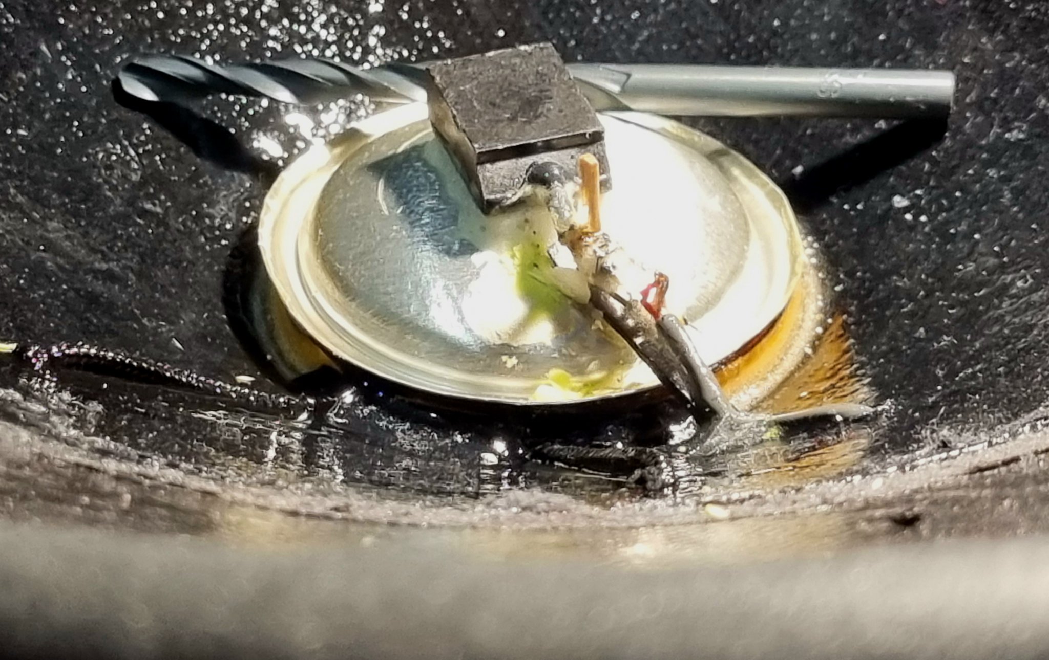

What you need in the first place is a measurement of the sensor output in your target application, i.e. in your dipoles. Ideally the sensor output should fully track the acoustic output between 5 and 500 Hz. Above that NF measurements are no longer valid with larger drivers.

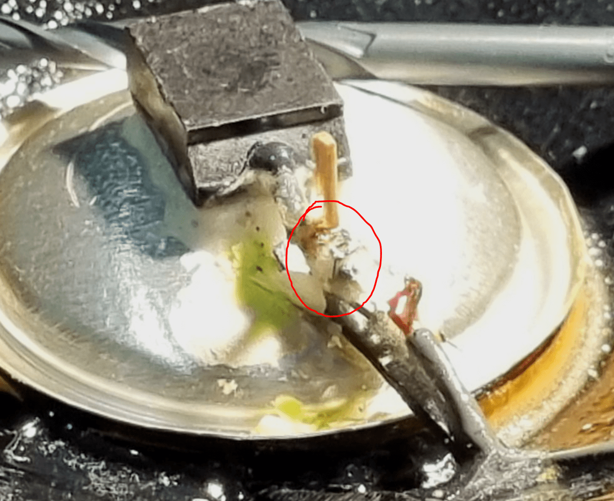

The first stumbling stone is to obtain perfect tracking: the sensors are extremely sensitive to proper mounting, voicecoil vibrations and cone-breakups, that do not always show up in mic measurements. This is precisely where I am stuck myself at the moment, not having time to proceed for the next 3 months or so.
52 mm voicecoil, a 5mm drill as a visual size reference. The dome of aluminium is a soda can bottom. Maybe i should stiff the dome upp by maskingevär a sandwich of two domes With 2mm polyurethane foam in between...

I have trouble getting enough signal from the accelerometer. So for trouble shooting i cranked up volume to max at 20 Hz and get 85mV RMS or 250mV pk-pk over R12. or 250uA pk-pk. That should give us 250*820 =205mV pk-pk over R3 (I can not reach that resistor or J310 FET since they are glued on the cone, see the red circle)
In post 9 you see that the ACH_01 is feeding J310, and the current mirror drives the signal over R12.
The sensitivity of ACH-01 is 9mV/G, i should have a lot lot more signal than this. Don´t you agree?
In theory, If we calculate that we reach x-max (14mm) of the woofer at 20 Hz, that is 22G.
a=W^2 * A -> a = (2*3.14*20)^2 * 0.014 and multiplied with 9mV/G and 196mV pk-pk over R3 (max acceleration) from ACH-01...
My feeling is that theory and measurement is quite close...
So i need to crank up the feedback a little bit more.
10dB or 8 times the voltage.
Please if you find error in my calculation just correct me. Thanks!

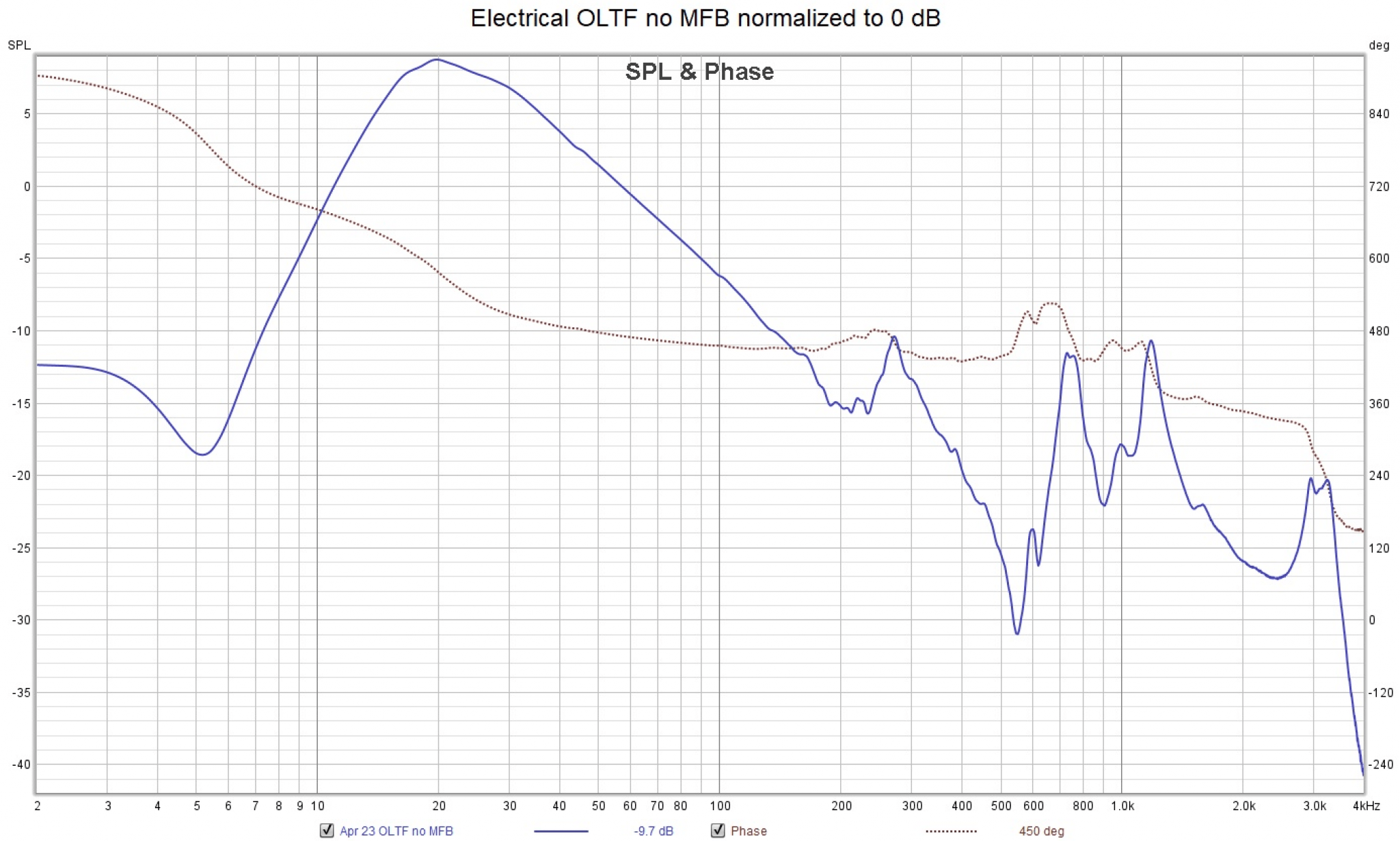

Here is the Open Loop Transfer Function OLTF measured electrically.
https://www.diyaudio.com/community/...s-using-piratelogic-electronics.336070/page-8
Post 147 from Bolserst show how it is working.
0 dB crossing shows that the feedback is quite limited (up to 60Hz, and maximum 9dB at 20Hz)
As you can see I need to crank the feedback up around 10dB extra.
Comments?
I also need to flatten the feedback loop by adding a RC link over R25 ( 47nF 27kOhm ) to flatten the curve. The question is will this increase or decrease my HF Phase margin? Help needed..

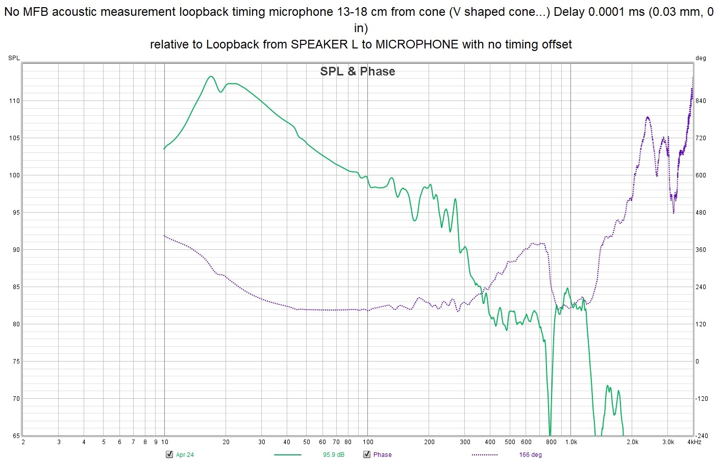

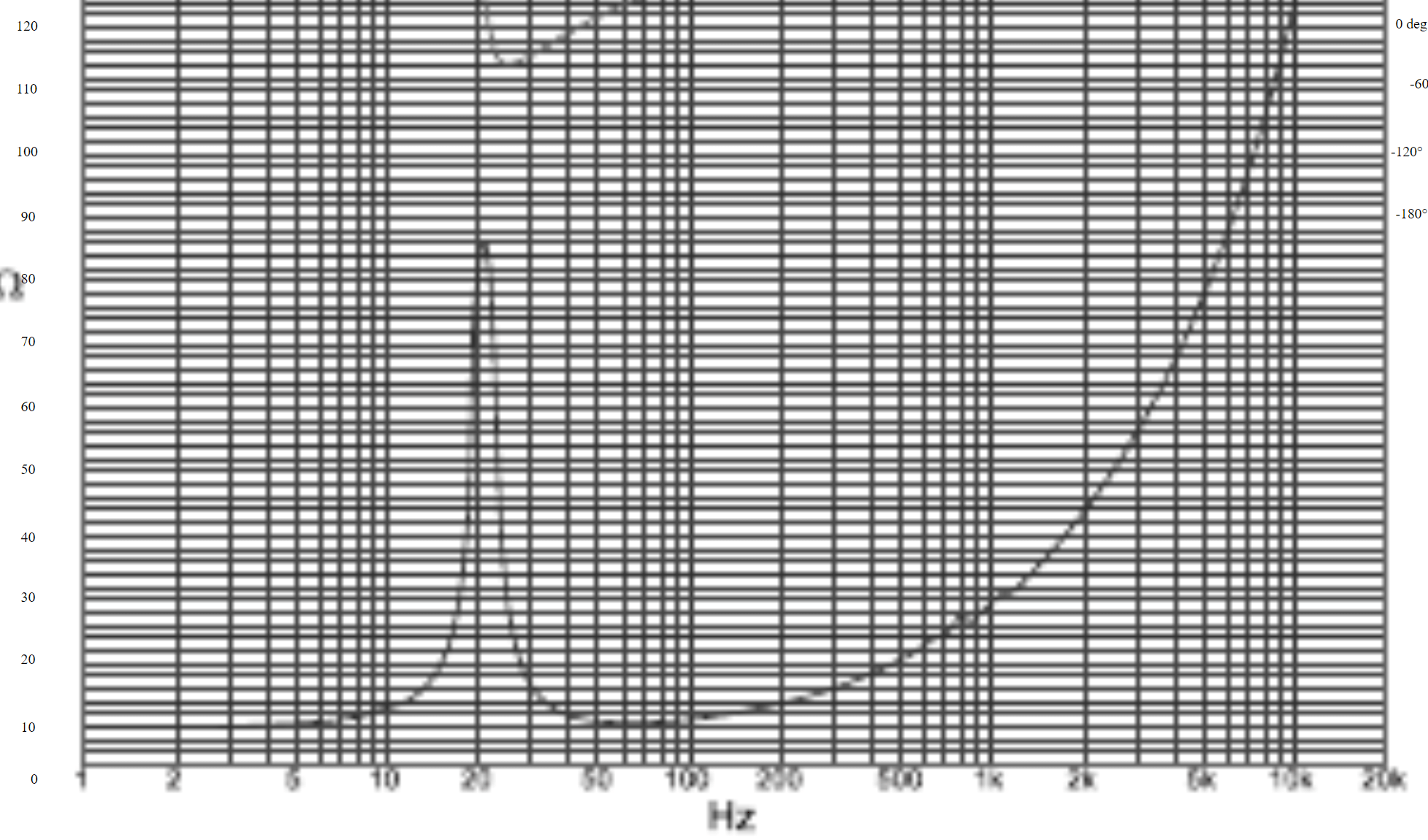

The strange frequency response is explained by my current feedback amplifier CFB, or mixed mode in reality (see the end of this post) . Which means that the frequency response without MFB will mimic the impedance curve! First the Impedance curve of the woofer:
And this is the acoustic frequency response without MFB, measured 15cm from the woofer (mounted in a H baffle, so some acoustic extra loading)
Do not trust the Phase since the timing is done in a loopback with almost zero delay, and microphone is approx 15 cm from cone.

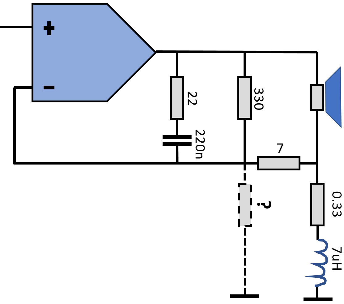

The CFB amplifier mixed mode principle:
I added 7uH in series with the current sensing resistor for increased stability of the amplifier, since the inductance of the driver increases the gain a lot at higher frequencies it was really needed.
There is a question mark on a non existing resistor, if I decide to reduce the huge gain I have around 20 Hz I will put 33 Ohms here and work my way down in resistance. Thanks for feedback! Not only MFB or CFB but also diyAFB
