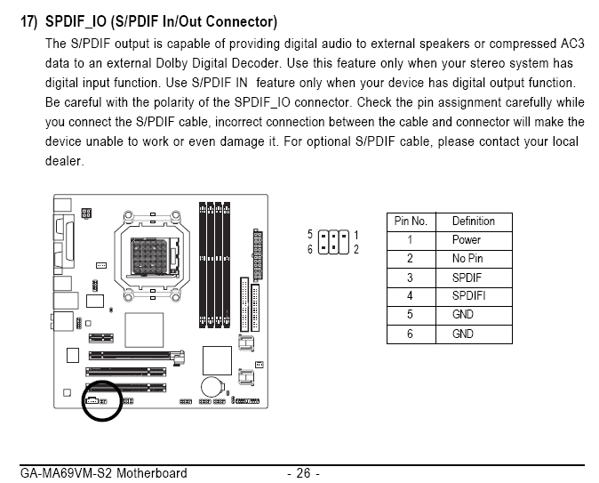

I want to use the standalone Dac converter XDAC V3 from musical fidelity whith my pc. the problem is that the soundcard embedded on the motherboard has an spdif output, but it is not connected to an external coax rca output.
From the instruction manual of the motherboard (see photo enclosed) I suppose that a coax output can be connected using pin 5 to ground and pin 3 (labeled spdif) connected to the center wire of the coax cable, it is correct?
and, this way, the output inpedance are the 75 Ohms that the XDAC likes?
thanks on advance.

karellen said:Hi!
I need some advice
Yes, that would seem to be the correct way to connect the output to your DAC.
Assuming that the motherboard manfacturer adheres to S/PDIF standards, yes. I don't think that the optional bracket with the RCA connector(s) will have anything else than wiring and connectors.
Note that the AC3 audiostream from DVDs through the S/PDIF output will only work on suitable (Dolby Digital) decoders. Most likely the audiostream on S/PDIF will be 2ch (stereo) @ 48 kHz as default, so that should not be a problem.
