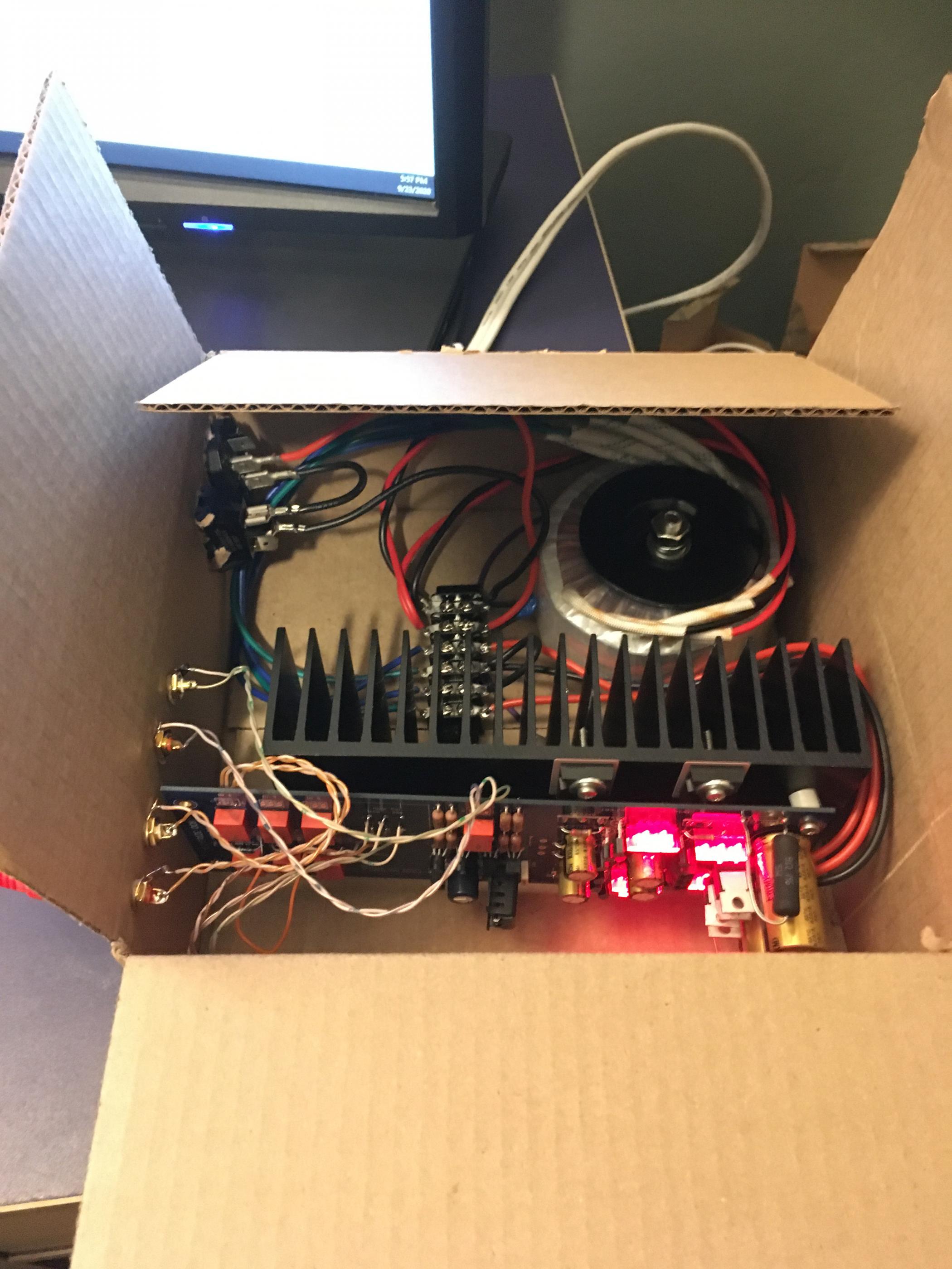

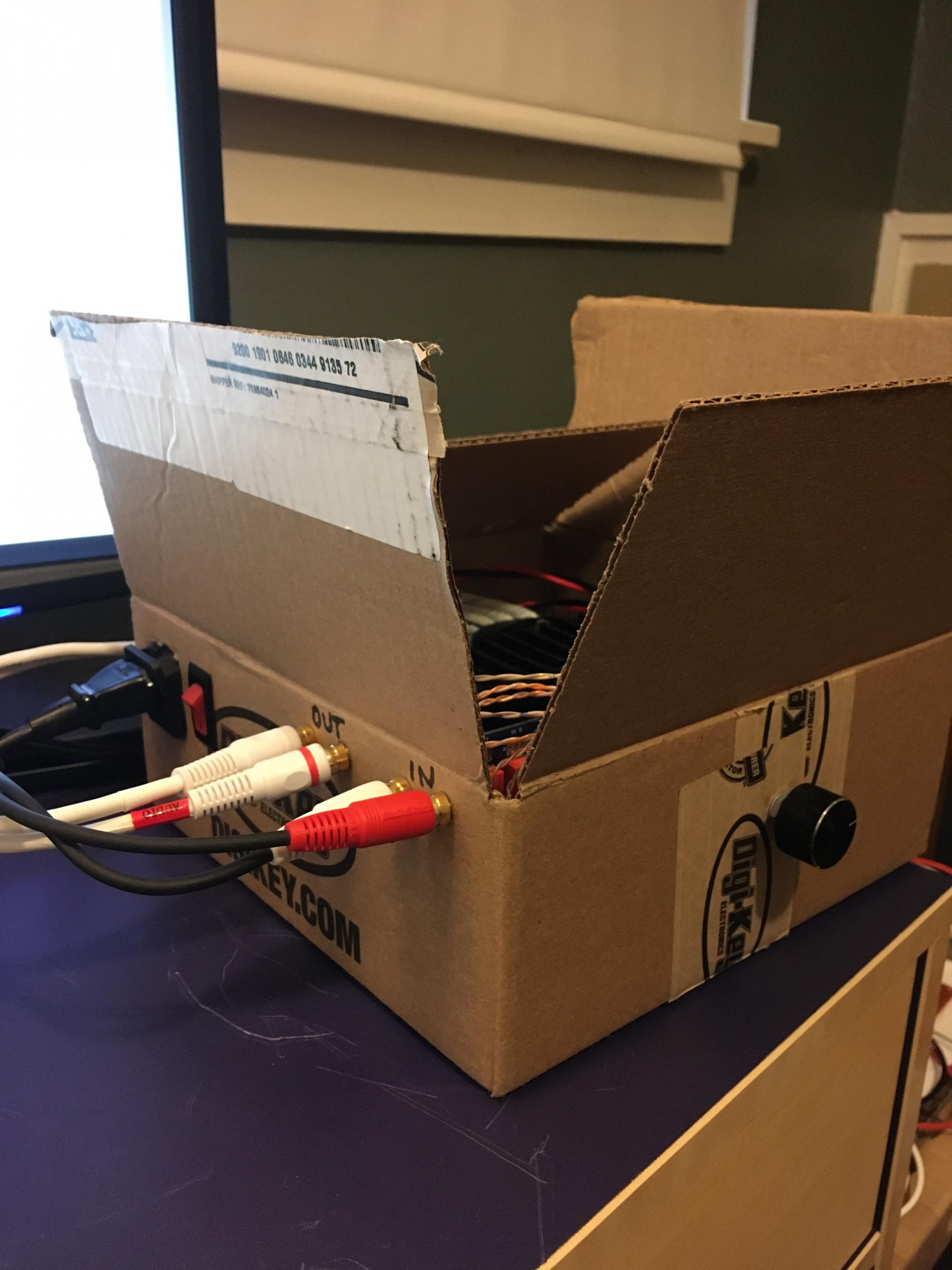

Well my LSK170bs from NAC got here today so I finished the preliminary build. Currently using the onboard rectifiers since I am still waiting on the VSPS pre to come. Thought you might want to see my "trashy" temporary chassis. I'm a little sketched out but its better than nothing.
Those heatsinks make good hand warmers!

You want to send that photo to DigiKey.
Also FYI: "Your item was delivered at the front door or porch at 12:30 pm on September 17, 2020 in BELLINGHAM, WA 98225." (So I guess that's not the box for the LSKs.)

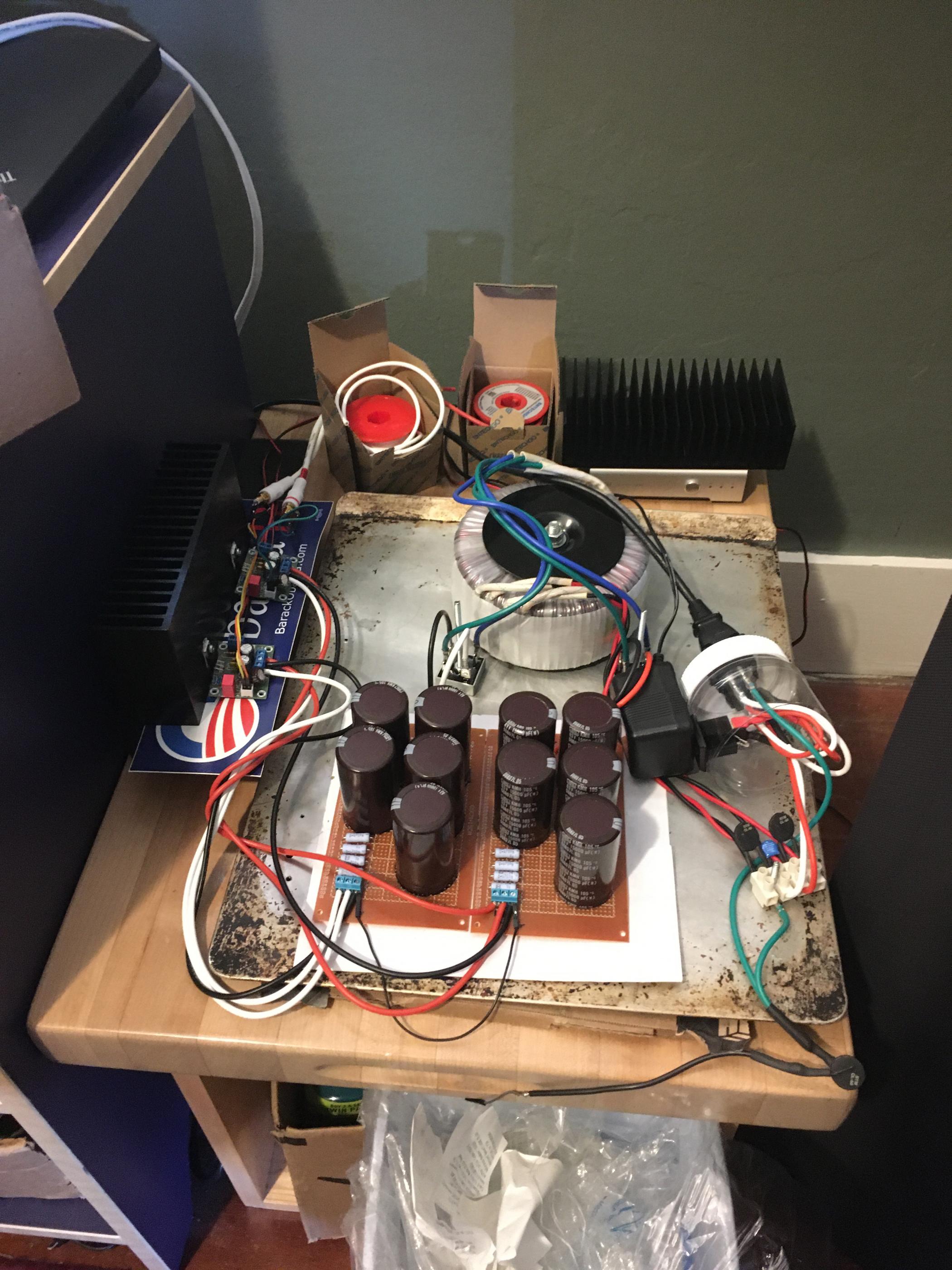

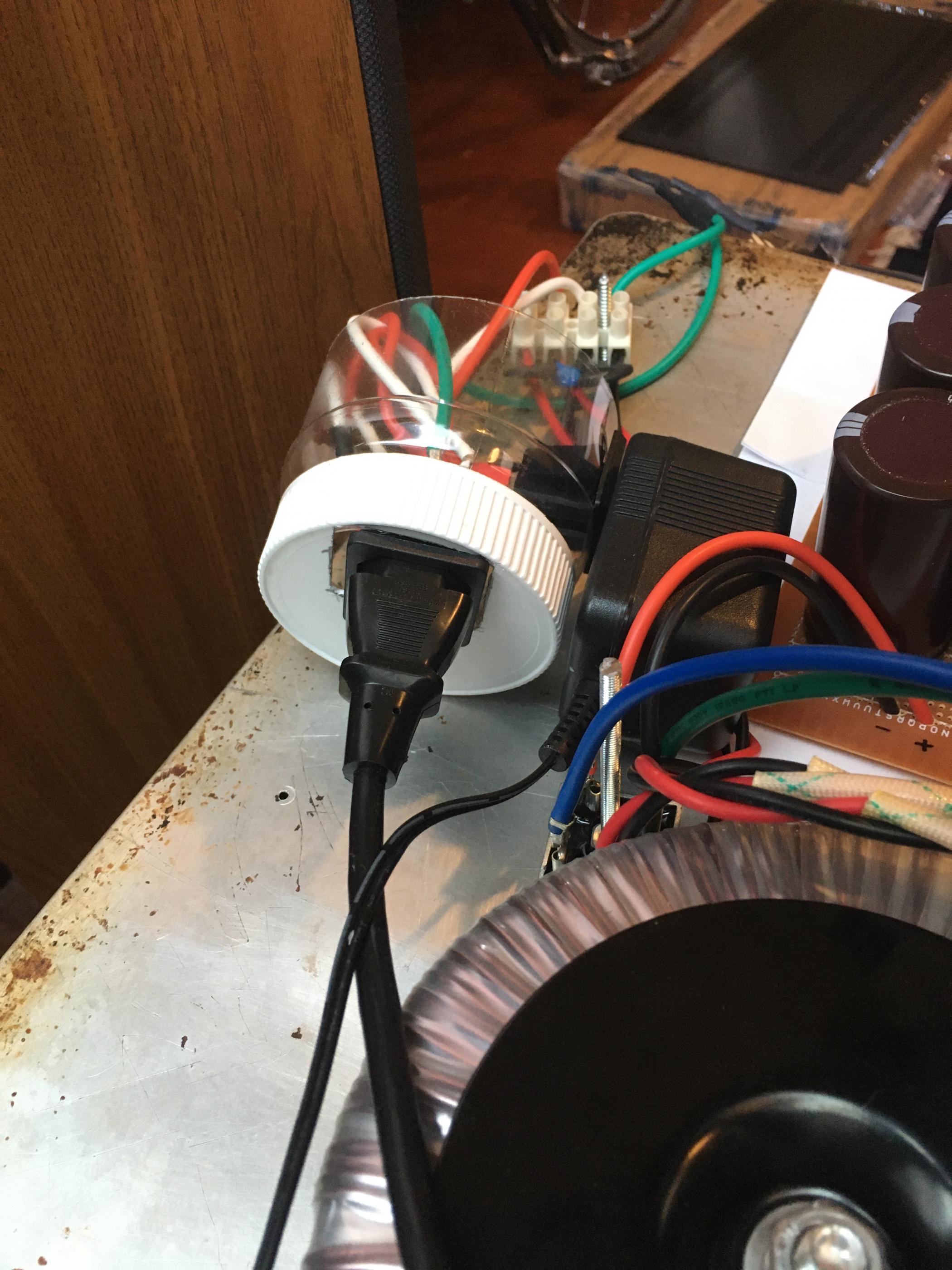

Yeah that chassis is for my cookie monster. The lm1875 amp built on an old cookie sheet and using a peanut butter jar to hold the power sockets. It will be an F5 once the pcbs are back in stock in the store.
