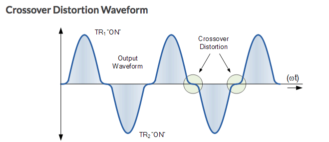

The HD1 has an interesting feature:
"Two‑channel complementary MOSFET output stages and operates at class A at low to moderate levels (less than 90 dB SPL) and class AB at high levels."
If that transition was not working properly, could be responsible for what you are hearing, which may be what is known as "Crossover Distortion", a zero voltage “flat spot” or “deadband” on the output wave shape as it crosses over from one half of the waveform to the other. Those flat spots definitely would sound harsh, adding nasty harmonics.
REW also has an oscilloscope function, if you were to test the HF amplifier output you could see if a sine wave looks clean or distorted through the level change range where you hear the non linear behavior occur.

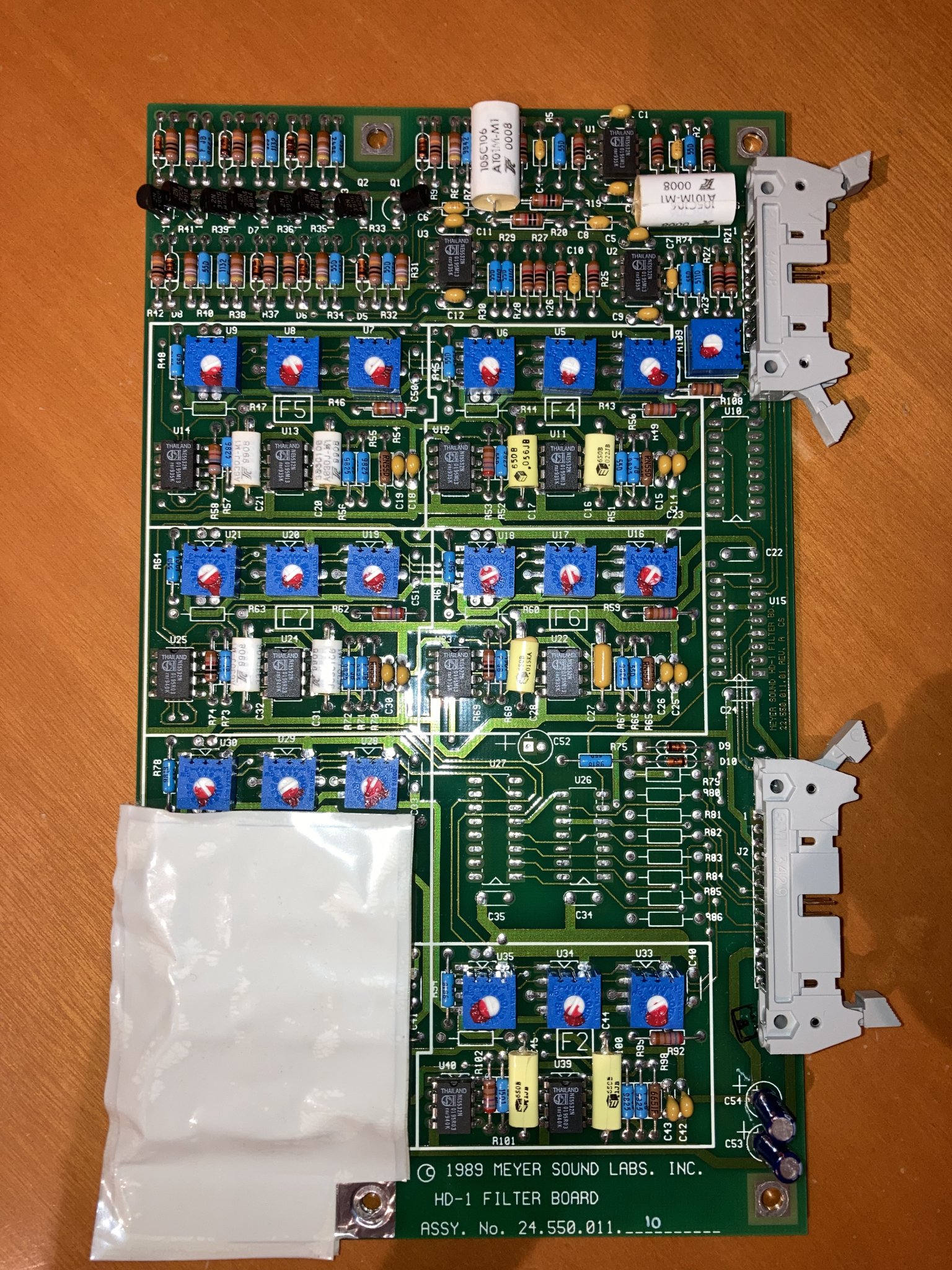

Art, I believe that the internal EQ section has something like seven band parametric control, while the delay card is about the same complexity.Giorgio,

Probably a common replacement from CIARE could be adapted, thanks to the many calibration points, but the problem is which trimpot to move for a particular frequency and what sequence?
Without a technical manual, it could be very hard to find the correct calibration process.

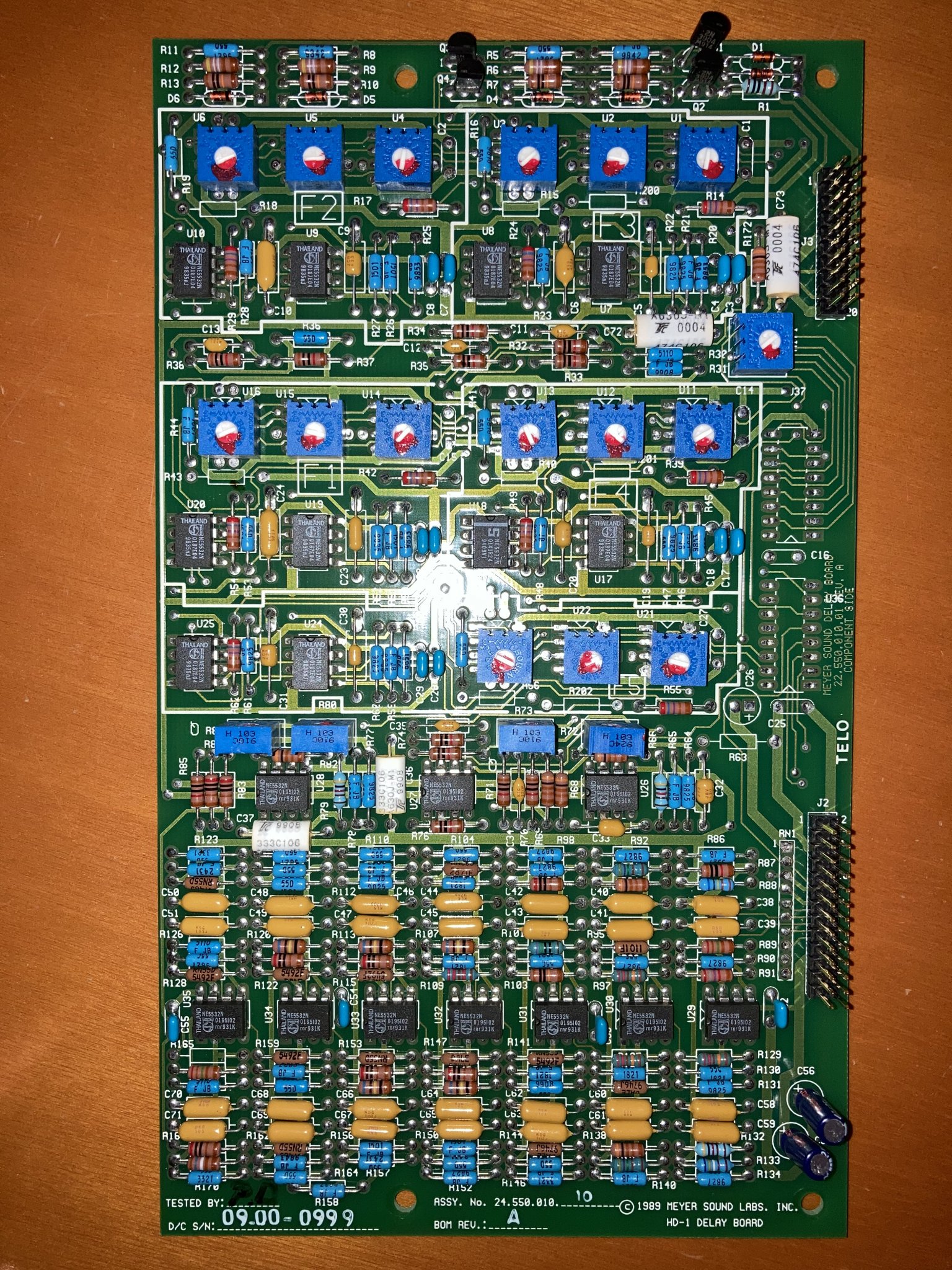

I’ve attached two pictures of the EQ and delay cards.
Giorgio
Obvious first check is to rule out electrical circuit anomalies, new tweeters would still sound bad if crossover waveform distortion is the problem.Art, I believe that the internal EQ section has something like seven band parametric control, while the delay card is about the same complexity.
If the response is actually calibrated for each driver used, the tuning process would require a specific measurement test jig to match a target acoustic response.
You could use your friend's freshly calibrated pair as a target response.
You could measure your amplifier(s) output electrical transfer function, record frequency response as set, then determine what the trim pots do by trial and error, likely frequency, amplitude and bandwidth for each band.
Charles, you might like to know that more NE5532 are used on the power amp card and one more on the input card.It is at least interesting to see that very high qiality active crossovers can be built using NE5532.
Regards
Charles

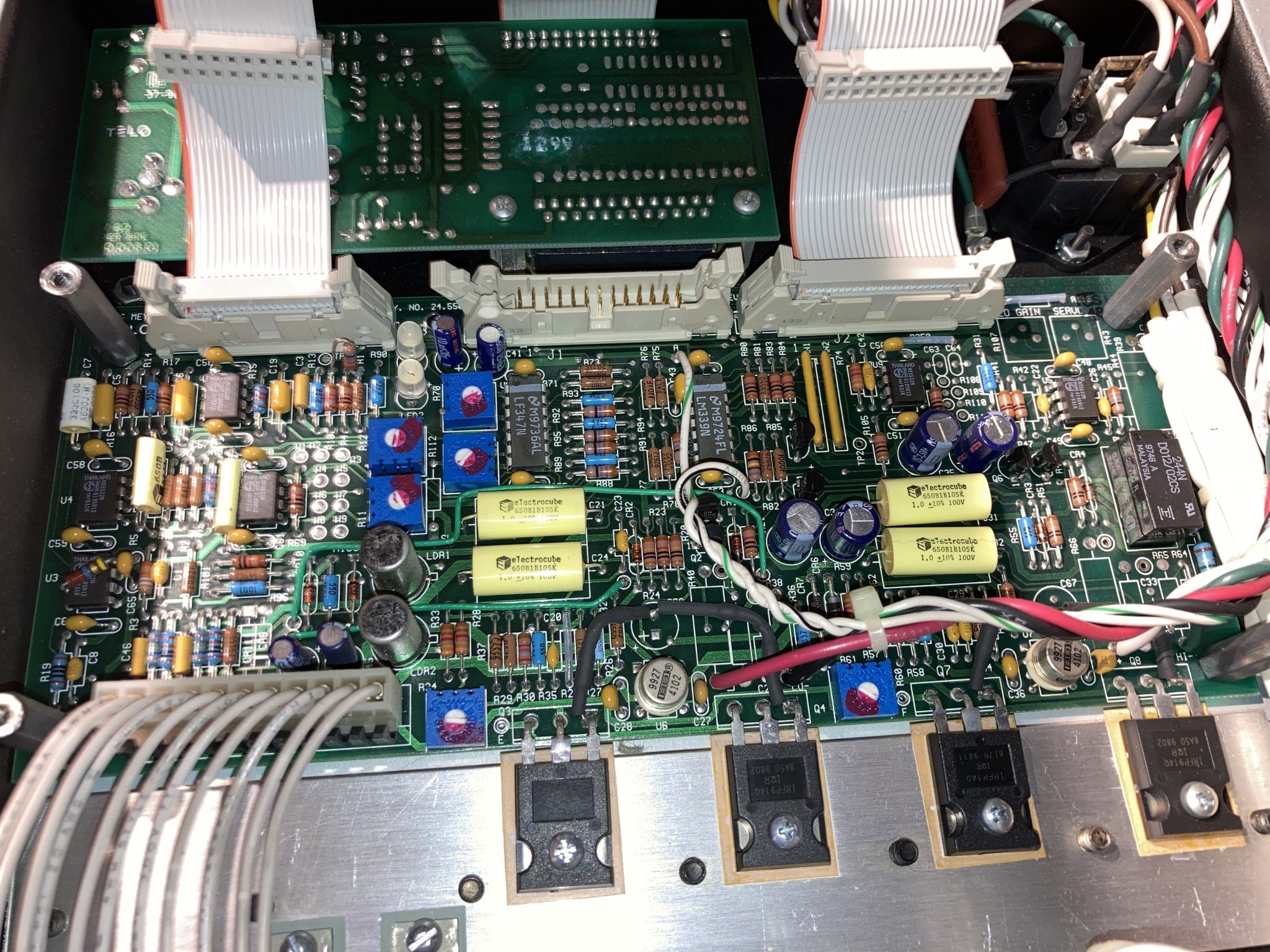

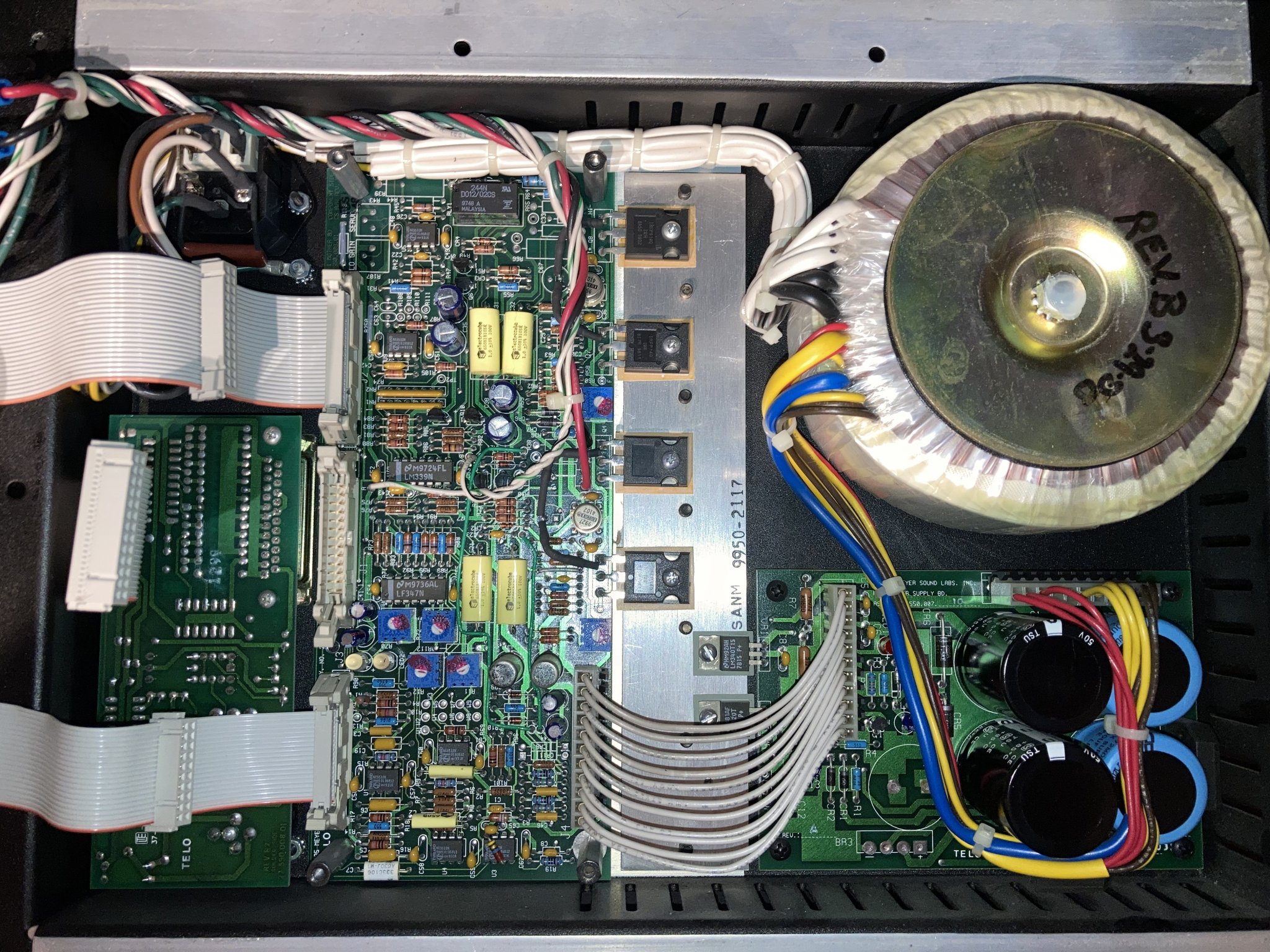

Those are hexfet outputs. Not the most thernally stable or linear power fet for audio duties, but with enough finesse and external safeguarding, it can be made reliable enough for pro audio duties. Lateral fets are better for this purpose, but i guess that's what they speced for their stuff.Charles, you might like to know that more NE5532 are used on the power amp card and one more on the input card.
Nothing wrong with NE5532s if they're implemented correctly. Those are older, original philips/nxp 5532s, which i prefer over generics.
Never been fond of Meyer stuff, although I do admire the old school approach. The ferrofluid they used back then wasn't very stable and often splashed or migrated out of the driver gap from hard use. Modern stuff uses Ester based FF as opposed to petroleum base, so you have to verify VC winding and adhesive compatibility before switching it out.

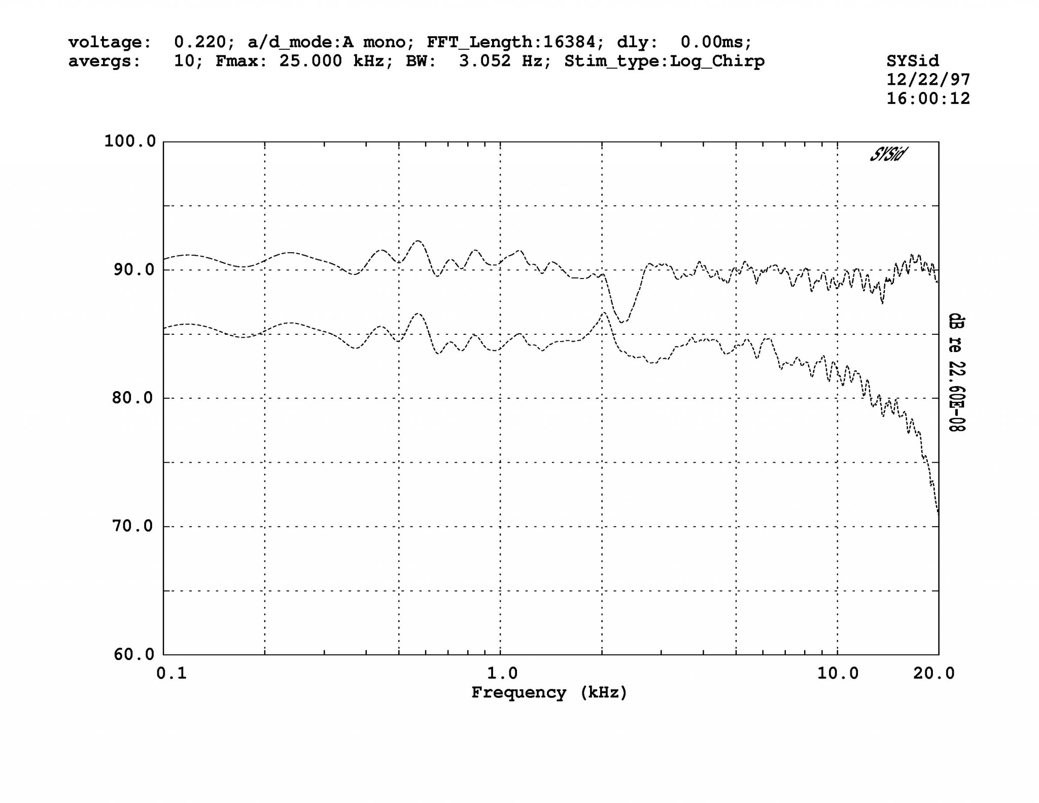

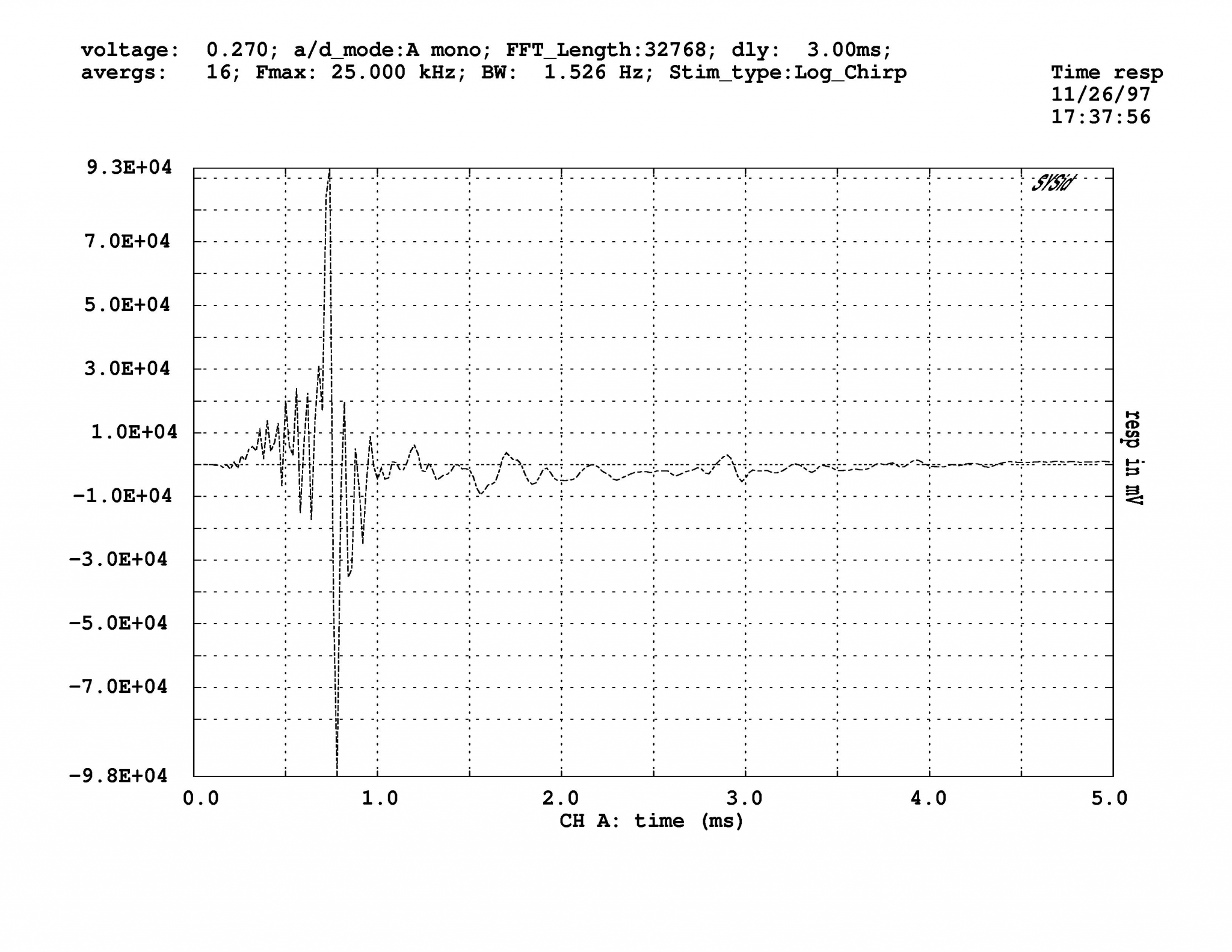

It took me forever to dig up these measurements that I took of an HD-1 in 1997. The first one is of the system on axis at 1M. The second curve is taken 30 degrees off a lateral axis, but displaced downwards 5dB. The second measurement in the impulse response from the on axis measurement. The system was on a 6' high stand, measured outdoors.
Thanks for posting your measurements Jack.It took me forever to dig up these measurements that I took of an HD-1 in 1997. The first one is of the system on axis at 1M. The second curve is taken 30 degrees off a lateral axis, but displaced downwards 5dB. The second measurement in the impulse response from the on axis measurement. The system was on a 6' high stand, measured outdoors.
The impulse response looks reasonably good for a so old design.
Giorgio
Thanks for the hint about FF.Those are hexfet outputs. Not the most thernally stable or linear power fet for audio duties, but with enough finesse and external safeguarding, it can be made reliable enough for pro audio duties. Lateral fets are better for this purpose, but i guess that's what they speced for their stuff.
