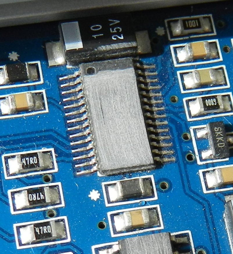

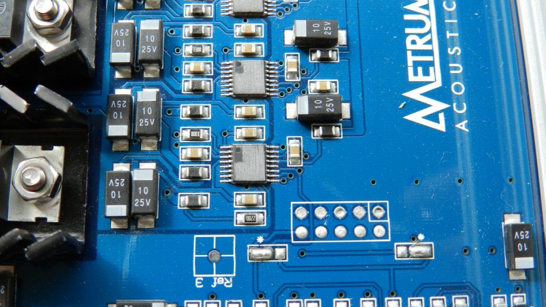

This thread has gone waaaaaay off topic, so with this picture I'd like to go back to the original question. The answer can still not be given with absolute certainty. Is it the DAC8581? Seems to be, but who knows?
For those that still want a closer look, here's about as high res a picture as I can upload here.
BTW, this one looks professionally soldered in a reflow process for SMT components, and the bottom side of the pcb clearly shows the use of wave-soldering for the through-hole components. This confirms my assumption that Metrum's products are made by an OEM for Acelec, and not by Acelec themselves (himself?).

Thanks for posting this up - its now clear my original guess was actually off by one count. The DAC is actually a DAC8580 - the tell-tale is that on the DAC8581 pins 15 and 16 are DGND and DVDD respectively. In this pic its clear that they're connected together so it can't be the DAC8581 after all 😀 On DAC8580 pin15 is for resetting the internal digital filter, and that's not being used.
If it really is the DAC8580, the picture would indeed confirm that this DAC, which has a programmable oversampling digital filter has indeed been set to filterless NOS.
The connection of the lower four pins on the bottom right to the same plane (5 AGND, 6 BPB', 7 OSR1 and 8 OSR2) and the upper two on the right (15 RSTB' and 16 DGND) to another plane means that, according to the datasheet, the DAC is set for "standard DAC operation" (i.e. no oversampling, filter off):

The printing has also been sanded off the glue logic. I'm thinking this thing isn't as proprietary as has been assumed. If the DACs really are the DAC8580, their interface is already "compatible with right justified digital audio format" according to the datasheet. Wouldn't that just mean a SPDIF receiver that feeds the eight DAC's through some standard logic ICs?

Yes, that does indeed look to be what it is. Give-away is that pin22 is the PLL filter connection and the datasheet shows it should go to a 680R resistor. That is precisely where it goes in your pic. 🙂

It makes sense that Metrum would utilize the DAC8580 over the DAC8581. The 8580 features a normal 3-wire audio input port, while the 8581 features a port which does not facilitate digital audio signals.

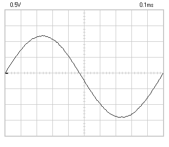

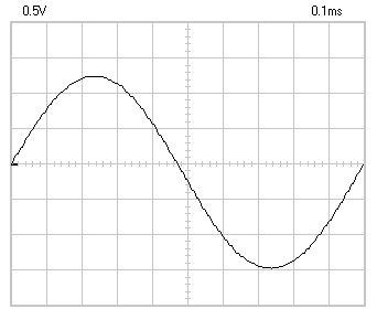

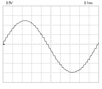

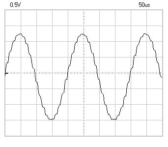

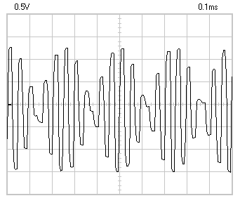

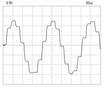

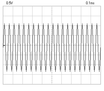

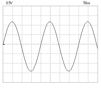

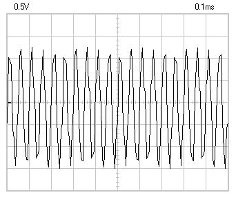

OK, my PC-DSO isn't any good at measuring very low level signals or precise frequency responses, for that I refer you to the Hifi Critic review.
Much more interesting, though, are how sinewaves look through a NOS DAC. No doubt it's what has kept so many from taking NOS seriously and still do for those that haven't heard it. And it´s those measurements you don´t find in reviews.
I used a Micromega DAC1 to get the result from a "conventional" DAC. This DAC isn't capable of 96 kHz sampling frequency, so only the results for 44k1 are given. I measured the Octave at 44k1 and 96 kHz to show the difference.
The pictures are from left to right:
Octave, 44.1 kHz, 1 kHz sine;
Octave, 96 kHz, 1 kHz sine;
DAC1, 44.1 kHz, 1 kHz sine;
Octave, 44.1 kHz, 5 kHz sine;
Octave, 96 kHz, 5 kHz sine;
DAC1, 44.1 kHz, 5 kHz sine;
Octave, 44.1 kHz, 20 kHz sine;
Octave, 96 kHz, 20 kHz sine;
DAC1, 44.1 kHz, 20 kHz sine.

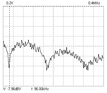

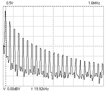

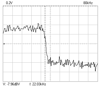

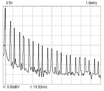

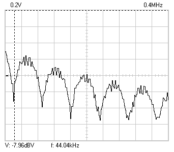

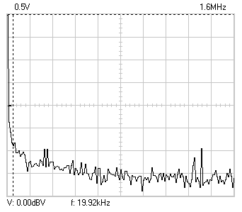

I also did some spectrum analysis with the same variations as my previous post, again from left to right:
Octave, 44.1 kHz, white noise;
Octave, 96 kHz, white noise;
DAC1, 44.1 kHz, white noise;
Octave, 44.1 kHz, spectrum of 20 kHz sine;
Octave, 96 kHz, spectrum of 20 kHz sine;
DAC1, 44.1 kHz, spectrum of 20 kHz sine;
Clearly visible are the images in the NOS DAC.
If you ask me if I can hear any of the really distorted looking signals coming out of the Octave the answer is a very firm NO, I don't. Given that these distortions are caused by frequency components outside the audible band, I'm not at all surprised that I really don't hear them, simply because I can't. As I wrote before: the perfect low pass filter is already in us!

To me, the 5kHz @ 44.1kHz one looks like is a 4 bit sinusoide... Those distortions are not outside the audio band, I bet that using some headphones you could hear the difference.
I am very interested in a mix of 19+20kHz 1:1 - for both of them.
Whether or not this is relevant I don't know. But I'm interested in seeing what the spectrum looks like at low frequencies when replaying the 20kHz sine. We've got what the spectrum looks like above it, but not below, does stuff fold back into the audio band.
Of course if you show the 19+20kHz tone we will get to see what it looks like down low anyway as the product of the IMD test.
