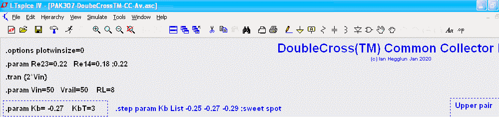

Methods to reduce crossover distortion?
DoubleCross settings in my above attachement
attachment.php
The load is 8 ohms.

In my opinion the so called "DoubleCross TM" simply looks like an OPS that uses a multi-sinh linearization technique. In my experiense you will get the optimum linear transfer function by using four output pairs with different offset.
I did it years ago using a Diamond EF3 OPS and resistors between the pre-driver and driver transistors to set the offset.
Hi Stinius, you are absolutely right, it is a multi-sinh linearization technique. These are usually used on op-amp input stages, so to me, it is interesting to see it applied on an output stage.
Can you share your Diamond EF3 OPS implementation?
Trouble is the double cross circuit is class-B, whereas input stages are class-A. I suppose in the overlap region you have all transistors conducting so cancellation is good, but ultimately there is gain-wobble, but futher from the midpoint for double-cross. It is interesting to compare it to class-AB, which also has a flat central region, but with gm doubling.
