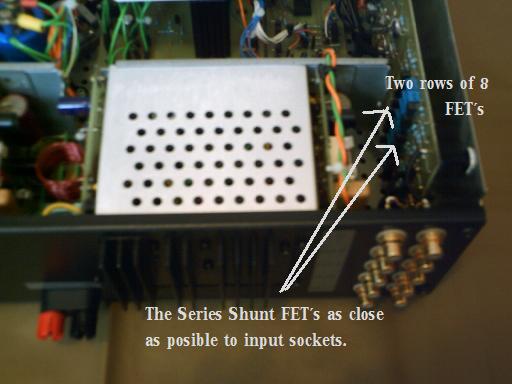

Normal rotary switches have a definite click action. You can get "break before make" and "make before break" types. You are probably looking at a 4 way 3 pole switch for what you want. Use the spare contact to drive a LED for indicating the selected input.
Over the years I have gone over to solid state switching, IMO it's capable of better results, you can put the switch on the PCB -- no wires -- and it's possible to add remote control.
My favorite is JFET's in a series/shunt arrangement.

If the J-Fet solution sounded inferior I wouldn't have gone down that route. I have used relays in the past. They were OK but the signal isolation left ( in absolute terms ) a little to be desired. The same goes for mechanical switching which also has problems with contact resistance over the years. The J-Fet can be placed where ever it is needed on the PCB. Correct implementation is vital however, which really means arranging the circuit so that no voltage appears across the device when it is on.

The simplest way is the switch. Signal path only. All grounds common.
This is the Jfet switching I used
