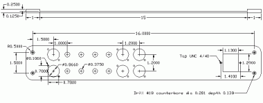

Anyone on this board want to offer their services as a machinist? I only need some holes bored in aluminum, in the style of the classic nearly-rectangular audio chassis. Here is an example part:

By the way, the units in the above drawing are inches. This part seems uncomplicated no? And I just wanted it to be sanded in one direction and clear anodized. I don't know why no shop wold take the work. Maybe the five other sides were too complicated. Maybe the whole job is just too small.

Since I no longer work as a machinist I can't offer my services for after hours jobs, but I can make a few observations that are intended to be helpful.
Most of your dimensions are to 4 decimal places. This implies that you want this work done to one ten thousanth of an inch (commonly known in the trade as working to tenths). this is approximately +/- one twentieth the thickness of a piece of paper! These tolerances are not generally within the capabilities of a run of the mill machine shop.
Your post states " I only need some holes bored in aluminum" but your drawing shows a milled 1/8" relief in the top view, rounded corners, and a square (punched) hole. This is This is a minimum of seven setups on three different machines for just this one part.
I gather that you are very concerned about appearance i.e. "brushed in one direction and anodized". One thing you learn on the shop floor is the finished part is never as pretty as it looks on the computer monitor. What you are asking for is hundreds of dollars worth of work to be done to consumer grade finish while exhibiting little knowledge of process. I suspect the people you dealt with simply assumed the chances of ending up with a happy custumer were pretty slim.
Beyond that your dimensions imply something close to a standard rack mount size case. Why don't you buy an off the shelf case? (do a search here for cases) with blank front and back. You can then modify it using a cheap Home Depot tabletop drill press, a Unibit, home made disc sander and a file. The total cost for these tools is probably less than shipping and material costs let alone labor for full custom.
Please understand I'm not trying to dump on you. I just trying to educate and help you accomplish your goal.

Hi mltaunt! Thanks a lot for your input. It sounds like you are pretty familiar with the goings-on in the shop. Just so we understand each other, I studied mechanical engineering at university, although I never practiced outside of internships, so I'm more well versed in manufacturing than a random guy off the street. I realize the dimensions are all to .1mil, but I explained to the machinists, who were all working from paper-napkin sketches when I visited their shops, that this is just the default dimensioning style in AutoCad R13. The tightest actual tolerance on here is 4mils in six places, and 10 mils everywhere else.
Yeah there is a milled relief on the back panel. It is the only way to have the counterbored fasteners and still mount the connectors. The relief is on the inside so it doesn't need to be faced.
That's what's going to be the bank breaker, regardless of whether it needs to be grained.
Why not go with a 1/8" panel with a 1/16" counterbore and use some low profile socket head screws? That would give you virtually the same look as a fully inset, full height socket head while dramatically reducing the machining costs.

comment about your drawing: it's going to be time consuming and hard to reduce the thickness of the plate in the way you are showing. Not to mention that you are going to lose alot of rigidity.
Do you really need that?
To do what you have drawn will probably take a machinist 4 hrs of work @ $60/hr unless they have highly specialized CNC machines. There has been some talk on this website about a place in EU were they do this type of panel work.

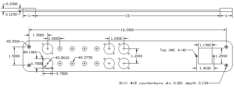

So everyone is in agreement that if use a piece of uniform 0.125" thickness, it will be more manufacturable, and I can still counterbore 0.080" for low profile socket cap screws.
I just realize that if I make that change, I can make these panels myself with a jigsaw and drill press. Whee.
Lets make it even easier. Drill your counterbore all the way thru the 1/8 plate. Drill the clearance hole thru a smaller plate and glue in back of faceplate. Round and grind (or sand) the corners and edges to match. Wouldn't hurt to glue some strips around the holes to stiffen things up. Glue you says. Sure I says. the last airplane you flew on probably had it's wings held on with glue. I would recommend a bandsaw or rotary file and a straightedge rather than jigsaw. Nothing like trying to cut straight lines and circular arcs with a tool intended for irregular curves.
No argument from me. 🙂
But a jigsaw and a drill press won't get you nice bead blasted edges, a well grained face and a good clear anodize. 🙂
