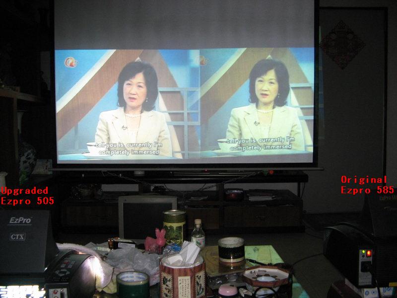

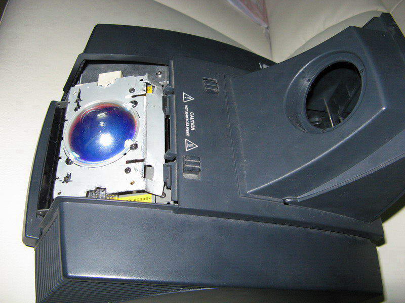

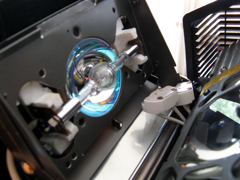

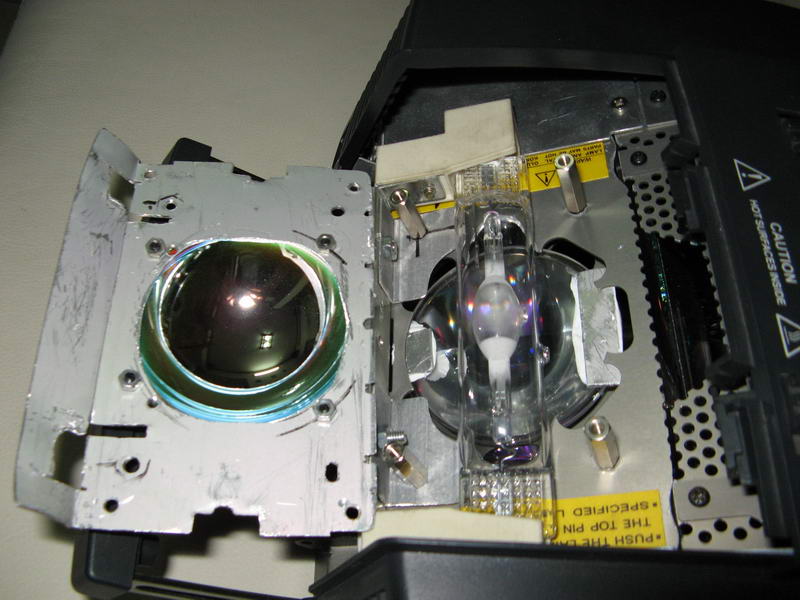

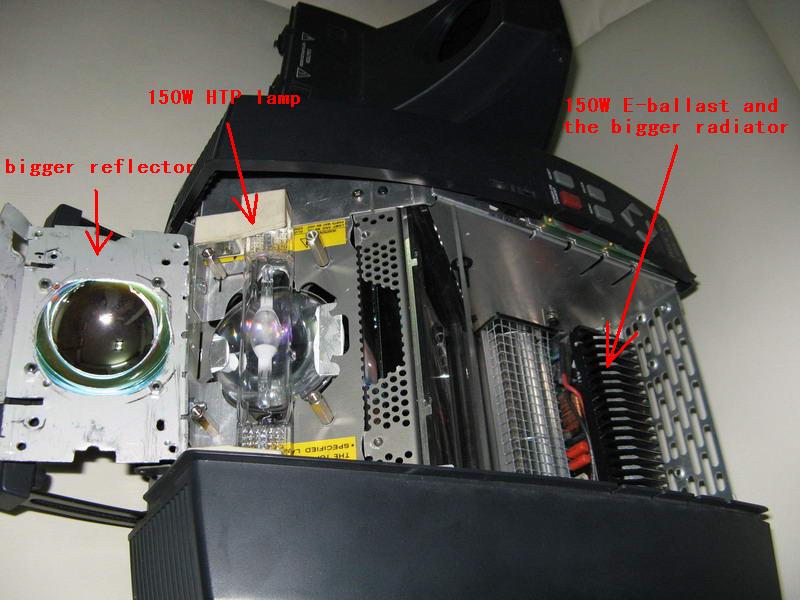

you can not cut some part of board, caon noty cut the power of 36v. dont remove .
the core of HQI is too bigger, the light system can not nice for bigger core .

Are the condenser and the reflectors that you used the ones that came with the projector? (They seem to be different in the pictures)
What did you use to buld the lamp holder base?

you can use the original condenser and the reflectors, that is easy to do.
I can give you new lamp holder base.
40$ for the lamp is OK! but you have to buy ballast.it need $80.

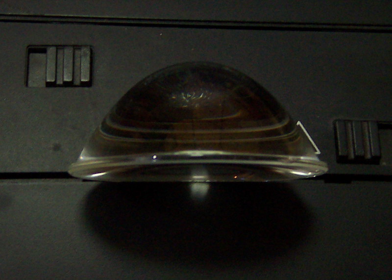

BTW can someone tell me where can i find a compatible condenser lens? I'm usein one that has the right focal lenght but it leaves some of the corers dark It cannot be noticed with letterbox movies nut is reallly annoying with the fullscreen movies.
yes I need condenser lens also if you have a chance to get one or more for spare, BTW think that other users around need it also.

condensor: $40 (only one now, a bit of emargination but outside of light way)
