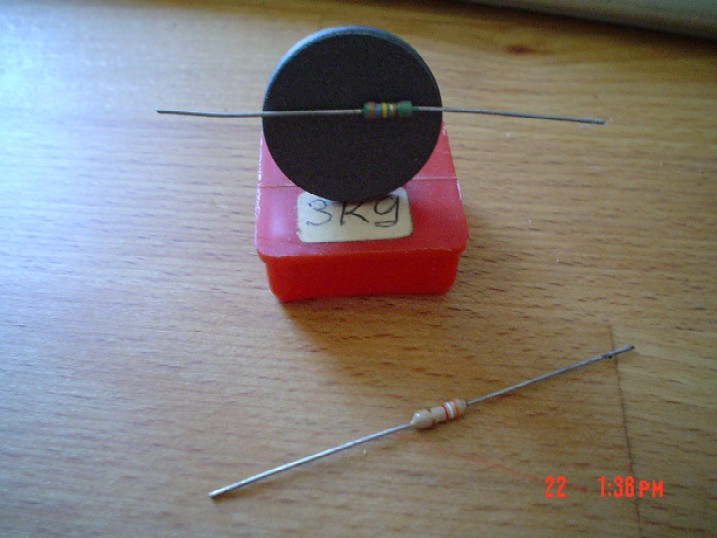

metal film or carbon film?
I don't want to be the skunk at the picnic, but...
Nichrome is not ferromagnetic.
If it were, the film is too thin to have any significant attraction to a magnet.
What the magnet is attracting is the ferromagnetic end caps which make contact with the resistive film/ceramic substrate.
Ran across this thread earlier today.
I find both NiCr Susumu thin film ($0.40) and Vishay bulk metal foil ($20) SMT resistors are weakly attracted and stick to rare earth magnets. If I can find ones that I don't need, I'll cut the ends off to isolate where the attraction is.
TaN film SMT also attracted to rare earth. And $20.40 later, find that it is indeed as Sy indicated--the ends of the Susumu/Vishay are attracted.
Of TH resistors, "superb PRP 9372 audio grade metal films from Precision Resistive Products" very attracted even the body. Of the resistors I tested, only Holco resistors are standoff-ish.

One way to figure out if they are carbon or metal film resistors is their temperature coefficient. In general, the resistance of metal film resistor will increase by increasing temperature (i.e PTC or positive temperature coefficient), while carbon film resistors will see their resistance drop by increasing temperature (i.e. NTC).
Some, it is a very simple test: measure the resistance of the resistor while you heat it up (keep a solder iron very close to it, the value will change in seconds....). Carbon film will drop fast.
