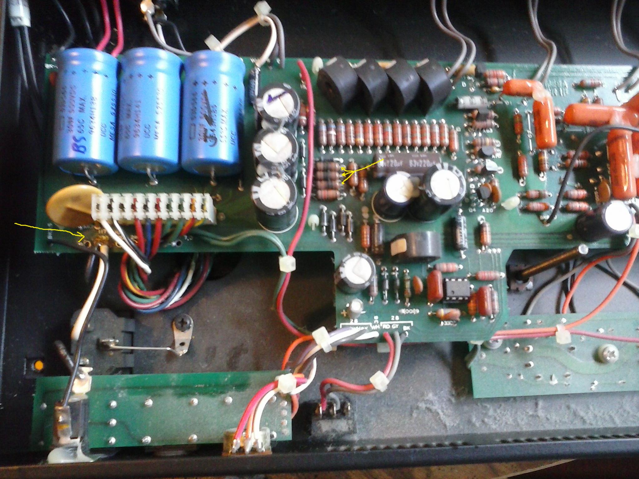

I was playing through it and all of a sudden the volume level started dropping. The power light went out and I smelled something burning. I unplugged it immediately. I checked the fuse and saw that it was blown. After replacing the fuse, it blew again. I knew that there was something seriously wrong, possibly the power supply, mains transformer, etc.
Later, upon further instruction, I removed all tubes (4 12ax7s and 2 EL84s) replaced the fuse and turned it back on again. Once again, the burning smell and power loss.
Well, I opened the thing up. I found three resistors that look like they might be burned up. Two are 1K resistors and the other is a 110 ohms value. When I checked the resistance on these they all read 244 ohms. Not sure why differing rated resistors are reading the same value......
I also noticed that the white wire, coming off of the power jack and leading to the circuit board, has a burned and discolored looking solder point now.
I was thinking about replacing the resistors but I am afraid that they will just burn up again!

Here is a picture of the burned up components. I drew yellow arrows to the places I noticed as messed up. Sorry the picture is so blurry.

That white wire that looks ugly at the circuit board may be fine. It looks like some solder flux was left behind (not a big deal). The burnt resistors will need to be replaced after verification of what their value should actually be, but it's highly likely that they are just indicative of something else wrong, which caused them to burn up. If the circuit is a highbrid (tubes and transistors or opamps), then it could still have been a tube intermittently shorting out and blowing up some of the solid state circuitry, which then burned up the resistors, so I wouldn't assume the tubes are innocent. I would definitely not go forward with this project unless I had a schematic. The rectifier diodes that may well be feeding those burnt up resistors may also be blown or damaged. I'd look closely on the schematic at what those burnt resistors are feeding voltage to, and take it from there. It may well be wise to take it to an authorized service tech as stated above. When you or whoever finally powers up the unit again, it should be brought up slowly with a variac, while AC current is being watched. That minimizes your chances of another blowout, in case some of the problem is still there.
That's because they are all 1K, and all in parallel - so should be 250 ohms when measured (I'm presuming they are the ones in the low voltage supply rails).
However, this couldn't blow the fuse - so isn't going to be your fault (it's just ageing and discolouration of the resistors).
The white wire looks fine as well.
No need to take the valves out, simply switching it to standby disconnects them all from HT, leaving little that could be wrong (basically transformer, rectifiers, large capacitors).
