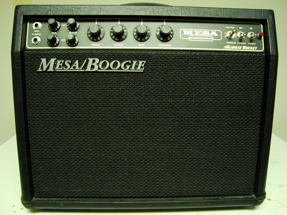

I snagged this little gem out of the classifieds tonight.
I played it for 20 minutes then took it apart, I just had to have a peek. I am currently cleaning it up for reassembly.
Everything seems to work OK. The ad said there was something wrong with the footswitch, seems fine to me. I might redo the leads for good measure.
I have a couple different 10" AlNico speakers I can try out. Right now it has the 10" Eminence Black Shadow deal.
Not sure what all I am going to do with it. I will post here if I feel there is any thing of interest.
All in all a nice little amp. I was going to build another little amp for myself, but this one was too tempting to pass up. I was being to anal about my next amp, this one gets me playing again in the meantime.

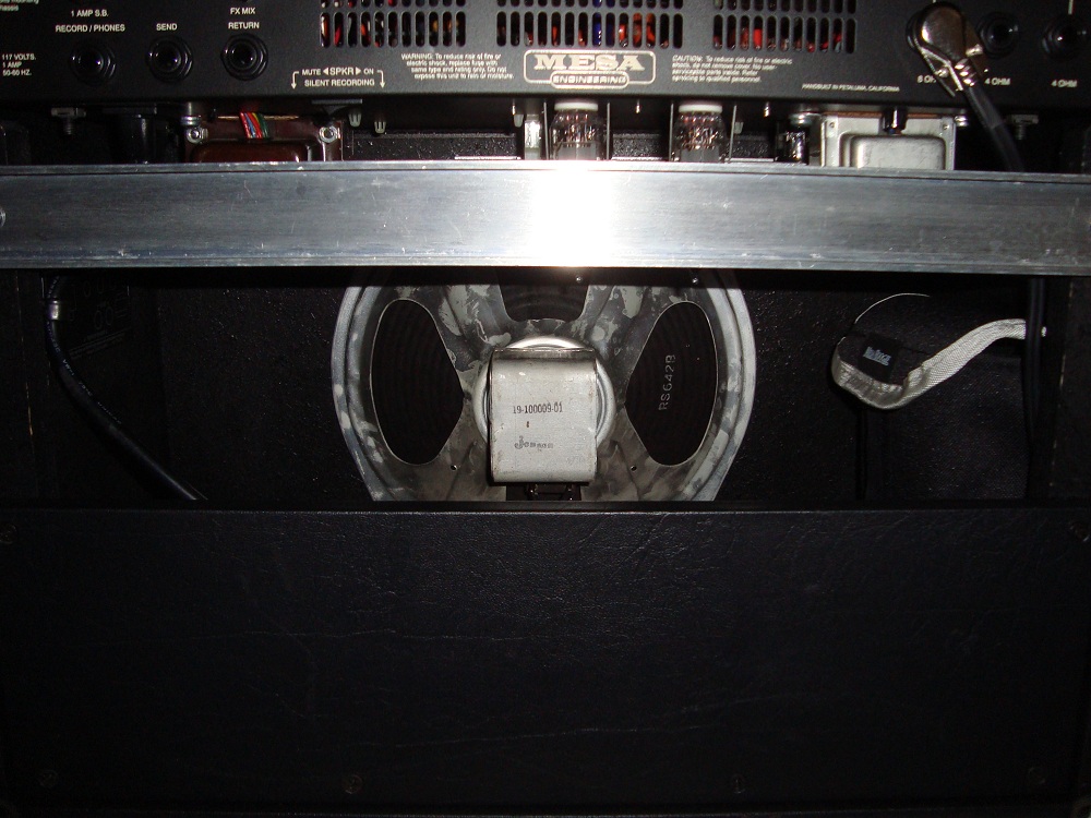

I had to reattach the speaker binding post on the original 10" Vintage Black Shadow speaker.
I had read were others with this amp complained of a "honk" with the original speaker that went away by plugging into an external cabinet. I can confirm this.
While I had the speaker out I decided to try some different 10" drivers. The "honk" did not seem bad until I compared it against some AlNico speakers I had.
Odd as it may seem, I just used a stereo to compare voicing of the speakers, in free air. I was able to switch between speakers quickly and compare.
The factory speaker does have a strong voicing. It`s a 10", but has the magnet, mass and stiffness of a 12", this IMO causes the odd peak in response.
The speaker I replaced it with is a Jensen P10 AlNico speaker, I am very pleased, this was a very dramatic change in sound for the better. It even does "metal" better then the big ceramic magnet, contrary to what I expected.
I am very pleased. The Jensen sounds much more "tactile",brought some "glass" and "shimmer" to the high end that was absent before.
I suspect the heavy cone, mass spider and the 50watt ceramic magnet of the original speaker robbed the mid-high harmonic content.

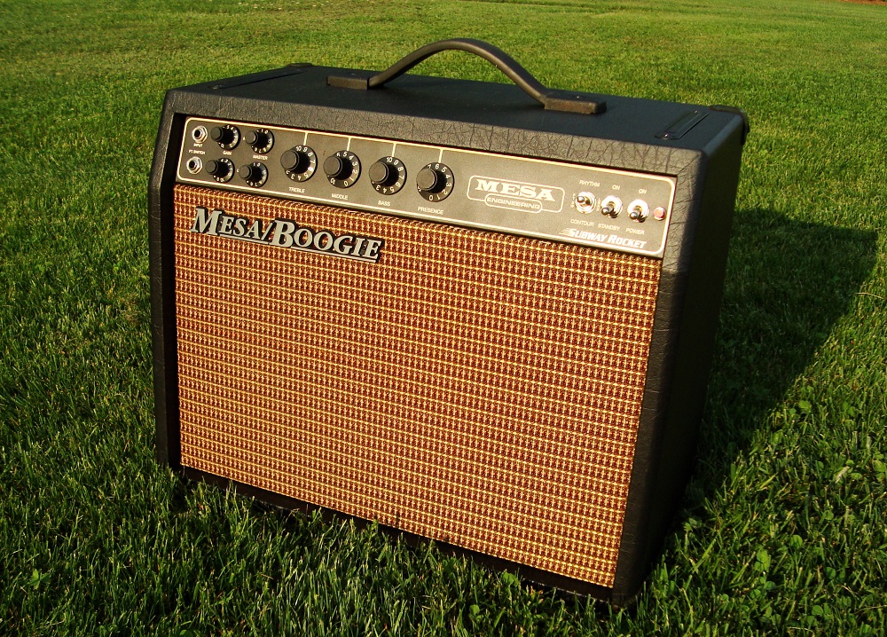

When I had it apart on the weekend I took the chance to measure the grill frame. I took these measurements and made a duplicate out of 3/4" plywood, it was what I had at hand. The original frame was chipboard.
Onto this new frame I added some vintage grill cloth. I cut them off old record consoles etc from time to time. You would be surprised how well they clean up. There is usually some imperfections, so it is more suitable for smaller projects, like this.
I decided on the cloth you see pictured below. It was choose it because it looks decent and is pretty much void of defects...
...I notice in the picture you can see the edge of a few staples. Whaa.
I can move them back next time I have it apart. (I was thinking all four sides would be covered, but the top has around 3/16" reveal.)
I did not notice the staples indoors.
