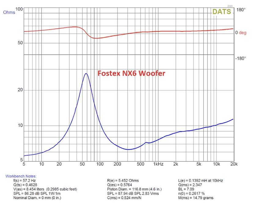

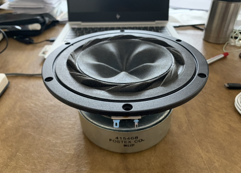

I have a new pair of Fostex woofers that were used in the NX6 monitors. They look exceptional stout and well built. The surrounds remind me of the Purifi PTT6.5. That folder pentagonal ridged cone is wild - supposedly much stiffer than a plain conical cone. I think Fostex crossed these at 5kHz almost making this a “full range”.
Here is the DATS measurement:
Could this be the poor man’s Purifi? With a Qts of 0.46 and smaller Vas of 0.33 cu ft. it might make an excellent MLTL of tapered TL speaker with a super tweeter.

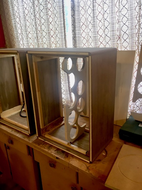

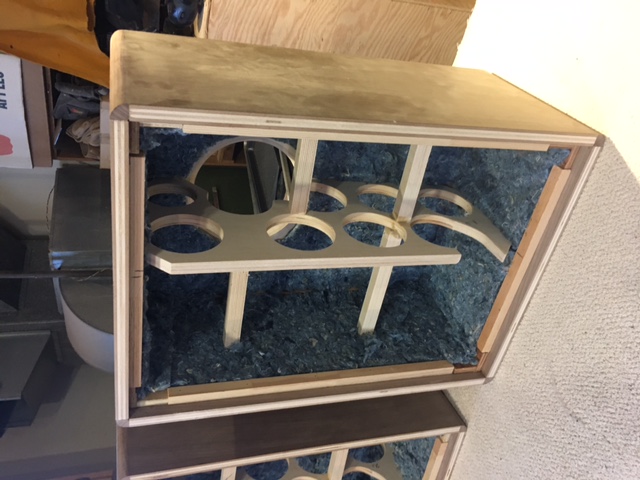

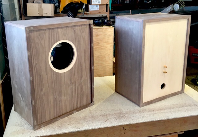

Working on a large BR cabinets for the Seas FA22RCZ drivers. I used Scotts design he posted a while back...They are built with Baltic birch and Walnut ply. Going for the retro mid century modern look...
