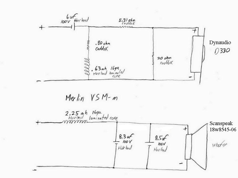

I want to clone Merlin VSM 😀.
Now i have Dynaudio T330 tweeters and Scanspeak 18W8545-06(from Merlin VSM)
I have found on this website crossover (attached file)
Please tell me this crossover is correct?
nope, everything is in there...VSM-MM, please find another pic of the other side of the board.
I thank you very much for your help.
Through the picture you post it exactly with x-over except for the lack of a 2.25mh inductor for the mid / bass speaker.
i don't understand how mid / bass driver can work without inductor, it is not fullrange speaker.
