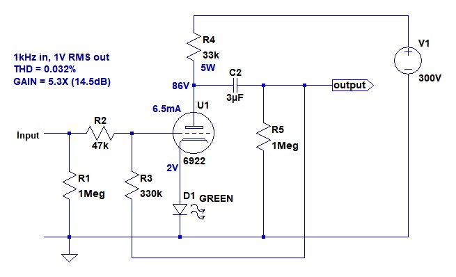

Ohhh I see. But can I just apply NFB on a single triode stage? I mean take the output from the plate and back to the grid. regulating it with a resistor..
With a circuit that uses NFB you can adjust the gain to your requirements.
I've attached an example of a simple anode follower using a 6DJ8, arranged for 5.3X (14.5dB) gain. That is a simple triode stage with negative feedback plate to grid. R3 takes output signal and feeds it back to the grid, forming a voltage divider with R2, which defines how much negative feedback will be applied.
Using a single triode stage with no negative feedback, the gain is defined by the triode itself.
6N23P = ECC88 = 6DJ8 has mu of about 30
Real-life gain should be about 25X
That is 28dB gain
6N6P has mu of about 20
Real-life gain should be about 15X
That is 23.5dB gain
6V6-Triode has mu of about 10
Real-life gain should be about 7X
That is 17dB gain

As you can see, the anode follower (simple triode stage with plate-grid NFB applied) can reduce the 6DJ8's 28dB gain to about the same gain as a 12B4A (15dB), by applying 13dB of negative feedback (reducing the gain of the 6DJ8 by 10dB, or about 3.3X).

This is interesting! thank you.
yes that is what I meant. output after the coupling cap. back to the grid..
Then I can get rid ot that dist. without having to use an extra tube. dont I?
Yes, NFB reduces THD.
However, this depends on the load the 6DJ8 has to drive. The plate-grid NFB appears as an additional load in parallel with the rp of the 6DJ8, in parallel with its plate load resistor (R4), in parallel with the output load resistor (R5), and in parallel with the input resistance of the load (your power amplifier). Normally you'd want to add a buffer (cathode follower or source follower) to the anode follower, to reduce the load on the triode. But in this case your load (your power amp) has a high input impedance of 1Meg ohms. That will help keep the 6DJ8 from getting 'loaded down', so yes, this particular circuit will reduce the THD of the 6DJ8 by almost 13dB as well as reducing its gain by that much.
To make the circuit work even better, you could put a cathode follower after the triode gain stage and take the output signal from after the output cap from the cathode follower. But you said you didn't want to use any followers, so I offered this simpler circuit as an example.

How do I know if the load on the triode is too high?
I'm not sure what you mean by "If the load on the triode is too high".
If the amplifier really does present a load of 1M ohms, then I don't think you have to worry much about the triode stage being burdened by a heavy load. If you do the math of paralleling the various loads on the triode, you can figure out exactly what the load will be.
6DJ8 rp = 4k ohms (roughly)
That will work into a load of:
Rp = 33,000
R3 = 330,000
R5 = 1M
input R of amp = 1M
33k // 330k // 1M // 1M = 28.3k ohms
That's a light enough load on the 6DJ8. It should work fine.

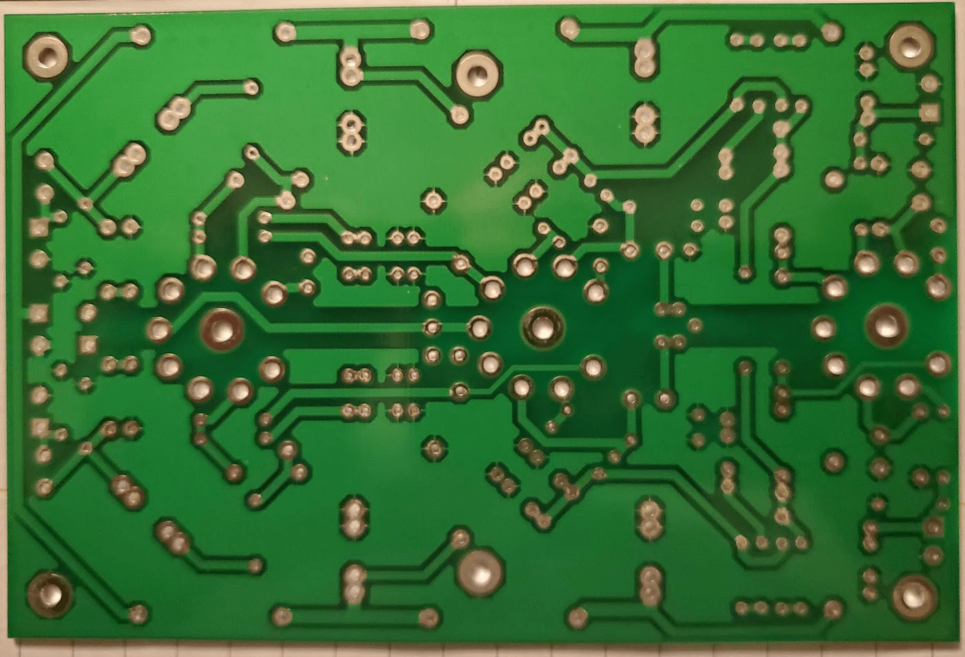

Hello everyone! I am trying to get the Merlin 3 valve phono PCB printed but it seems the bottom layer of the PCB is not visible in the manual. It can be seen here: http://www.valvewizard.co.uk/phono_pcb4.jpg
but not clearly. Anyone perhaps has a picture of it?
Thank you!
Thank you!
