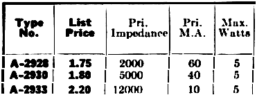

12K 10mA means only 120V peak swing. Taking a pentode and 40V drop, use 160V supply; somewhat more for a triode. Expect 0.6 Watts, not 5W! (5W is the core size, but the DC current rating does not allow near that much.) The 6K6 does have a rating for 110V supply, 9.5mA, and 0.35W out. I'd expect "small communications receiver", but it could be better.
BTW, FWIW: I keep saying lower Z is lower cost. Here we have prices for similar parts at several impedances.

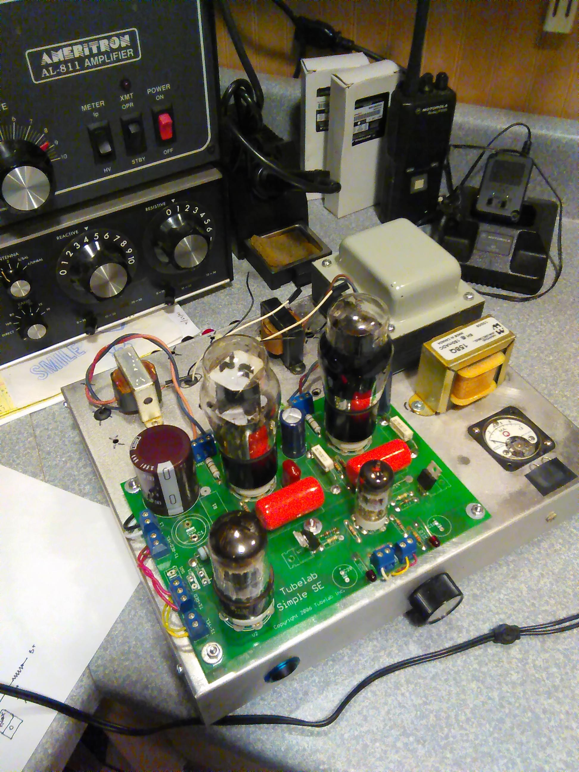

I ran a pair of 30 - 40 ma ish A-2930's, with some 6N6G, for several months in place of Edcor XSE-15, while the latter were being used in another project. At normal listening levels, I thought they were fine. They didn't do well on a 60:6000 SMPTE IMD test, but I didn't expect them to.
I would expect the smaller ones to be good, within their current and power limits. Frequency response will be much better than 300 - 3000 if those are anything like the 40 ma OPT's.
Win W5JAG
