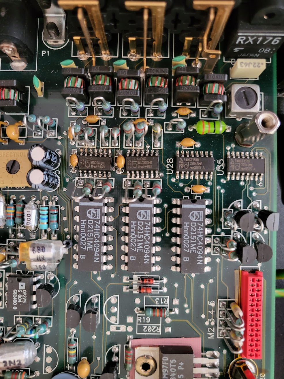

Help me figure out the problem.
Most likely, a faulty device was connected to the input (or simply static electricity from a poor grounding).
In general, the digital input stopped working (2 of 5).

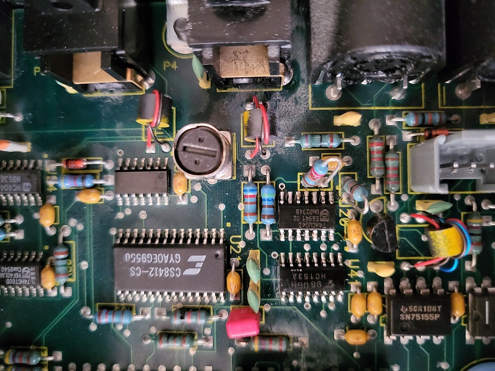

There are 5 inputs (+1 output) on the board, and each chip apparently serves two inputs. All I could do was ring the resistors at the input of the microcircuits, and apparently the signal from the connectors reaches the microcircuit through passive elements.
This is some kind of microcircuit marked 74HCU04D, and then another one 74HC4094N (D2151ME) after it.
Of course, I hoped that there was a fuse somewhere along the input, but there was none. I understand that it is most likely worth starting with these microcircuits, but which one?
Apparently it’s worth starting with the first one, since it’s most likely broken (but possible next one). Perhaps many people know this implementation of digital input and similar problems.
What are your guesses?

Multimeter is available. It seems the most logical thing to replace 74HCU04D, since it is the first at the input and can withstand something like -0.5 to VCC + 0.5, which clearly could damage it.
What about the isolation baluns? Fatigue crack in the wire or a solder joint?
Besides, a 74HCU04D is what, an unbuffered hex inverter? Best to scope it first.
I see that the signal goes from the resistors immediately after the filter (coils and caps) to the legs of the microcircuit 74HCU04D (8-STAGE BUS REGISTER).
Judging by its current and voltage parameters at the input, any sneeze could kill it.

Not really, if we are talking about dac work. 100MHz is about the minumum. 200MHz or higher is better yet. Otherwise the square wave clock signals will look like sine waves, maybe very small sine waves if that....a cheap thing should be enough.

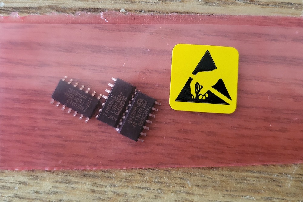

These are bog standard CMOS logic ICs; an inverter and a shift register. The parts are cheap (<$1 ea). If you have sufficient solder/desoldering skills and are used to working with larger SMD components, I would go ahead and change these. The 4094 in a PDIP-16 package could be a bit more difficult to find, though searching for CD74HC4094E shows that Digikey has these. I'm guessing that the photo you provided in the 1st post isn't your unit. The two chips to the left of the ones you marked are pretty crooked for a commercially produced unit and almost indicate someone has been in there.
No, this is my device... 74HCU04D look like they've already been replaced before me. But the input worked before that until I burned it.
So maybe I'm not the first to do the same 🙂
Although I have encountered situations where the breakdown passed through several microcircuits further, I still have hope that it stopped there. That's why I'll change it first.
Regarding 4094, it looks more massive and I hope it survived.

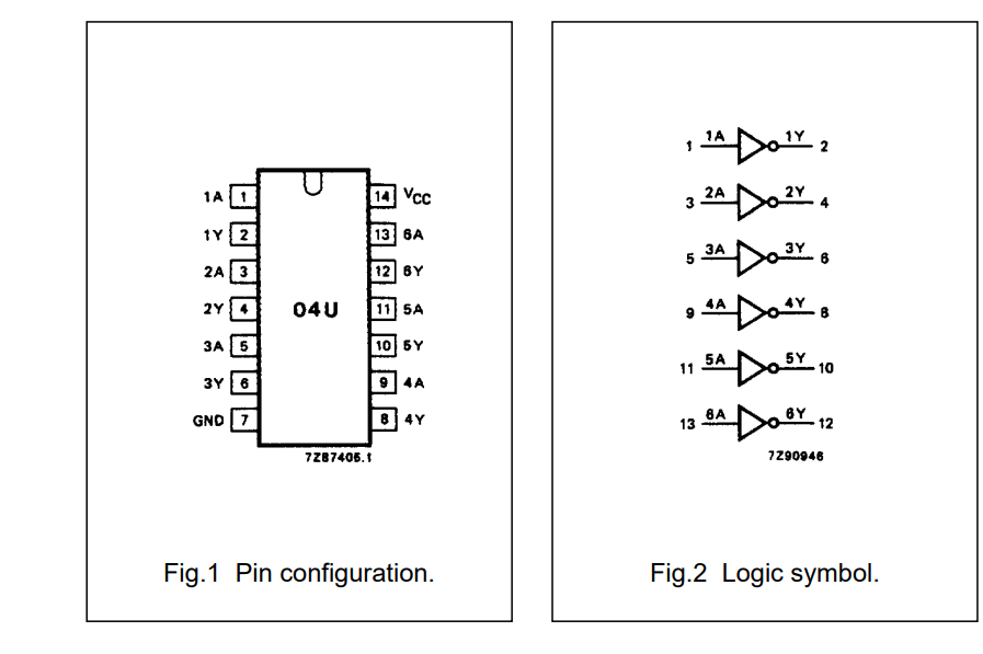

It might be worth checking the supply to the 7404's. Pin 14 should be at 5 volt with pin 7 at zero volt (ground). Also check each input and output pin. For static inputs (not connected to anything) I would expect to see simple logic levels, whatever an input is (logic 1 or 0) the output should be the opposite. The 7404 is commonly used to clean up digital inputs in situations exactly like this.
There are six invertors in each package. Yours look as if they may have a resistor (feedback) from output to input to add hysteresis forming a Schmitt trigger and ensuring clean switching. Some in the package may be unused with the input tied high or low but the same rule applies, whatever is on the input should generate the opposite logic output.

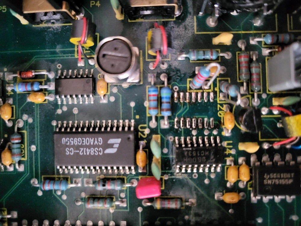

Looks very simple. Does this mean that in my case only 2 inverters out of 6 are used. Because 3A-3Y and 6A-6Y are ringing from the resistors at the top front of the chip.
I don’t have the circuit, but if we assume that the others are not involved, then you can try to throw a jumper on the adjacent pair inverter without desoldering the microcircuit.
This makes me a little sad, since I see live contacts 3A-3Y and 6A-6Y (current passes), so the microcircuit may be working. Although this does not mean that it works normally.
In any case, I'm waiting for a new chip to replace it. I'll try to ring it again from different contacts.

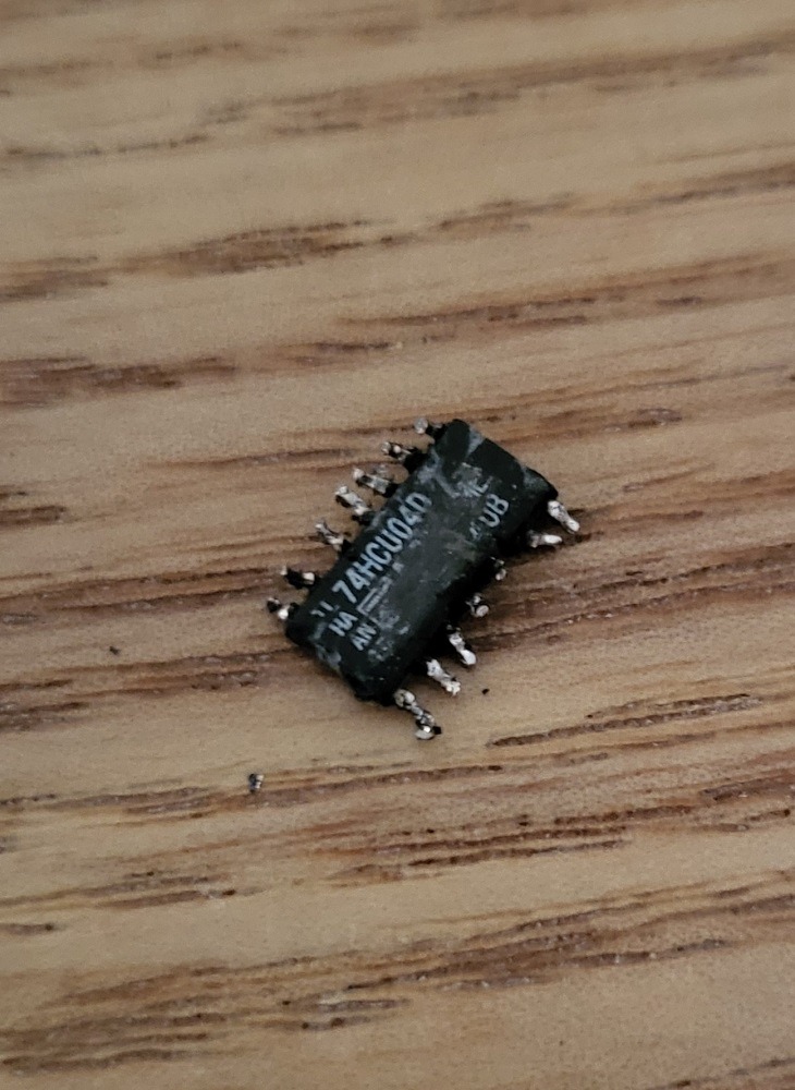

Actually that's all. The device began to purr.
The only thing I want to say is hello to those who soldered this microcircuit.
It looks like it was welded and glued with epoxy resin. I bent the tweezers 20 times and finally removed it with pliers.
