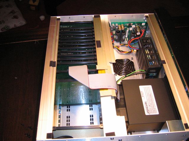

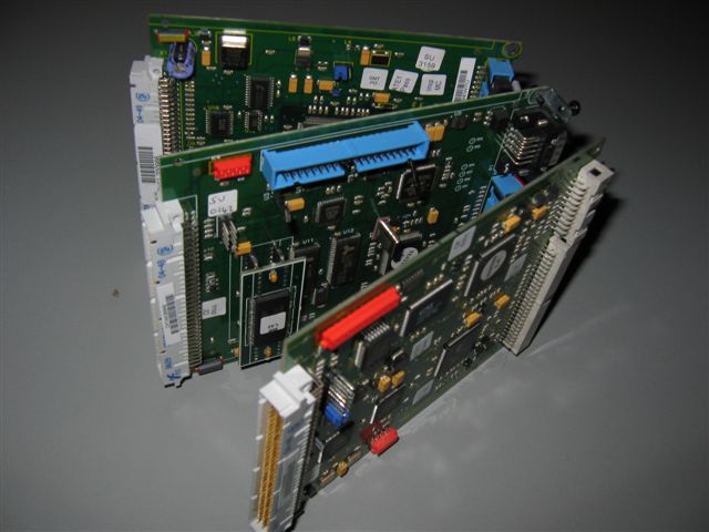

Its an cdp with a computer dvd-rom drive, 3 processors, memmory for buffering a computer stile enclosure(pics later) a SMPS enz.

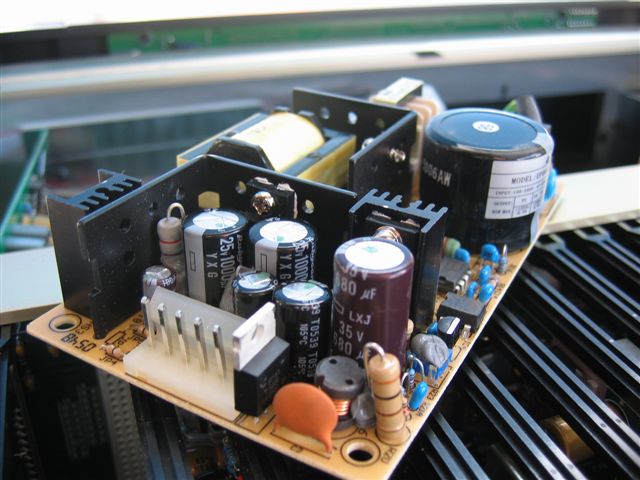

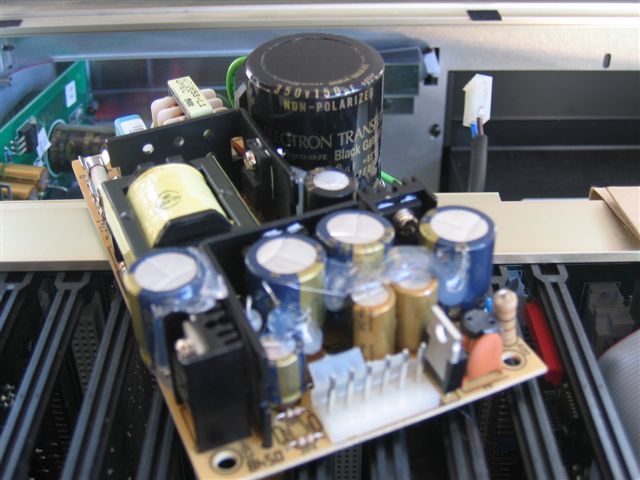

I started with the SMPS.
It's a very standard +12/2.5A -12/0.5A +5/6A powersupply
US made UNIVERSAL MICROELECTRONICS UP0653S.
I replaced all caps with panasonic-fc types exept for the two small ones on the front: Nichicon Fine Gold types just becouse I had them.
The biggest upgrade is the big Black Gate NH type 150/350
It's all burning in richt now so updates on the sound quality later.
I would frankly be very, very, very angry if I opened up a player I paid thousands of dollars for and found a switchmode power supply & a computer dvd drive. I would find the designer's house & throw bricks through his windows every night for a month.
Needless to say, the first thing I would do is figure out the voltage/current requirements & completely replace that worthless SMPS with real, linear power supplies.

Don't forget the cd rom drive, it's one of the cheapest available, and has been so unreliable, there have been many returned for replacement because they have become noisy or died, and the machines were still under one year old. But it does sound good for a while at least, I could imagine that with a linear supply would take it up one more notch again as well.

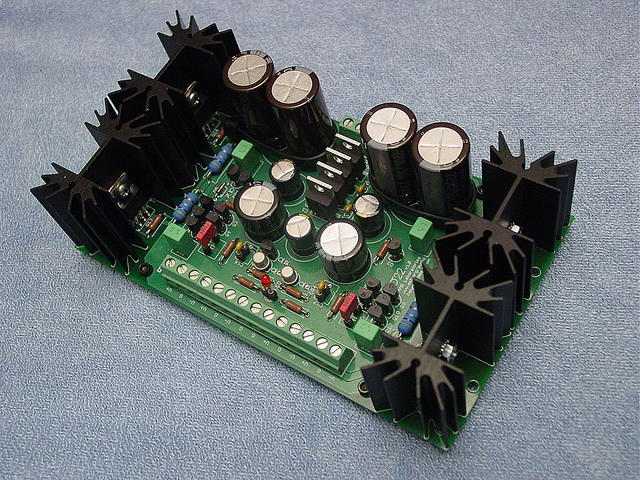

If you have the urge to experiment, and this urge I well understand, why not buy the rather fantastic CDP kit from your Dutch neighbour Guido Tent of Tent Labs?
This machine has been designed from the start to be pretty much an ultimate machine, but as a kit it is accessable and there is a whole bunch of people building it and a support forum to help out. Check it out at:
http://www.tentlabs.com/
Sell the Meridian before you destrop it, or keep it as a reference to compare the TENT against.

And yes I very well know of tendlabs I'm even using his material to do upgades to other people's high-end gear.
Thats also the reason for this upgrade(to show whats possible).
