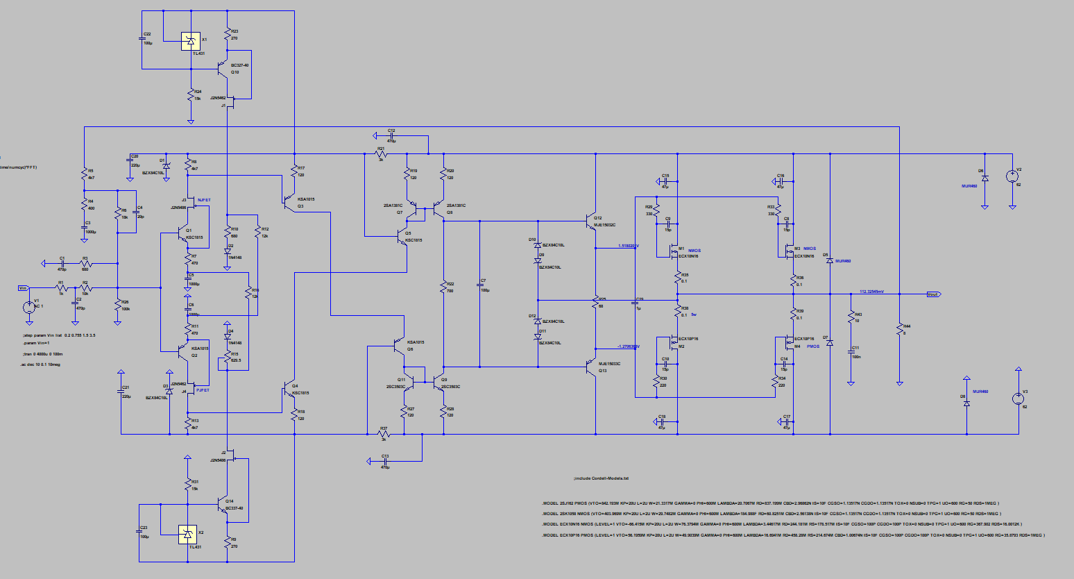

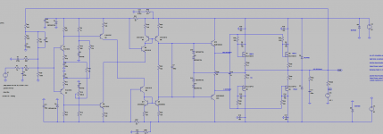

For those that did not follow this thread... It is a Meridian clone using laterals for OPS.
The results are so amazing I am wondering if they are correlated with reality.
Personally I would replace the 10nF drain caps with 2.5mm 47uF lytics. The funny thing about lytics is that they usually already have a 10nF or so cap inside them which bypasses the ESR at high enough frequencies where the oxide layer behaves more like a dielectric than a conductor. At low lead spacings the inductance is often not a concern and the lossiness does nothing but reduce resonances which low-loss caps tend to exacerbate.
The 470nF+4.7R snubbers can be replaced with a single 470uF lytic if you use the 47uF drain caps, although for the current 10nF drain caps they might be in the right ballpark for damping them IF there are no other lytics on the board connected across the power rails.
Just my 2C, although the current arrangement may work just fine. I just prefer to have a lot of capacitance on the board close to the output transistors as this keeps most of the haversines confined to a small area.

Thank you, I will try those mods.
Would you please comment on the diodes D2 and D4 as I am not sure what these are for.... would BAV21 be better here ?

I can't determine what D2 and D4 are for, but I would think they have something to do with tuning the amp behavior during startup or prolonged clipping. They seem to be keeping the input transistors slightly on at low supply voltages. They could also be affecting temperature compensation.

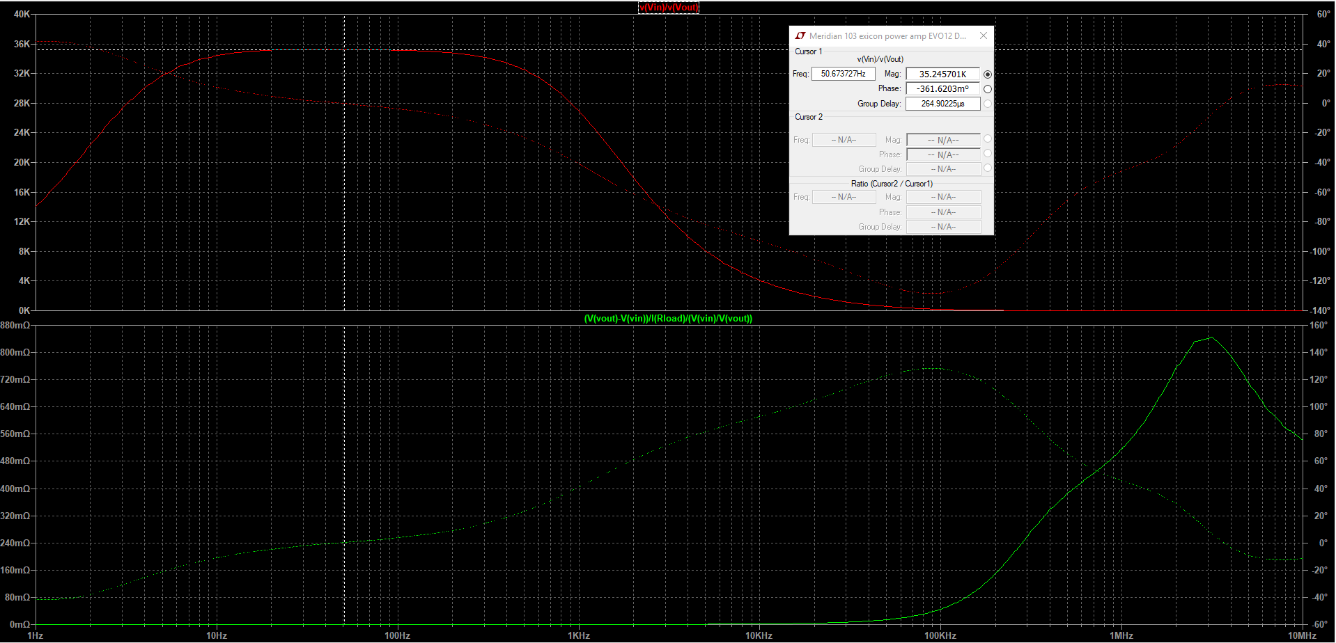

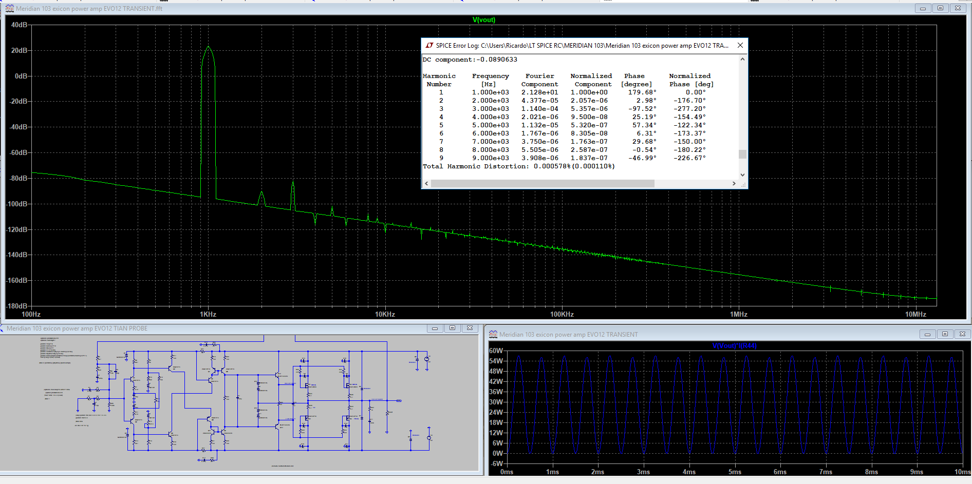

New work done.
Jfet cascoded IPS
IPS bias now set with CCS found here: TSSA - The Simplest Symmetrical Amplifier
Needed to reduce lead lag capacitor in the feedback loop to retain a good phase lag.
That also increased bandwidth and -3dB is now near 300khz.
IPS emitter decoupling capacitors where increased to 1000u.
THD reduced from 0.005 to 0.0035% ...
Now my question is... can I use 62V rails with only two output lateral mosfets per rail or should I reduce voltage ?

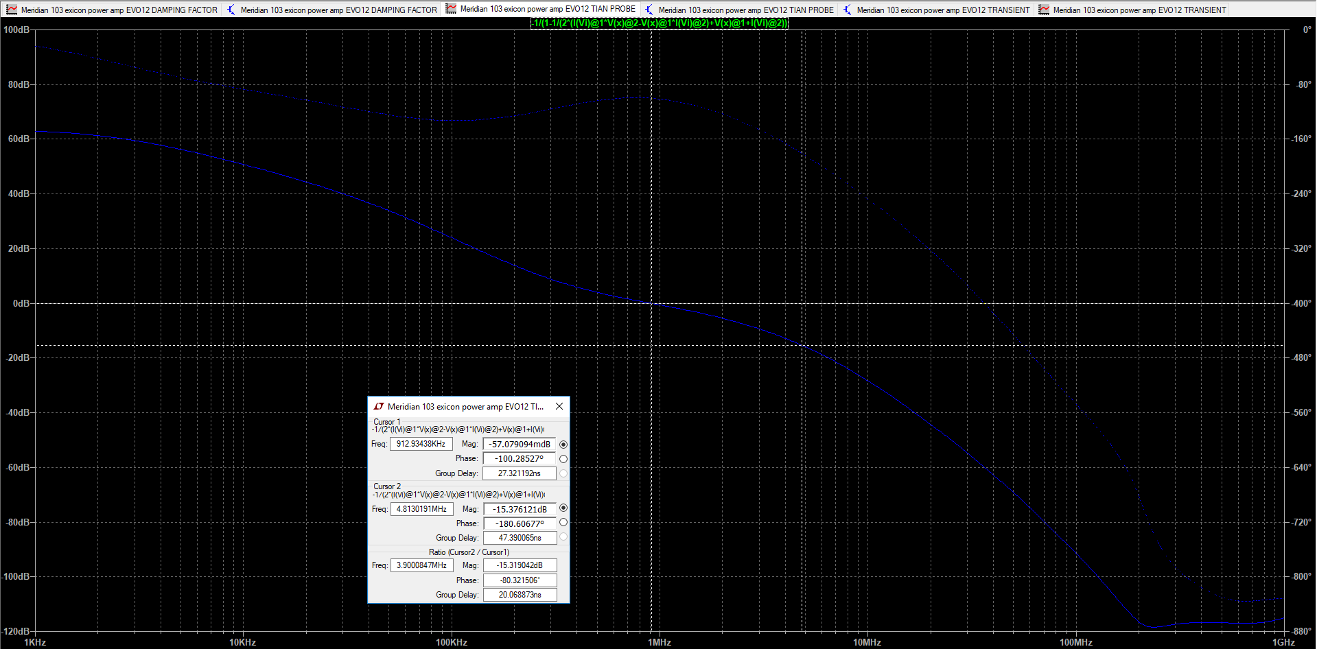

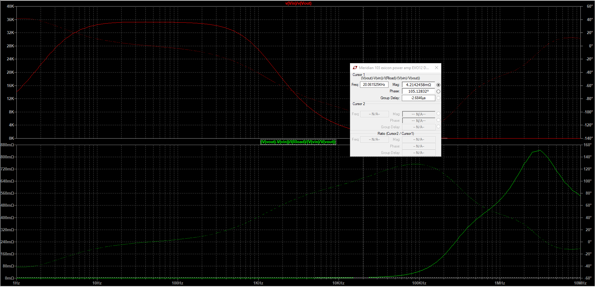

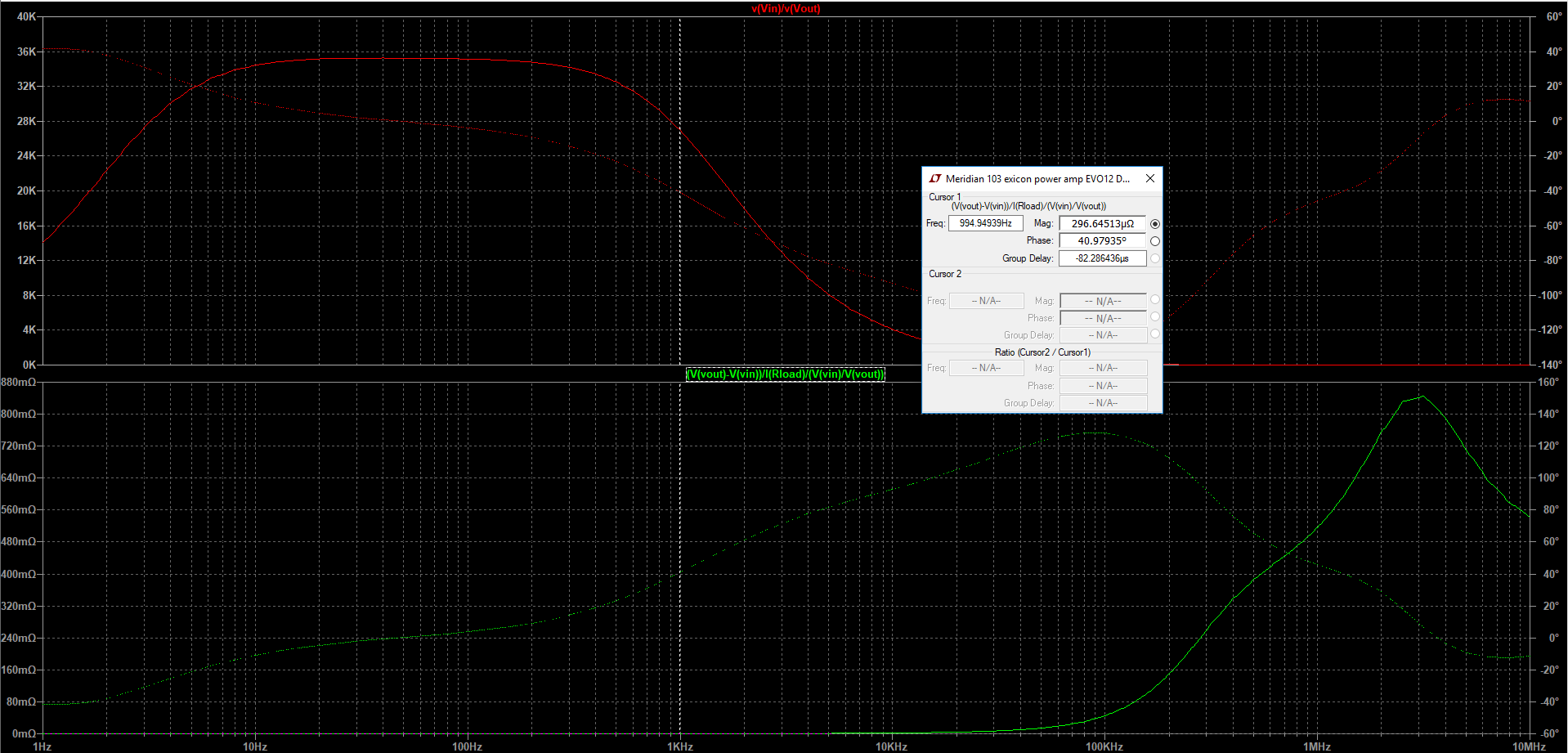

Is it normal that I find a damping factor of 33000 at 1khz ?
Output impedance is 247uohm at 1khz .... never simed nothing like it before.

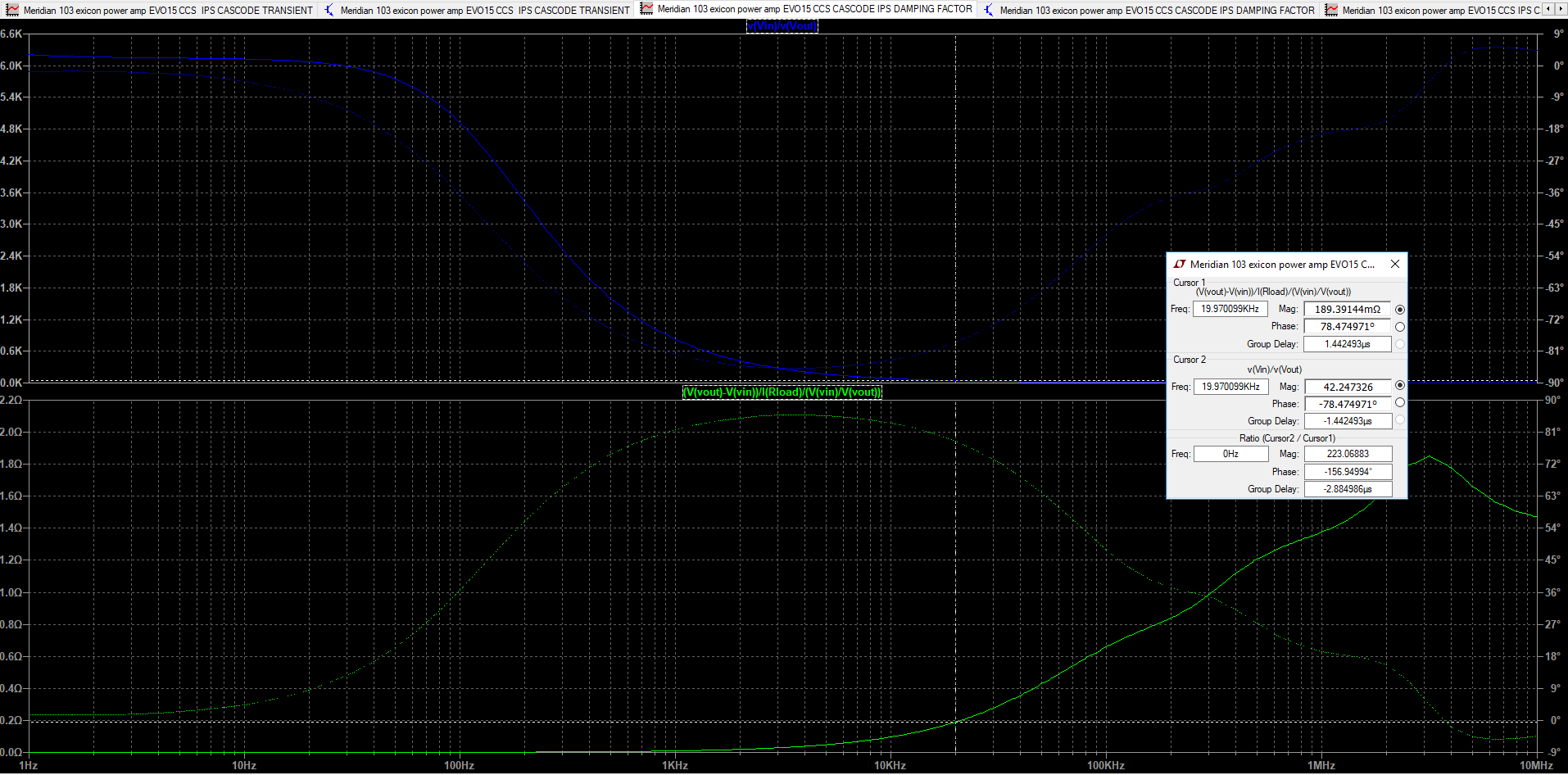

Adjusted bias current to much lower and acceptable values.
Adding some additional info for those who do not have the models.
Just place everything in the same directory and open with LTSpice....

Output impedance can be down in the uohms depending on the feedback, but this is moot as one inch of wire swamps it out.
At 20KHz there is nothing to damp, the speaker parasitics are preventing any damping from taking place through the voicecoil at those frequencies. If you look at the numbers, the more likely reason if the output inductor affects sound is that it causes some HF rolloff. And/or it is preventing oscillation or RF demodulation.
