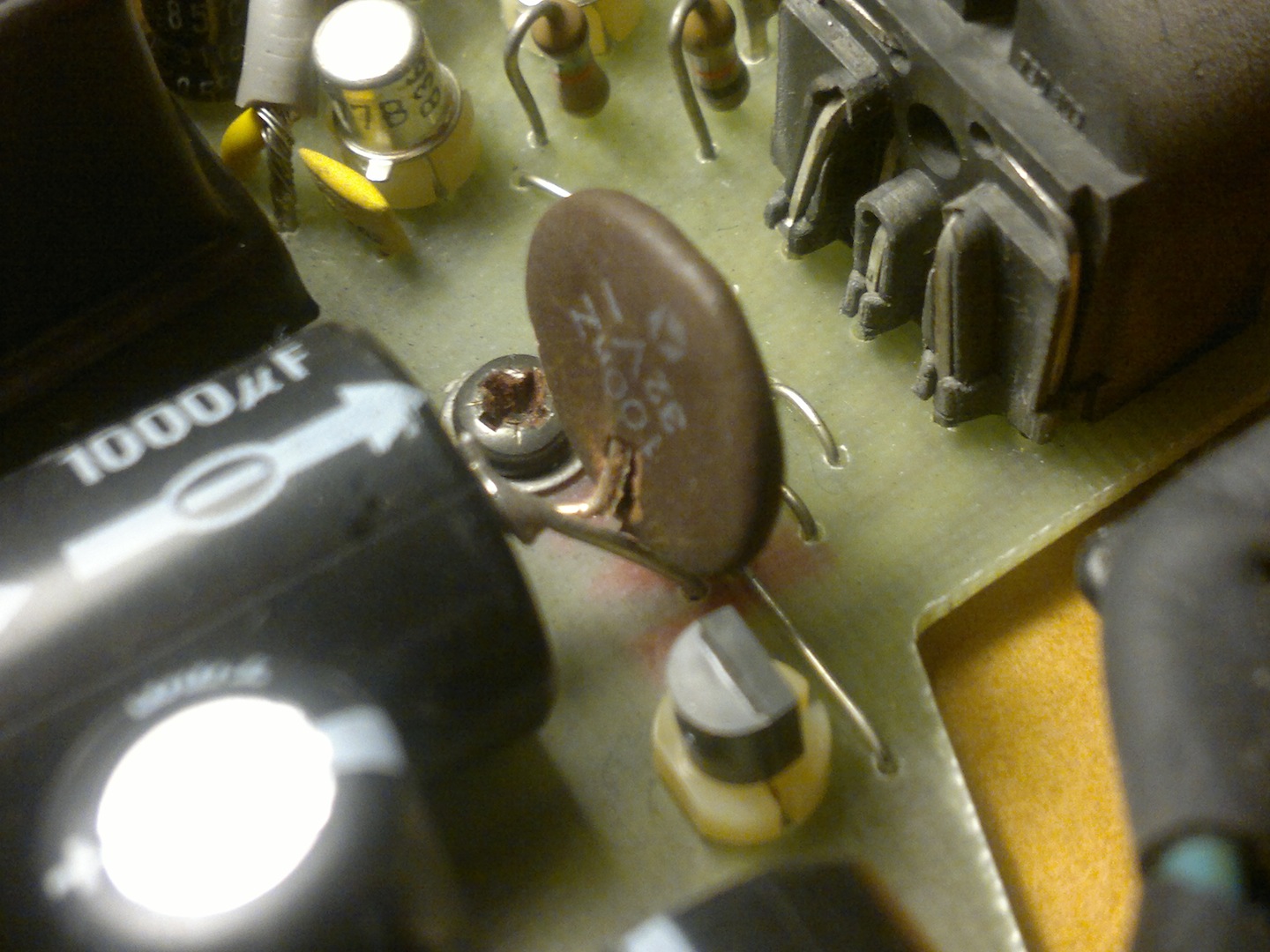

Hi there,
Could I replace this 100n ceramic cap with another type? Will another type like a poly box cap work here?
I cannot find this electrolytic 1000uf capacitor on the schematic, just the 104 25v ceramic marked on the way out to earth and chassic ground
I have put up a picture with the caps marked
So is this model a plain 101 not a 101b? It would be nice to also do the CD Input mod if possible on this model
