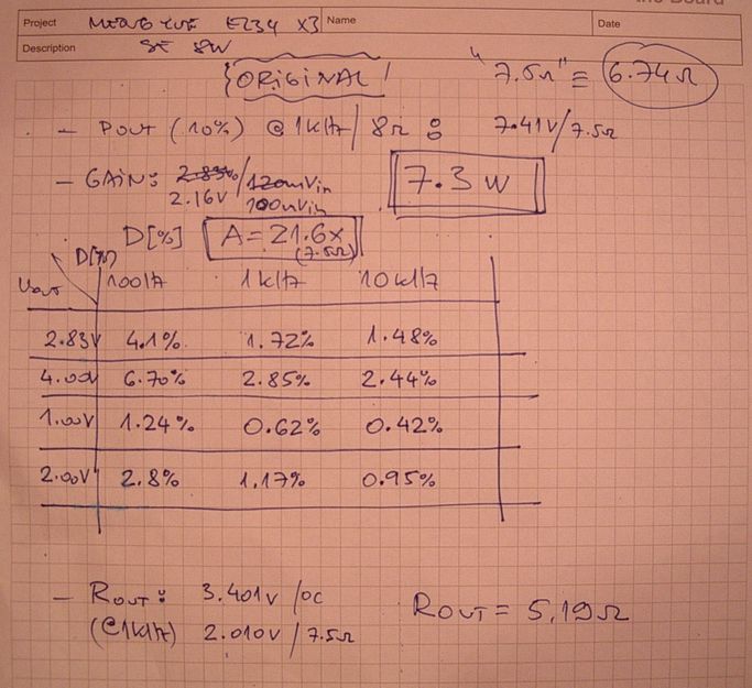

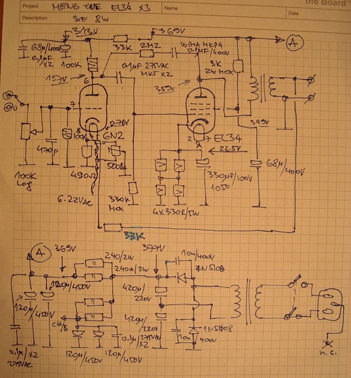

The interesting thing is, the manufacturer was apparently trying to resolve the 'hum' issue, as a newer version of the little 'Headphone SE amp' (I bought it off ebay as 'A-308 EL34 headphone amp' trying to set up a 'reference/unmodified' amp to compare against the hacked/modified version I was working on) had a choke added to the HV under the chassis. Of course the hum was still there 😉
The amp pictured evolved into my 'pet' bedroom amp a few years ago, the guts are basically Mr Padilla's EL34 SE circuit (the page seems to be removed from Angela Instruments, but it may be available in the 'web time machine'), and in fact the amp sounds pretty good to me. The amp measures around 6.5mV hum cold (with the power transformer raised, as pictured, as far as the leads would allow it).
In contrast to this, my 'Meng X3' (after all the mods I mentioned) measures around 2.5mV on the speaker warmed up, 0.0mV cold, so there does not appear to be significant magnetic coupling between the cores.
I was just trying to reassure the OP that, IMHO, a few mV hum on the speaker is not too bad (there are more important things to focus on) and that fiddling with valve amps (after the safety issues have been dealt with) is good fun 🙂
