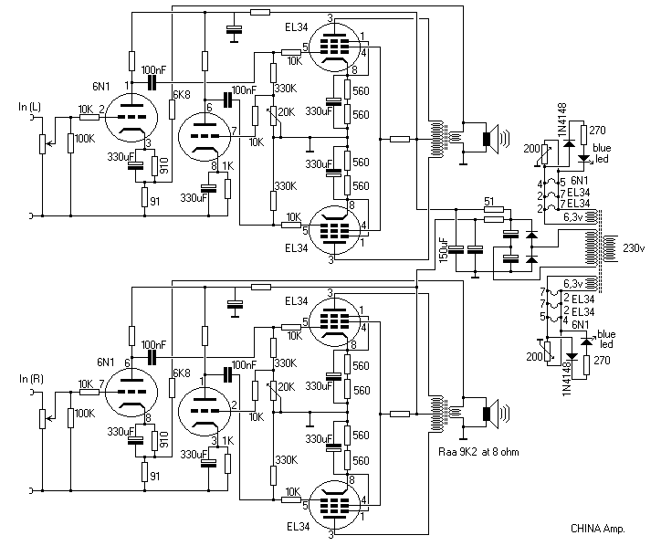

Ooops, thanks Jeff. I do see one on ebay with the 12AX7 engraved on the plate, but the specs state 6N2, so who knows, until you look under the bonnet. I always say there's a new surprise with each and every Chinese amp :) And for me the biggest surprises came from measuring the OPT's. The Meng Yue 6P1P seems to have pretty good OPT's though. If you take the bottom cover off Chops, and take some pics, I can probably find a schem that fits it.

Here's some pics of the amp along with the last 3 photos that can be opened up to full rez images. I hope this helps out on figuring out the schematic for this thing.
The ole' Baldwin pulling double duty as a space heater in the background! :D
Full Rez Images
I found this schem a while back. Changed the power supply a bit and added the single resistor feed to the screen pairs. Some component values are missing and some may be wrong, but the map should be very close if not spot on.

Did yo try the 33nF DC blocking caps (47nf or 100nF is also fine)? These should be in series with the red and black wires coming from the volume pot. A ~250Vac X2 type cap works pretty good here.
Looking at the pictures, the front end tube socket seems to be wired for a 6.3V heater. Perhaps it is best to use the original tubes here as a starting point, and trake it from there.
/Tibor
The PCB does look like it's still wired for 6N2...the Chinese equivalent of 12AX7. A real 12AX7 plugged in would get half the required heater voltage I guess, if that is the case, dunno without measuring heater voltages. Anything could be possible...Is it possible a 12AX7 will function slightly with half heater voltage?
