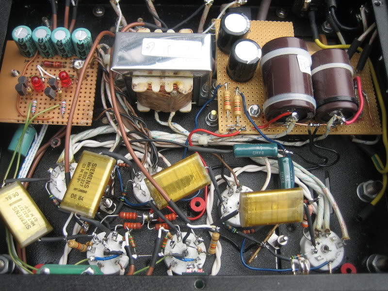

front
underneath
modded PCB
front
underneath
modded PCB
Yes, I should move all the components to the same side of the PCB as well.
I was able to remove the cathode bypass from the first stage with the 6n1 tubes. No way with the 6n2 unless I wanted less than 1 watt full power out.

Hi Gary, I changed the schematic a bit more towards the RLD design. I also ordered some LED's from Farnell to try the LED's on the output tube cathode as per the RLD design , also some voltage regulator parts for the screen grid supply. The RLD also has an RC network on the anode of the first input stage tube for feedback stability, worth a look , might give you some feedback ideas.

The 500R pots are gone. When I went with the voltage tripler to get more B+ at the input valve I had to add the heater bias. It was OK without the tripler at ~75V, but now its 135V at the splitter's cathode. I should have a cap on the voltage divider but hum is not an issue at the moment. Brake light? 🙂 We will see...I am curious about this overload recovery scheme.
