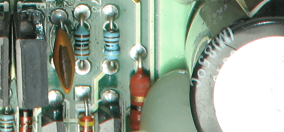

Any schematics for this amplifier?
Amp produces rail +/- 50 Vdc (current limited bench power supply).
~800 mVdc across all speaker terminals.
Relay clicks, output, albeit noisey, on the class D sub channel.
No output on any of the 4 class A/B channels.
The only thing visible I can find is a burnt resistor R797 that I cannot make out the bands, but it reads 31k in circuit, (see pic).
One leg R797 goes to C726 0.1 uF ceramic disk capacitor that goes to ground.
The other leg R797 goes to C728 0.1 uF that goes to ground. The other way off the same leg of R797 terminates on the top layer of the board and I assuming goes somewhere else, although I have not been able to find what other component it connects to.
From your pic it looks possibly RRBG 22 ohm?
Mine, the first band looks pink, I guess it is red, I would have guessed the second band is white (but I don't know) the third band I can't tell, but if its black like in the picture you have it would be a 22 to 29 ohm. Mine is reading 31K.

If you have the tutorial, you have this series of photos.
I don't have a diagram and don't know how it's connected. It's odd to have only one in the amp but I don't see any others, either.
It appears to be 22 ohms.
I'd replace this resistor first then see if the amp produces audio on the 4 channels.

I tried 8 pcs 1/4 watt 180 ohm resistor in parallel for 2 watt 22.5 ohms and they smoked immediately.
Earlier I was able to tell that one side of R797 also goes to the collector of the C1027 driver transistors and I think the other side may go to the rail caps. Not sure about the connection to the rail cap but that is where the trace disappears. On that side of R797 there is 36 Vdc.
While amp was current limited with a headlamp in series the resistor got to hot to touch within seconds. With the current limiter removed the amp is drawing 6.8 amps and the resistor burns immediately.
There was no audio output either way.

It could be a driver supply. Does the end that you believe connects to the rail read 0 ohms to the tabs of the high-side output transistors?

The one leg I thought may have gone to the rail, connects to a small green inductor at the base of the power supply vertical board, not sure right now where it goes from there as I will have to remove that vertical board which unfortunately like everything else on this board is under mounds of silicon . It has 39Vdc on it while the rail is +/- 49Vdc.
What I did find is C728 is reading a short to ground. This is on the side of that resistor that connects to the collectors of the C1027s.

What's supplying voltage to the resistor that burned?
If all outputs are N-channel, the high-side drive will need a voltage greater than rail voltage for the output to work efficiently. Do the outputs fed by that resistor drive the high-side output FETs?

I have found that it goes to that small axial 47uH inductor then to the cathode of D722 (39Vdc) then anode(30Vdc) is connected to cathode of D723 which is also connected to a 100V 10uf electrolytic (+) then the (-) to the non-inverting speaker terminals.
The resistor is connected to the collector of the C1027 and the emitter of the C1027 is connected the gate of the IRFP150A. This is the same for both output FETs in each channel.
Also the power supply is producing +/- 49V rails, but output FETs have ~+/- 22Vdc on them.
Single strand of wire off of transformer has 19Vpp ac square wave goes to (-) side C724.
(+) C724 has 19Vpp ac square wave centered on +30Vdc . this connects to anode of D722.
Cathode D722 39Vdc goes to R797 through 47uH axial inductor.
With remote disconnected D722 has anode (+ 26Vdc) and cathode has (+ 32Vdc).

That sounds like a doubler circuit. Are you possibly not seeing diodes like D7 or D10 in the attached diagram? Those force the output voltage above the rail voltage (needed for driver supply voltage)?

That would make sense. This is a 4 channel class AB with 1 channel class D sub channel. This type of amplifier is completely new to me.
The capacitor C728 0.1uF ceramic disk referenced in #1 and #11 is connected to the output of R797 and appears/reads shorted to ground.

From looking around, yes it looks like a doubler circuit.
With the cap removed the output of R797 is still shorted to speaker ground.
The cap tests good out of the circuit.
