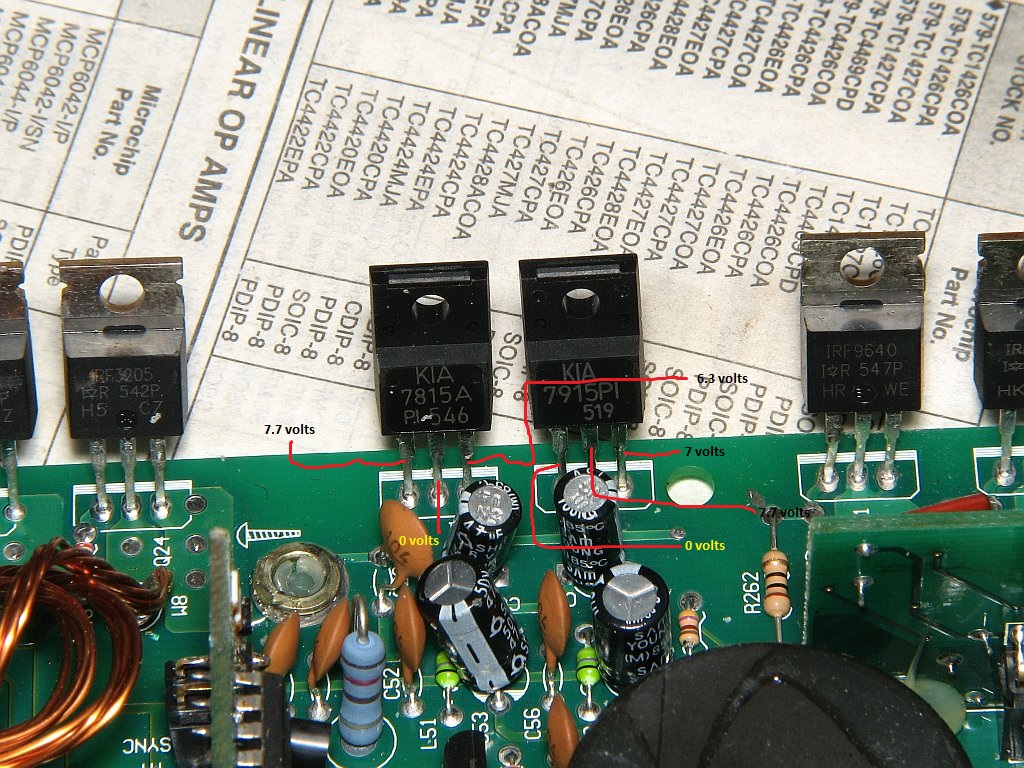

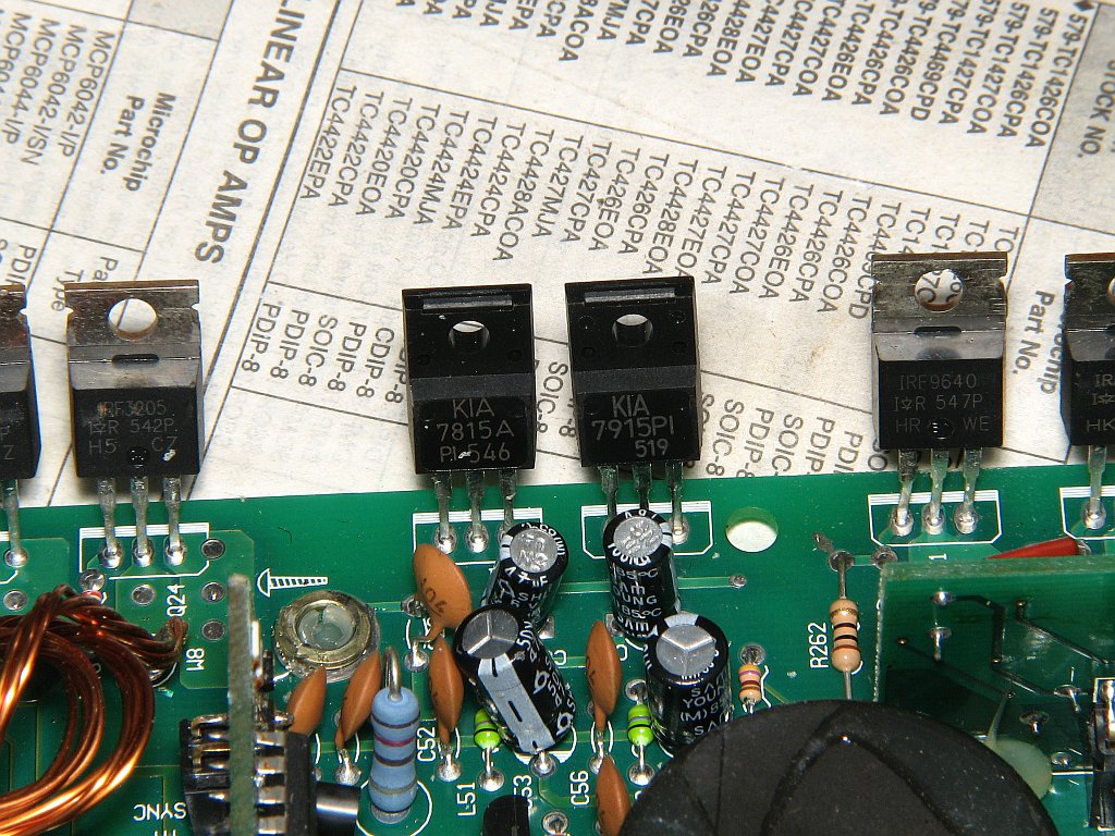

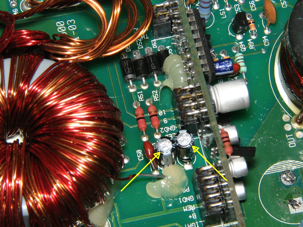

P Perry Babin Member Joined 2003 bcae1.com 2015-03-02 11:26 pm #21 2015-03-02 11:26 pm #21 Post the DC voltage on both voltage regulators. ••• More options Share E Exbass17 Member Joined 2012 2015-03-03 12:03 am #22 2015-03-03 12:03 am #22 Yellow coils? where are those located? ••• More options Share P Perry Babin Member Joined 2003 bcae1.com 2015-03-03 12:27 am #23 2015-03-03 12:27 am #23 7815 and 7915 Attachments IMG_0636x.jpg 250.8 KB · Views: 57 ••• More options Share E Exbass17 Member Joined 2012 2015-03-03 12:39 am #24 2015-03-03 12:39 am #24 How is that probed Perry the voltage is different if probing with + input and - input of amp the main amps power terminals that is ••• More options Share P Perry Babin Member Joined 2003 bcae1.com 2015-03-03 12:45 am #25 2015-03-03 12:45 am #25 Black probe on secondary center-tap of transformer (terminals probably marked 6 and 7). Probe pins left to right on each regulator. ••• More options Share E Exbass17 Member Joined 2012 2015-03-03 12:57 am #26 2015-03-03 12:57 am #26 heres my results with the black probed on #6 center tap of transformer Attachments 469279d1425342461-memphis-16-mcd1000-2-img_0636x.jpg 364.8 KB · Views: 50 ••• More options Share E Exbass17 Member Joined 2012 2015-03-03 1:02 am #27 2015-03-03 1:02 am #27 Also thinking about it this wouldn't have anything to do with me changing the gate resistors on the PS Fets would it I upgraded them to 47ohm ••• More options Share P Perry Babin Member Joined 2003 bcae1.com 2015-03-03 1:14 am #28 2015-03-03 1:14 am #28 The input voltage is too low. If the two resistors in series (R51 and R52) are withing tolerance, replace C51 and C55 (? not sure of the designations, see attached). Attachments IMG_0637x.jpg 217.8 KB · Views: 58 ••• More options Share E Exbass17 Member Joined 2012 2015-03-03 1:19 am #29 2015-03-03 1:19 am #29 R51 = 23.9 ohm R52 = 24 ohm ••• More options Share P Perry Babin Member Joined 2003 bcae1.com 2015-03-03 1:32 am #30 2015-03-03 1:32 am #30 That's close enough. Try replacing the capacitors. If you have 33uf caps (at least 35v), use them. ••• More options Share E Exbass17 Member Joined 2012 2015-03-03 1:37 am #31 2015-03-03 1:37 am #31 those caps on my board are 25v 10uf which I have 2 of them ••• More options Share E Exbass17 Member Joined 2012 2015-03-03 1:42 am #32 2015-03-03 1:42 am #32 33uf 35v I don't have I would have to get some I have 50v 10uf ••• More options Share P Perry Babin Member Joined 2003 bcae1.com 2015-03-03 2:04 am #33 2015-03-03 2:04 am #33 You can use the ones you have. ••• More options Share E Exbass17 Member Joined 2012 2015-03-03 2:15 am #34 2015-03-03 2:15 am #34 I have alittle sound going through the speaker but still muffled and distorted ••• More options Share P Perry Babin Member Joined 2003 bcae1.com 2015-03-03 2:17 am #35 2015-03-03 2:17 am #35 Did the voltage on the regulators come up? You should have about ±20v on the input pins. ••• More options Share E Exbass17 Member Joined 2012 2015-03-03 2:20 am #36 2015-03-03 2:20 am #36 still in the 7 volt range ••• More options Share P Perry Babin Member Joined 2003 bcae1.com 2015-03-03 2:21 am #37 2015-03-03 2:21 am #37 What's the DC voltage at the power/ground terminals of the amp? ••• More options Share E Exbass17 Member Joined 2012 2015-03-03 2:24 am #38 2015-03-03 2:24 am #38 .20 volts less then my power supply is supplying 12.01 ••• More options Share P Perry Babin Member Joined 2003 bcae1.com 2015-03-03 2:28 am #39 2015-03-03 2:28 am #39 What is the AC (not DC) voltage measured directly across the terminals of each of the caps you just replaced? What is the greatest positive and negative DC voltage on the diodes D51-54. ••• More options Share E Exbass17 Member Joined 2012 2015-03-03 2:37 am #40 2015-03-03 2:37 am #40 16.22v 7.93v Capacitors are 1.17 ac volts ••• More options Share Prev 1 2 3 Next First Prev 2 of 3 Go to page Go Next Last Show hidden low quality content Status This old topic is closed. If you want to reopen this topic, contact a moderator using the "Report Post" button. Share: Facebook Twitter Reddit Pinterest Tumblr WhatsApp Email Share Link Home General Interest Car Audio Memphis 16-MCD1000 (2) Top Bottom
