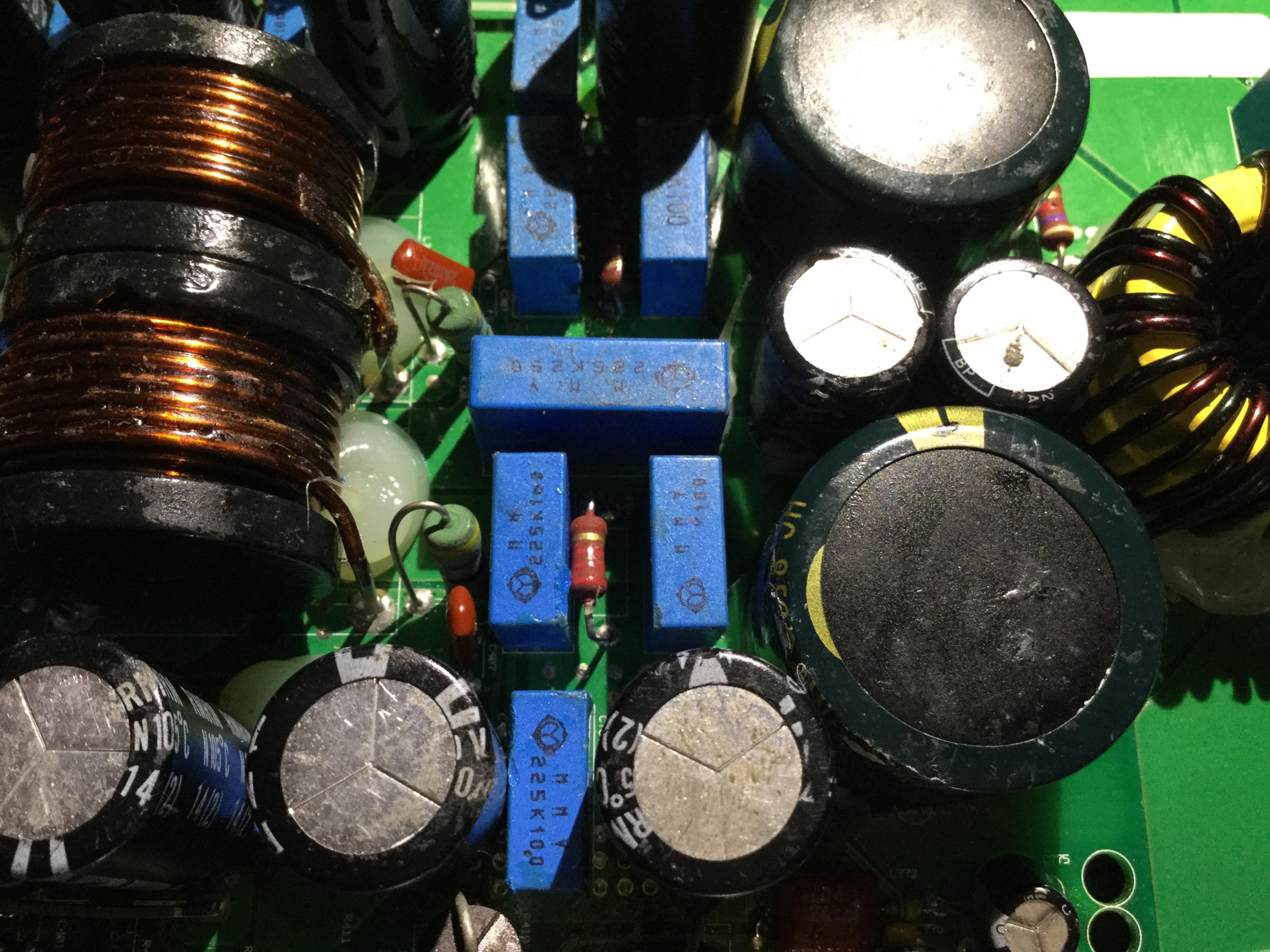

I ran the amp out of the heat sink and none of the FETs get even slightly warm. As the amp switches in and out of protection, there is a synchronized pulsing noise coming from the center of the amplifier, see attached image....
I'm using a sound generator app on my iPad to apply audio through the RCA jacks. As I lower and raise the Hz Output, the "frog" like noise changes too, lower and higher in pitch based on the lower or higher Hz I select.
I hope this makes since. I tried to track down where the noise is emitting from but I can't pin point the exact component. Don't know if this is any help with tracking down the issue or not?

Are you seeing a pulsing (or steady) rail-rail oscillation on the center legs of the output transistors?
It's pulsing, it reads approx. +/-56 DC volts and it drops and rises ~5V when switching in and out of protection.
When I lower the volume to zero, the amp comes out of protection and all of my readings appear to be normal, except the positive and negative DC volt difference on the op-amps.
