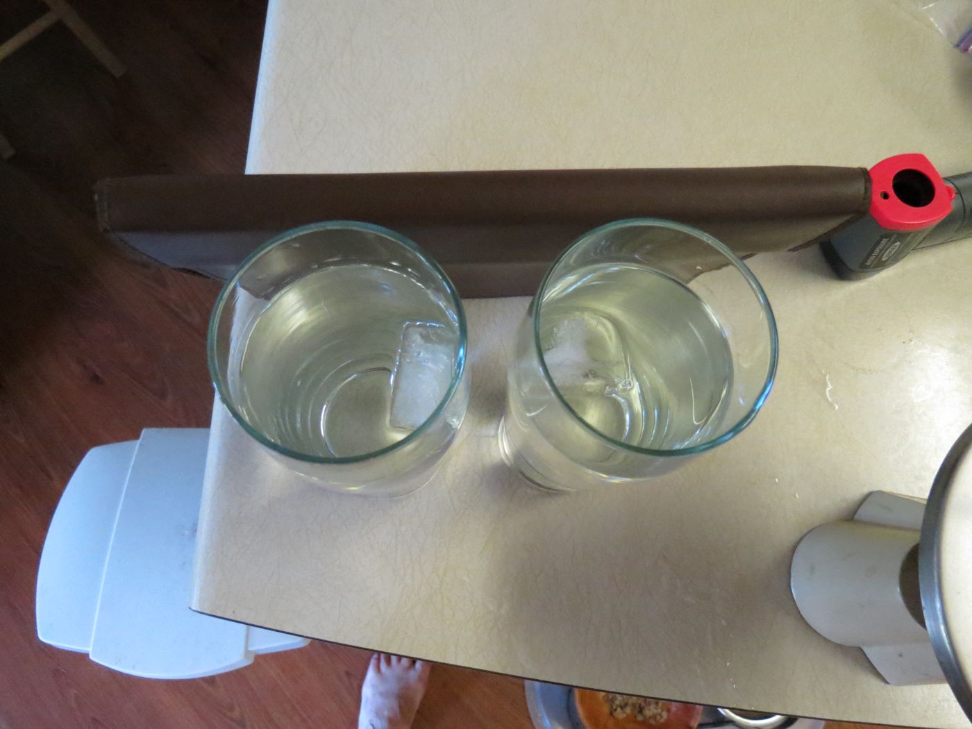

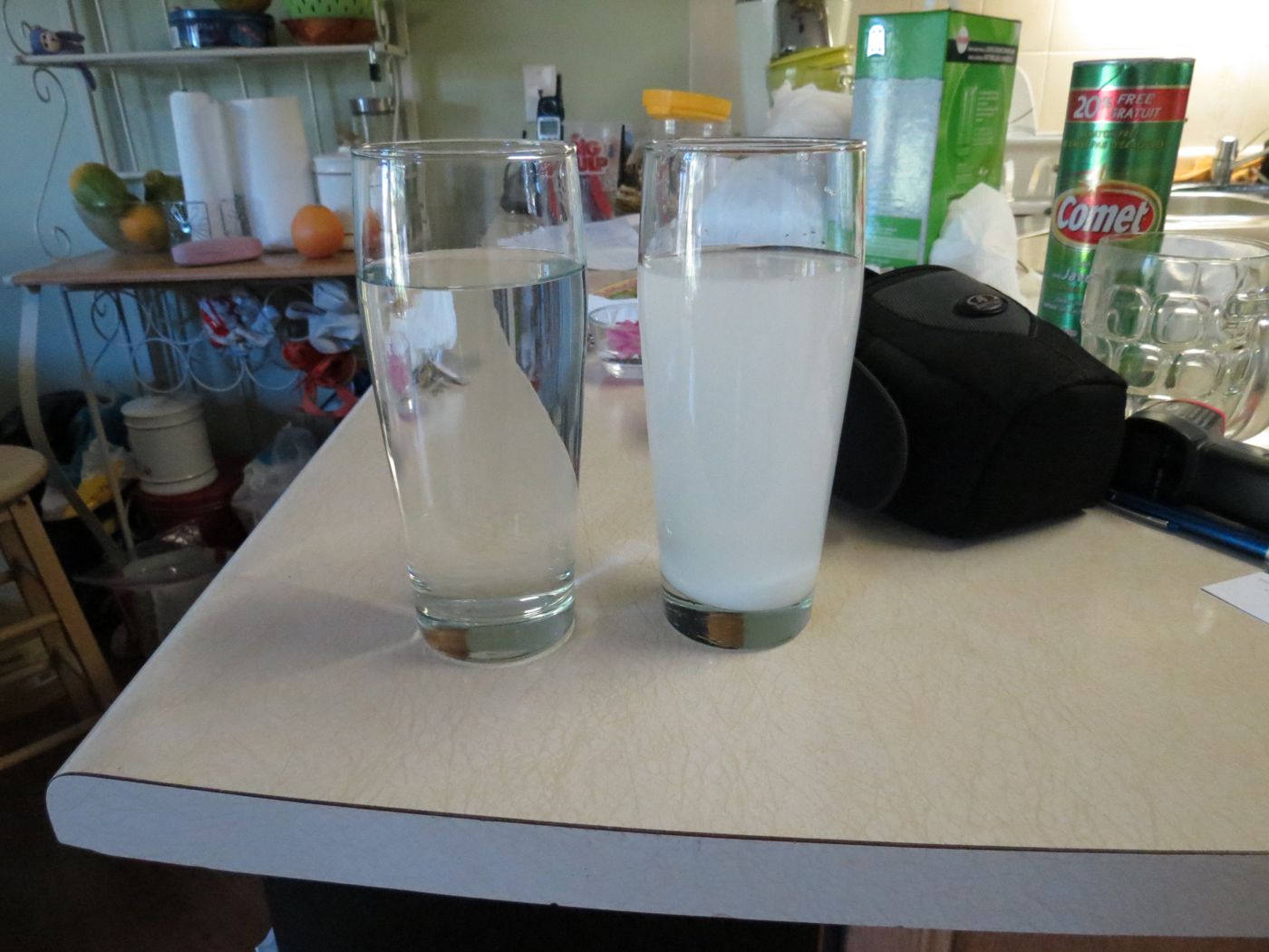

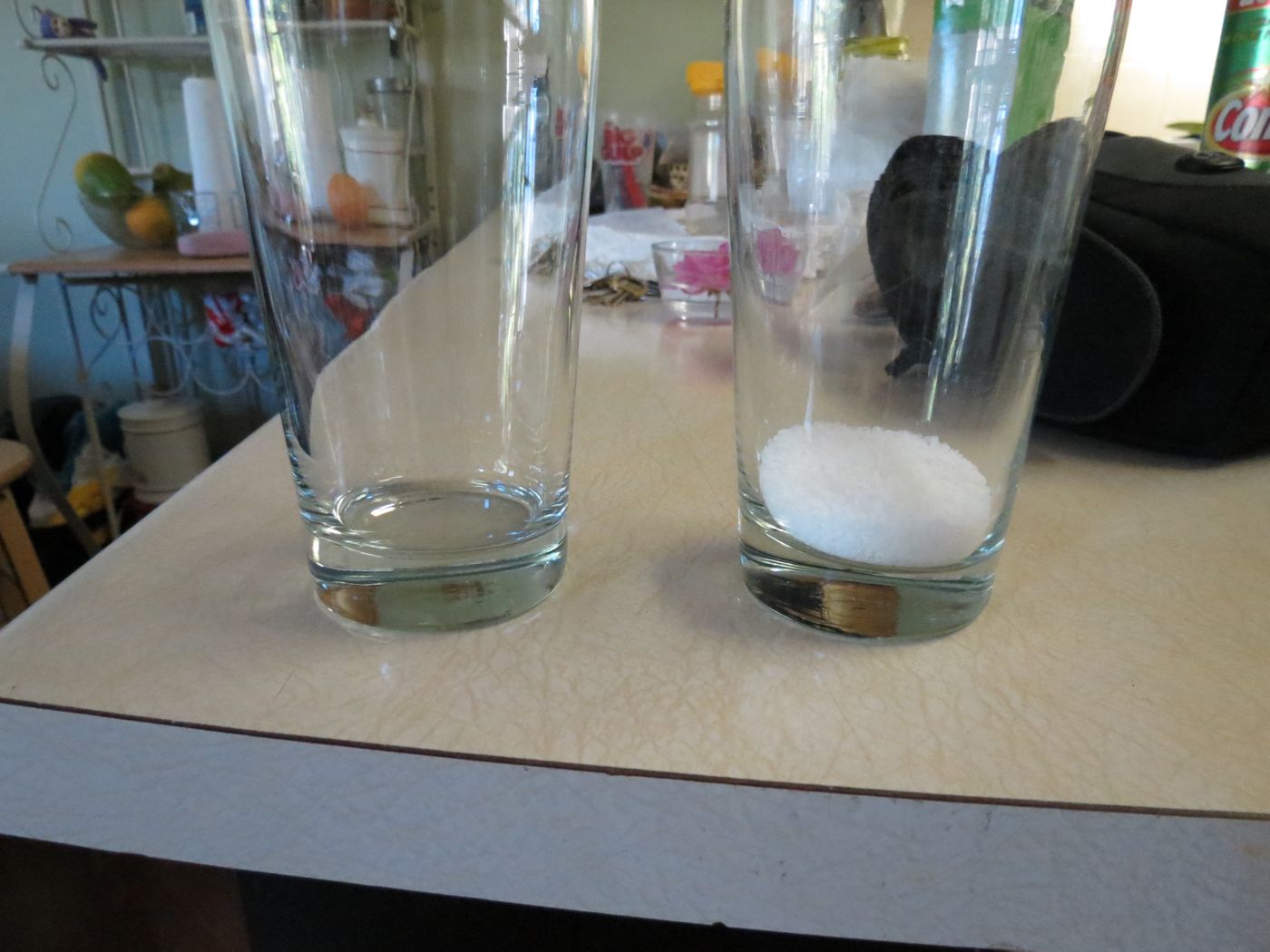

I know the specific heat of salt water is lower than fresh, don't know if that affects the heat transfer, but my gut says it would. Less energy to cool down the salt water near the cube means slower melting. On the other hand, specific heat is per mass, and salt water is heavier so a volume of each May have the same heat capacity.

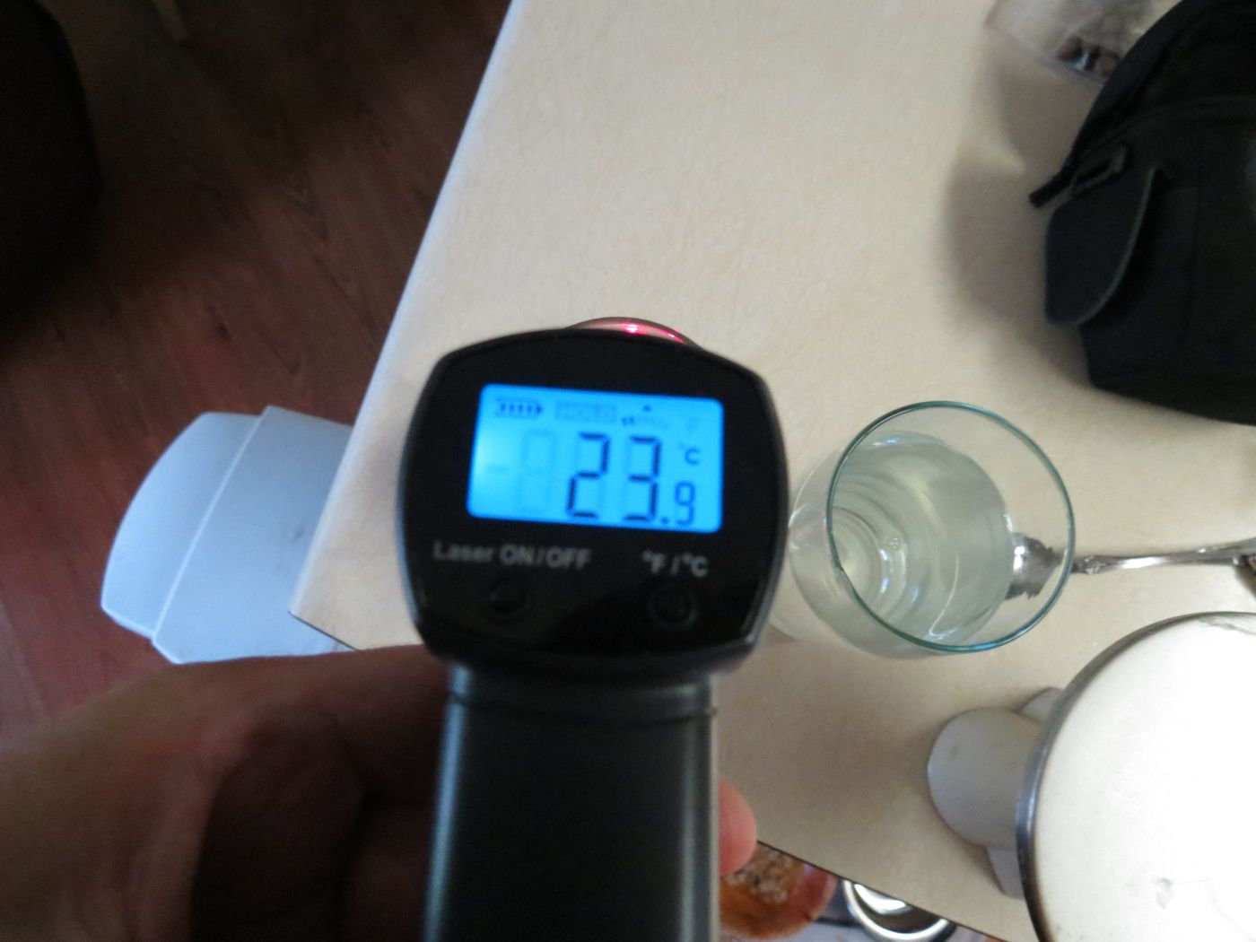

One interesting thing has shown up already. The glass with the salt now dissolved is a lower temperature than the fresh even though the room is warmer than both so I will wait till they equalize.

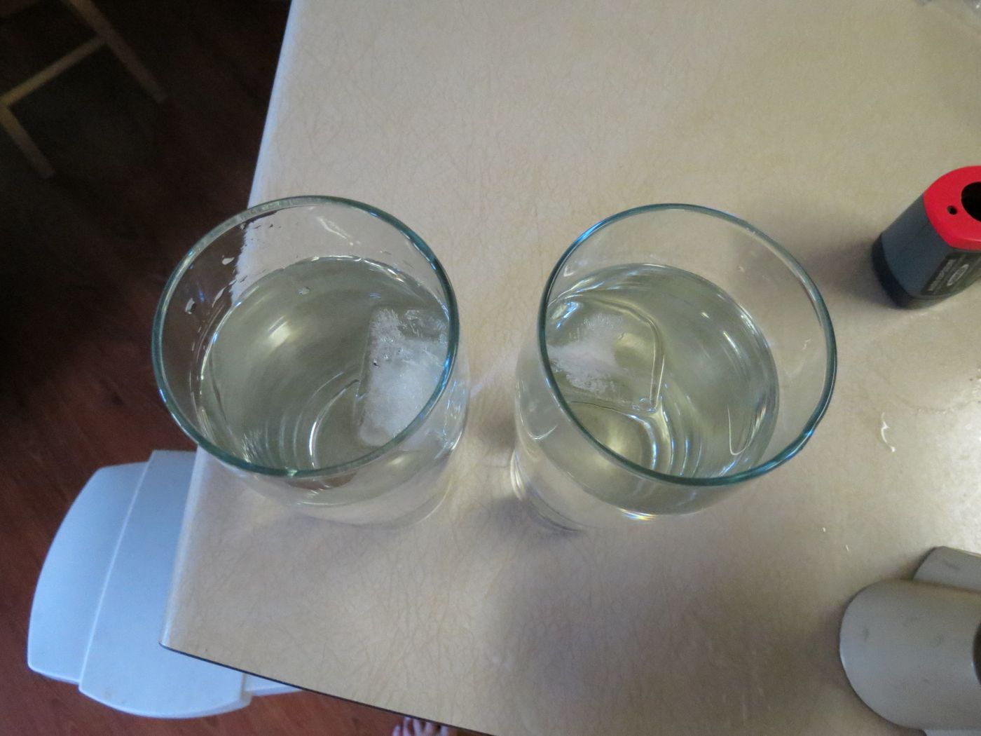

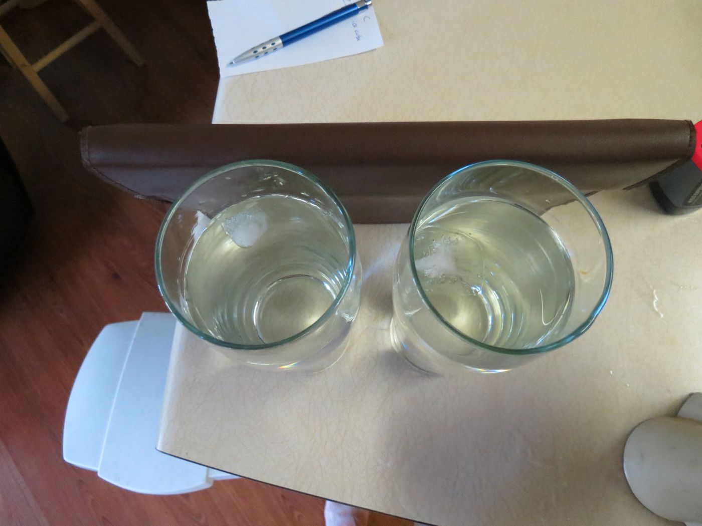

Since salt water is more dense, the ice cube will float higher, exposing less surface to the water, reducing heat transfer.
Agreed, but will this reduce heat transfer? when the fresh water cube melts, it gives up fresh water obviously, and this very cold water will tend to stay confined near the surface, in the immediate vicinity of the cube, because it is lighter than brine and therefore cannot sink and promote convection.
This will create a cold, relatively insulating layer or shell within the liquid.
On the other hand, the emerged part of the cube will be exposed to the air, and there will be some convection (or inverse convection) acting.
If the container is not filled up to the rim, there will also be some similar blockage, when all the available space has been filled by chilled air, but if it is filled to the rim or thereabout, the process will continue and inject heat into the cube.... some more parameters to consider
One interesting thing has shown up already. The glass with the salt now dissolved is a lower temperature than the fresh even though the room is warmer so I will have to wait till they equalize.
since salt lowers the melting point (E.g. the "phase change" thus exists at a lower temp ) energy needs to be released (edit absorbed in this case). and feels colder.
look up 'phase change' solid to a liquid in this case
I didn't look anything up I just remembered this from school and why salt is added to ice cream making devices
Thermal conductivity of water and saline is about the same, so the first instinct is to think the cube should melt at the same rate. And, if the liquid was moving in a flow past the cube the rate would be the same. However, in a glass, the molten ice has two properties: 1 it is colder than surrounding fluid 2 it has lower density than saline. So how fast the molten ice water leaves the vicinity of the cube after it has melted depends on its relative density versus fresh water at room temperature, and versus saline. In the case of fresh water it sinks, in the case of saline it floats. Therefore the thermal gradient within the fluid of the glass is different, and heat flow out of the ice cube is greater in the case of fresh water, so it melts faster. Ta da.
