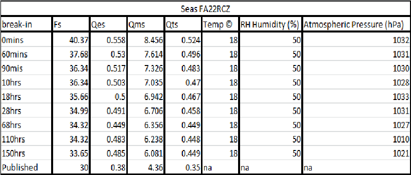

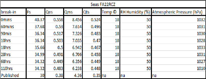

Seas Break In
One Seas FA22RCZ was broken in using 10Vpk Sine Wave swept from 30Hz to 45Hz.
Looks like things have stabilised. I will give it another 24hrs to be sure.
Once I have built up the baffle I will see if I can hear the difference between the broken-in driver and a new one out of the box.
Hopefully have all the wood cut by tomorrow.
Then repeat the break in process for the new one.
What are you using to do the T/S measurements? I've always used Speaker Workshop, but recently measured some new 4" drivers and the FS (and other params) were way off. I ended up trying with REW and got completely different results that were very close to manufactures specs.
I'll have to measure the impedance of my tweeters again. I'd always been a bit disappointed that their fs seemed to be about 200Hz higher than it should have been. I suspect that SW gives inaccurate results for speakers with very light diaphragms.
Tony.
I have my own program at work that was done in Matlab, but I am using Dayton DATS at home, so people can easily compare results if they have the same gear.
Edit: The TS Parameters change significantly with signal strength, and the drivers need to be broken in.
I need to check what the output is on the Dayton gear

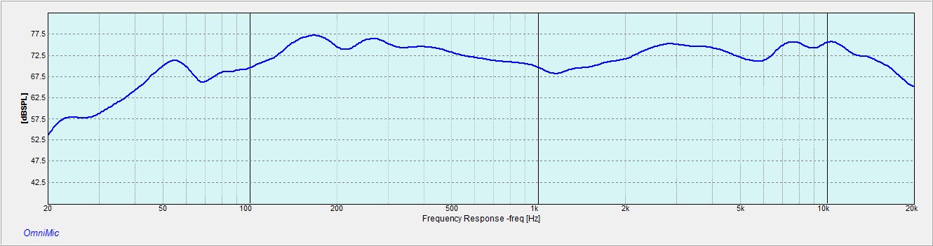

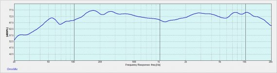

Frequency plot of Seas on 1m baffle. I will turn it around and see what the difference is.
EDIT: The baffle is 1 m wide x 80 cm tall with 20 cm wings.
The centre of the speaker is 17cm above ground height
