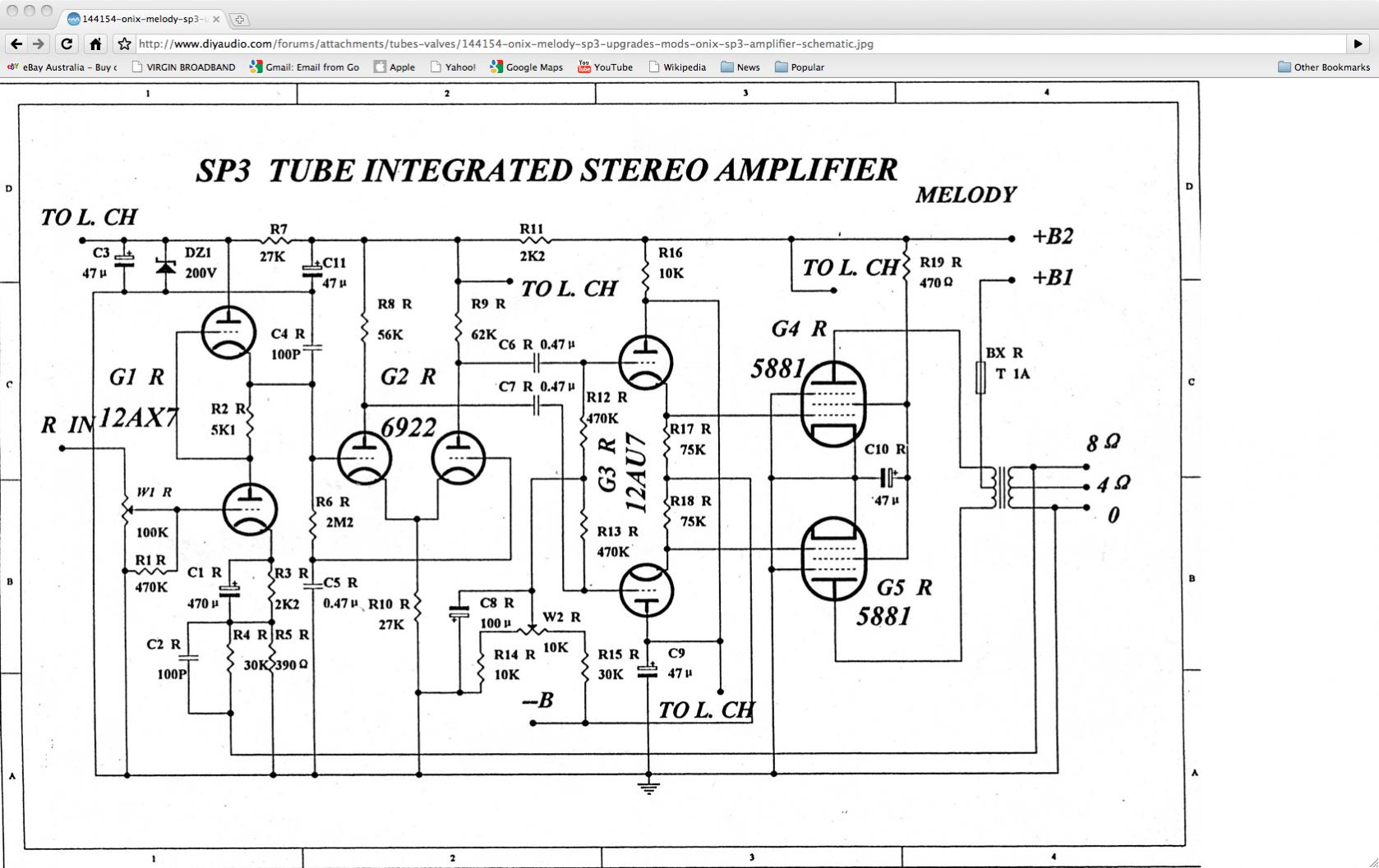

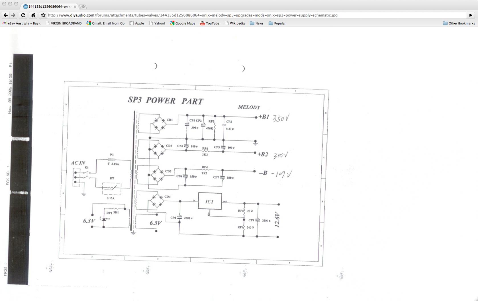

I tracked down schematics for the SP3, does this help in answering my question about correct bias for 6l6GC power tubes? I'm still running them at factory 1.15V. I've also included an interior image.
Nice amp, looks like Russian made. But I did not see where you can measure bias and get 1.25V voltage. Are you sure it is this amp's schematic?
It's chinese, branded Australian. I'm pretty sure this is the amps schematic, not a schematic kind of guy so I'm relying on my source and the title printed on schematic! You can measure the cathode bias via probe holes, four in all, on left and right side of amp, just in front of the vents, you can see this in the interior photo. How this corresponds to schematic I don't know.

Schematic Melody SP3 MK2 + power supply
Help! I have a Melody SP3 Mk2. And as I was going over my files, it turns out I may have the schema for the Mk2---it includes the bias circuits 2/channel.
Here is my problem. My SP3 toasted a rather large 470 ohm resistor (5watt?) which appears to be R19 in the attached schema. Since it is close to the 5881 tubes ( in the pictures posted by another member, its opposite the vol. control closer to the power transformers) I took out the power tubes first thinking its a shorted tube although the 33 ohm resistors grounding the cathodes seem fine. I found 470 5watt in my junk box so I soldered that in. Without the tubes, I turned on the power. Instantly, that 470 got got fried. Does anyone have any suggestions on what to look into, before I take it to a more knowledgeable tech. Thank you very much for any suggestions

Problem with Melody SP3, mk2
My SP3 toasted a rather large 470 ohm resistor (5watt?) which appears to be R19 in the attached schema. Since it is close to the 5881 tubes ( in the pictures posted by another member, its opposite the vol. control closer to the power transformers) I took out the power tubes first thinking its a shorted tube although the 33 ohm resistors grounding the cathodes seem fine. I could only find a 470 5watt in my junk box so I soldered that in. Without the tubes, I turned on the power. Instantly, that 470 5watt got fried. Does anyone have any suggestions on what to look into, before I take it to a more knowledgeable tech. Thank you very much for any suggestions
I am attaching the Schematic for the Melody SP3 Mk2
Thank you Alan4411. Let me figure out which one it is. Therre are 5 47uf caps in that in the area, and none of them are showing distress. Will post on results later.
Thank you PRR. Locating components on the SP3 aside from the more obvious ones are a PIA very crowded plus printed circuit board I have vintage fishers that I refurbished. In comparison, it was super easy to ID components since it is point to point wired, and all I had to do was start at a known point, eg., power tube pin, and trace from there. PC boards, esp double sided are the worse. Its enough for me to just junk the SP3, or rebuild using P to P. Problem is, while the schematic shows components of R-Cs it does not show ratings, eg., watts or volts. so one cannot even begin to source parts. One might be able to figure out some capacitors since they are labeled. but those red chinese resistors only have printed r value, no ratings. For now I will store the SP3 in garage so I don't have to look at it. I have enough vintage amps, a fisher x-101-c, a 500c where I pulled out all the tuner related tubes and just using it as a big brother amp to the x-101-c, plus a VTA moded Dynaco ST70. If anything goes wrong, easy to fix by slinging solder, and thanks to the expertise and experience of members here at DIY Audio. Thank you all!
