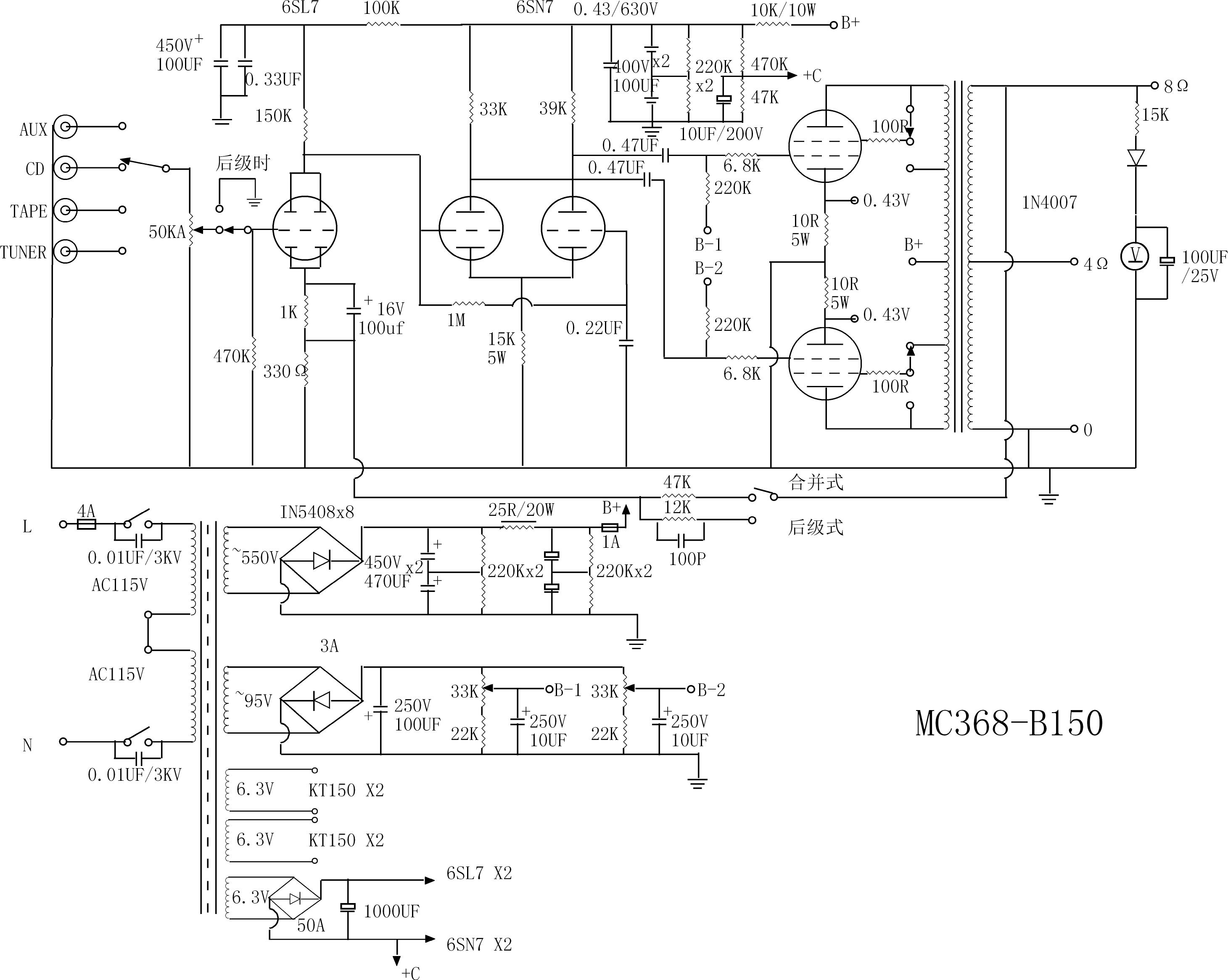

Schematic for the mingda
Been awhile since ive replied mean no disrespect also have enclosed a schematic from mingda for anyone who needs it also been running this amp at 123 vac all year amp doing fine just put a new set of kt 150's, 6sn7's and 6sl7's as i put a lot of hrs. on it. also added 1 amp slow blow fuse on ac side of b+ winding of power transformer between transformer and rectifier. you will notice on schematic its on the dc b+. mine did not have one and i experimented with a fuse there and it blows pretty easy. better to put it were i have it now at ac winding of B+ before rectifier. 6sl7 and 6sn7 heaters are elevated the kt150's are not. i put bourns trimmer pots for bias the ones mingda puts in are kind of squirly. kind of a pain to bias this amp as it has extremely high B+ IN the chassis and you will have to open it lean on its side i use a 2X4 under the right side transformers to prop up so it doesn't fall.

That amp is not suitably designed for the KT-150 and you may find that the tubes destroy themselves from the high grid leak resistance. The 220K grid leak resistors need to be brought down to the value specified in the datasheets, and likely the coupling caps should be adjusted to maintain the same time constants.
ok fixed bias limit 51kohm for the KT150 i calculate a time constant of 103.4ms with the values in the amp (coupling cap X grid leak resistor) to reduce the grid leak resistor to say 50k that gives me roughly a 2uF coupling cap im assuming which should be fine to couple the input signal though a little large. does this seem right or am i missing something here. I'm not exactly a vacuum tube expert any info appreciated I would like to fix this right. Thanks

Hi The input tubes i am using are JJ brand 6SL7 and the phase splitters are electro harmonix 6SN7. I also have not made any more modification to the amp. I contacted Ming DA and they had advised against adjusting grid leak resistors. I do use my amp a good bit and it works fine im not too worried about it at this time. When i first got the amp I listened to it a lot. Now i listen to my Yaqin mc-100b more often as im driving a smaller set of speakers at normal listening volume. The mingda is quite powerful and The speakers I have on them are quite sensitive and are loud at the initial volume the amp will set itself to and finding i have to turn it down after it warms up. Also the JJ and electro-harmonix tube sound really good to me. One of the onion shaped ps vane 6sn7's that came with the amp originally became microphonic. So i changed them and the preamp tubes. I use electro harmonix tubes in my Yaqin amp as well and quite pleased with the performance as well as the price. I have tried several different tubes in the Yaqin and find electro harmonix and jj tubes to be the best bang for the buck. I do also use PS vane hifi KT88's which are pretty decent as well. The KT150 are pretty expensive as I have already bought a new matched set for the mingda. but the old ones were fine even with a lot of hrs. on them.
