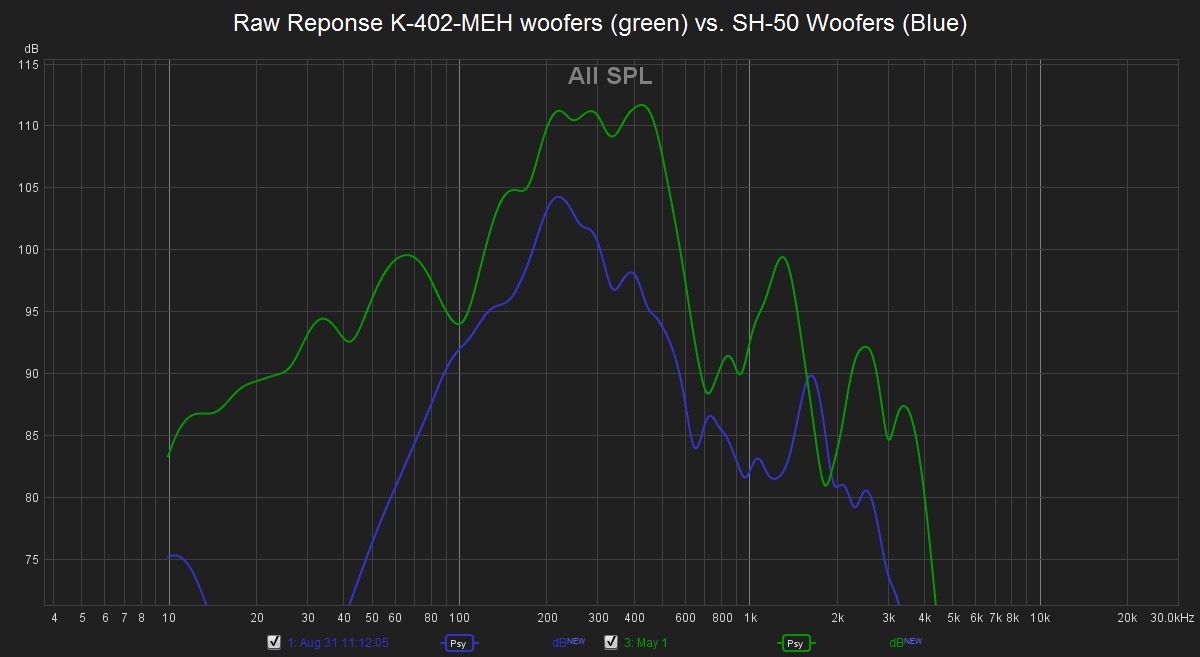

What is "first notch frequency"?
Well, that information is actually in both Danley patents (6411718 and 8284976) and the third-party PDF file that was posted here from Facebook. In a nutshell, since the lower frequency drivers in an MEH are not at the horn throat entrance, there will be a frequency at with cancellation occurs for each of the drivers that are off the central axis of the horn (the "off-axis" ports. The corresponds to a 1/4 wavelength distance from the off-axis post location(s) to the throat of the horn. This determines the upper limit of the lower frequency driver (mostly...) and is a major design point in an MEH design--i.e., where do you put the off-axis ports?
Here is a plot of the K-402-MEH woofers and the Danley SH-50 (series 2) woofer port raw response--no EQ is used, showing in the case of the K-402-MEH the two notch frequencies (~720 Hz and 1900 Hz), and the notch frequencies of the SH-50 (650 Hz, ~1300 Hz):

I do have to place EQ notches at ~1200 and ~2300 Hz to attenuate the two higher response peaks above the first and second notch frequencies, respectively. Those two PEQs in the woofer output channels were the only "extras" that I had to deal with besides the relatively simple attenuating PEQs for the woofer's peaking response (IIRC, it takes only two PEQs to flatten the woofer response to ±1.5 dB above 100 Hz,

Read US8284976. It provides an answer. However, I found that it didn't apply in the case of the K-402-MEH.so what's the benefit in crossing below the notch frequency in the patented Synergy?
I suspect that the narrow SH-50 using a 1" compression driver and relatively deep woofer ports from the horn mouth probably had a detrimental effect on phase and group delay flatness through the first notch frequency. Higher order crossover filters are not used in Danley's SH-50, but there are quite a few notch filters (EQing peaks flat) in the crossover network.just the ability to use a "nth order" XO with passive components instead of active multi-channel?
The SH-50 is actually a good example of a "phase link" design. The four midrange drivers cover just over an octave of passband.

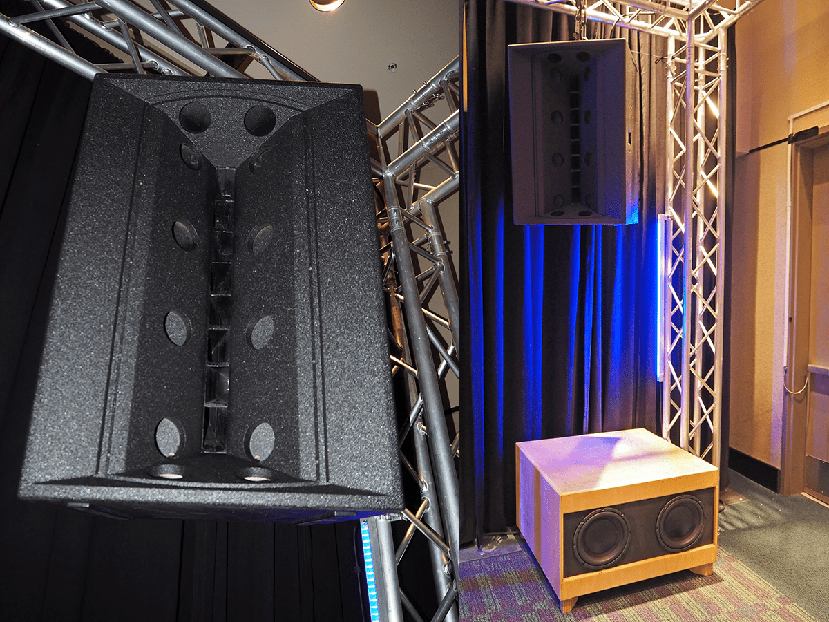

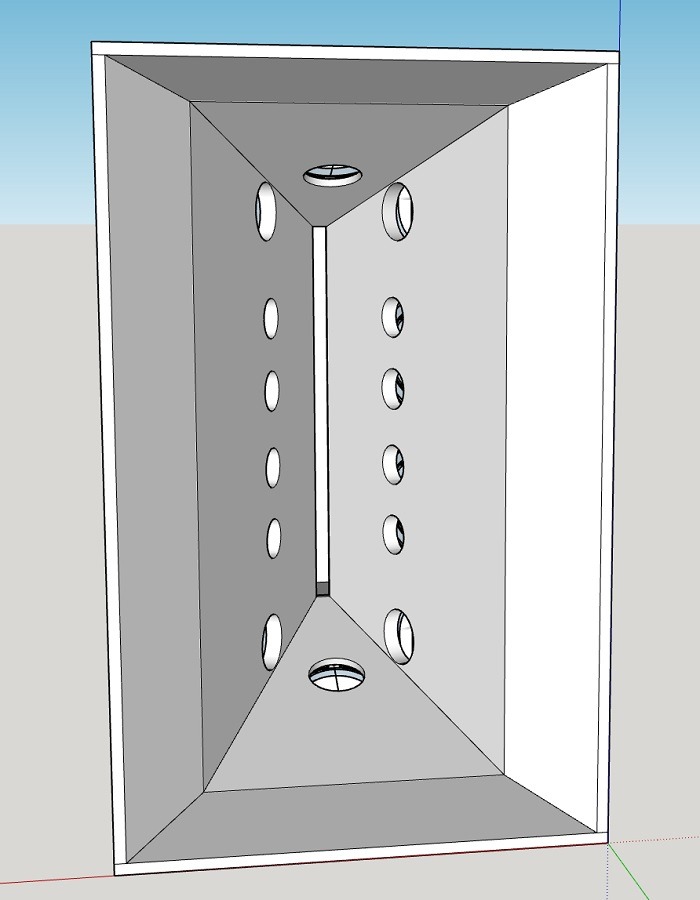

Any thoughts on the angle of the J7 horns and why they alternative directions? I guess how is summation achieved if they're shooting different directions? I would Assume it's 45 degrees each way since it's a 90 degrees box and then it appears that the center two point straight out, whereas the top and bottom three angle up and down, respectively.forgot this post has details on the J7 tweeter array its not super complicated to fabricate just conical horns alternating left and right and arranged with the curvature expected of a conical horn at that depth in the larger horn: https://www.diyaudio.com/community/threads/constant-curvature-tweeter-array.388439/#post-7149222
you can see the directions the conical horns are facing well in this picture.
I can think of a number of ways to argue against the idea of it working that way. Unless I see otherwise I'm inclined to guess the first reason is so they can fit in the available vertical space.

Good observations. When I first saw the J7, I was like, wow this is really different from the synergy line.... the SH50, 90x60, etc.Without seeing this thread i too somehow independently drew up an almost identical design recently even down to the same drivers and waveguide, i think the appeal comes from looking at the recent J7 & J8 boxes (J8 just being a taller/bigger version from what i can see) and the output and density being very desirable.
However, the more i look into this i have noticed the J7 is the least similar synergy horn danley has made yet far and appears to deviate surprisingly far from their original design philosophy. The magical paraline/horn combiner they have had multiple iterations of in the past appears to be gone and appears to now be two tightly packed rows of compression drivers attached to standard waveguides shooting in alternating directions which seems contradictory to keeping the acoustic masses close for better coupling. The midbass drivers are no longer mounted on the walls bandpass 4/6 style as in most (all?) previous synergy designs, and now appears to be some kind of tapped horn with a small outlet that just happens to be a round hole similar in appearance to the older designs but acoustically has nothing in common. I saw a pretty good picture somewhere on this site that showed it but am struggling to find it again, will update if i can find it.
To me, the J7 seemed more like a line array stuck into a single box.
I can imagine how with enough listening distance, it can sum more like a point source, but i can't see how it could do so at closer distances, like the early synergy products can.
But all that said, I certainly haven't had a J7 to listen to...
