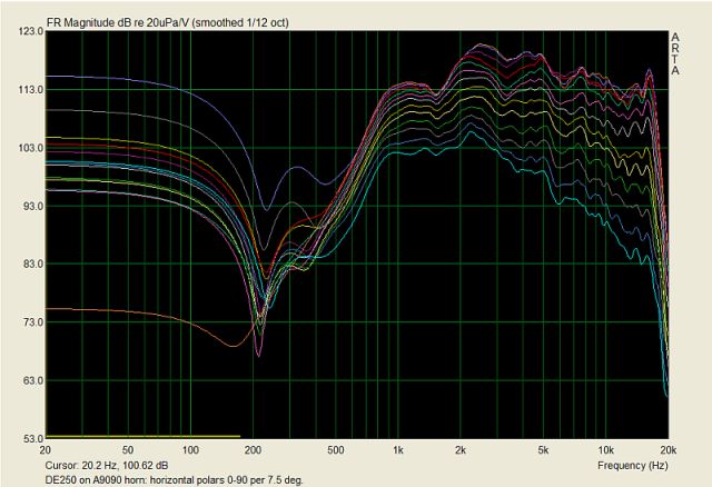

Interesting responses but none relevant to the design I have in mind which is neither a long planar ribbon nor a face mounted Beston type with a short loading wave guide.
My design is inspired by the superb Decca London horn, many of which I have owned in the past..and sold for silly cheap money back in the day!! I also had the Kelly diffraction ribbon classically placed between stacked Quads.
The London was a Tractrix and I am working with bi-radial of course on my design, but the slot is no longer a diffraction slot but instead matches the dimensions of the ribbon, and is therefore now a throat. The ribbon has a back chamber as did the Londons.
Of course back in the 70's Mr Keele had not designed the bi-radial flare, so performance could be interesting. I found these specs and polars for the London on the web and the horizontal dispersion is excellent. Bi radial might even be better and performance will have to be empirically measured as no other examples of this design exist. I am expecting vertical dispersion to follow suite and certainly be no "worse" than the London, and hopefully better.
