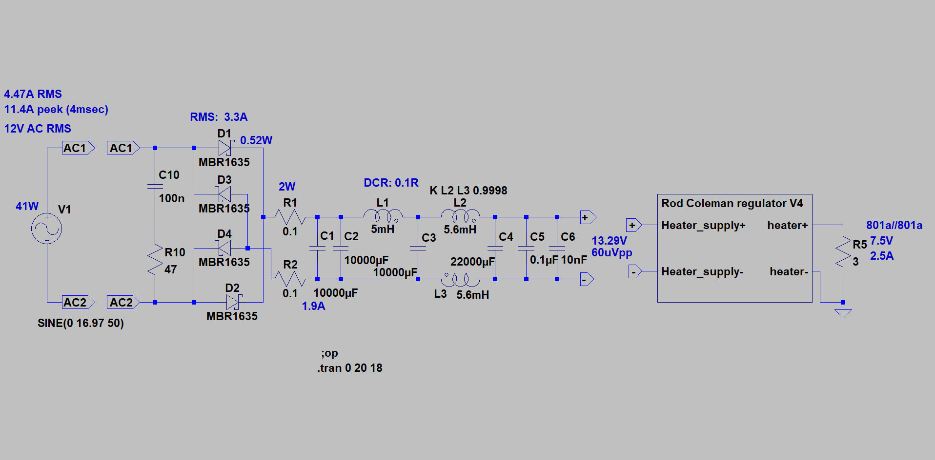

Here is the LC design:
FYI: Once I get the filament transformer mechanical hum problem fixed, I will be adding another choke. This will give a nicely supplied LCL. I am comparing the LCL to the LC + Coleman solution. Should be fun once the mechanical hum is fixed.

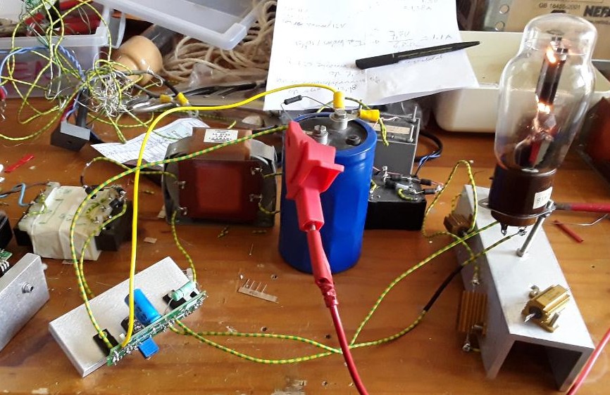

If you '' study '' the datasheet of Lundahl power transformers you will see that the given current rating is for choke input and if it is capacitor input the current rating is nearly 40 % lower. With a proper choke input ( enough mH) your transformer is probably still to small. You could check what happens if you use a BIG power resistor to achieve 2A current being drawn instead of the GM70..

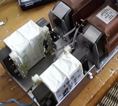

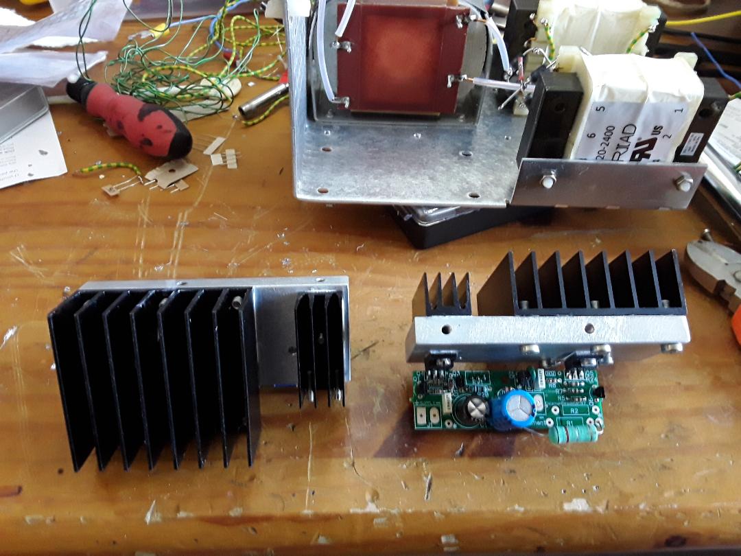

P.s I used Lundahl filament choke and rather small power transformer for my VT25A heaters

Rod just told us that the new V9 works better with CRC
Hello Eduard! It's possible that some LC Raw DC designs will prove to be fine with the V9. but they are very variable, and it is difficult to recommend them without testing. But the impedance must not rise much, at any frequency, to maintain the full performance of the V9.
I do like your heat-spreader, BTW.
Hello,
I just checked the specs of the parts i used
20 volt 2,4 A transformer.
LL2733 wired like pictured in the first post. Total DCR 3,4 ohm and 544mH choke rated for 1,25A but Lundahl always uses a big safety margin. AND because AC voltage across the choke is very small compared to the maximum ( 120 volts) current can be higher i was told.
I think that there wont be a problematic impedance rise because the Lundahls are build in a special way AND i am not using the new V9. Maybe i will if a better sound is guaranteed and brexit doesnt make things to expensive.
Greetings, eduard
High current capacitor charge pulses make transformer windings rattle. If no deep impregnation or potting is done on the coils, they will usually buzz. Even varnished only coils can result in the whole coil buzzing if it's loosely coupled on the core.
To test if this version, you could load the transformer with the equivalent load without any rectification - just connect a resistor across the secondary that results in the same RMS current. If buzzing stops, then you will know windings are the culprit.
If buzzing occurs even during an unloaded transformer, then the core is the noise culprit.

Hi Euro21, your CMC is drawn with the dots on opposite sides of the inductors.
I have seen some manufacturers (like kemet) drawn CMC with the dots on the same side
for common mode chokes. Some manufacturers (like TI) don't even draw the dots !
But this from this LL1673 datasheet
http://www.lundahl.se/wp-content/uploads/datasheets/1673.pdf
put the dots on opposite sides for "improved common mode rejection",
and no DC (single) choke is suggested.
Can you comment on those? I am here to learn and perhaps correct misconceptions that I might have.
If you connect CMC "dots on the same side", the "input" current flows in phase on both coils, so core magnetizing (due to the static current), and common mode noise cancellation not working. It's a simple choke with two coils and large flux.
If you connect it "dots on opposite sides", the static currents excitations extinguished (no flux), and common mode noises also extinguish each other (differential mode).
It's working as (common mode) noise cancellation device.
