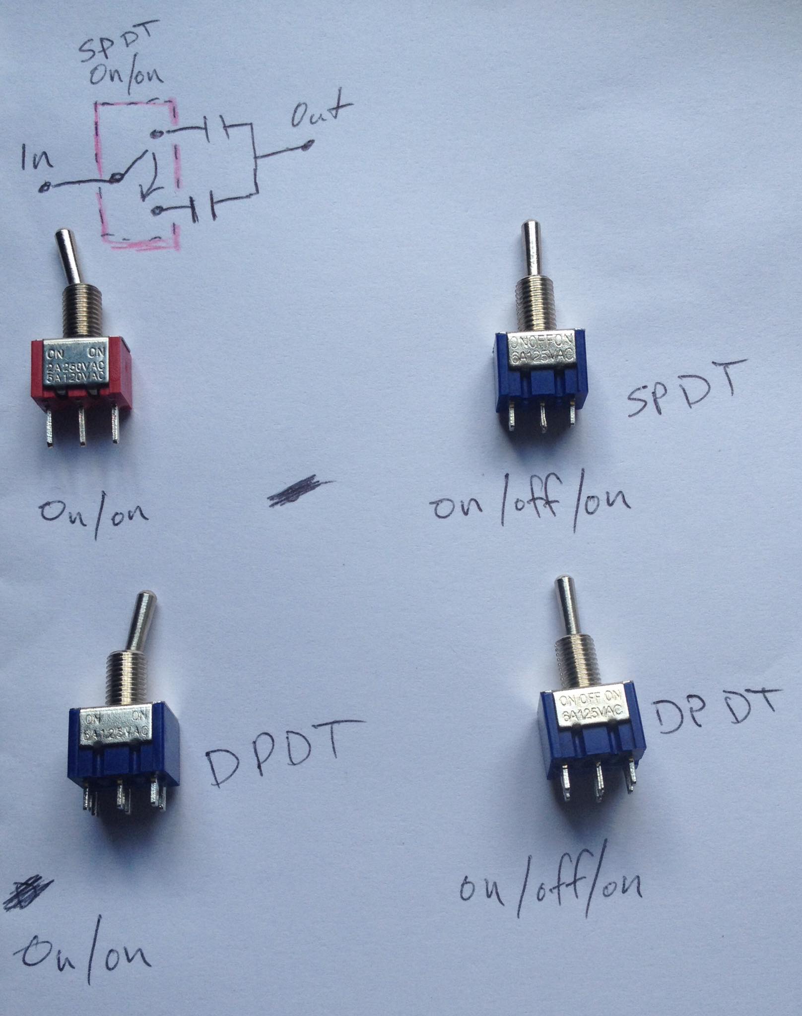

i'm looking for help with schematics for getting the most alternate value combinations out of capacitor switching using
- single pole on/off/on ,
-single pole on/on .
and maybe even double pole switching combinations for future projects if any one has any schematics.
I have been using 1pole 5position rotary switches for a 10n...... 100n switching though am looking for an easier way with getting the best from a single pole on/off/on or a single pole on/on, any help with a wiring schematic would be great thank you.
heres a photo of what i have been previously wiring for any one looking for interest sake.
I was also wondering when its best in circuits and what can be gained from using capacitor and coupling capacitor switching verses using resistor switching in lp /hp filtering instead. if it is all round better to use resistor switching? please excuse my lack of knowledge i am about 50% trial and error.

I don't really understand what the problem is, but maybe you can explain better what the issue is after you review 'break before make' and 'make before break' switching.
In general resistor switching is cheaper and better, because resistors are lower cost and more 'ideal' than caps. Resistors are available in 0.1% tolerance if that matters to you, try that with caps.

Are you looking to minimize the number of precision capacitors even at the cost of more complex switching?
Binary will be most efficient for a 1..2..3....10 sequence, even though four switches gives 16 values and you may only want 10.

hi,

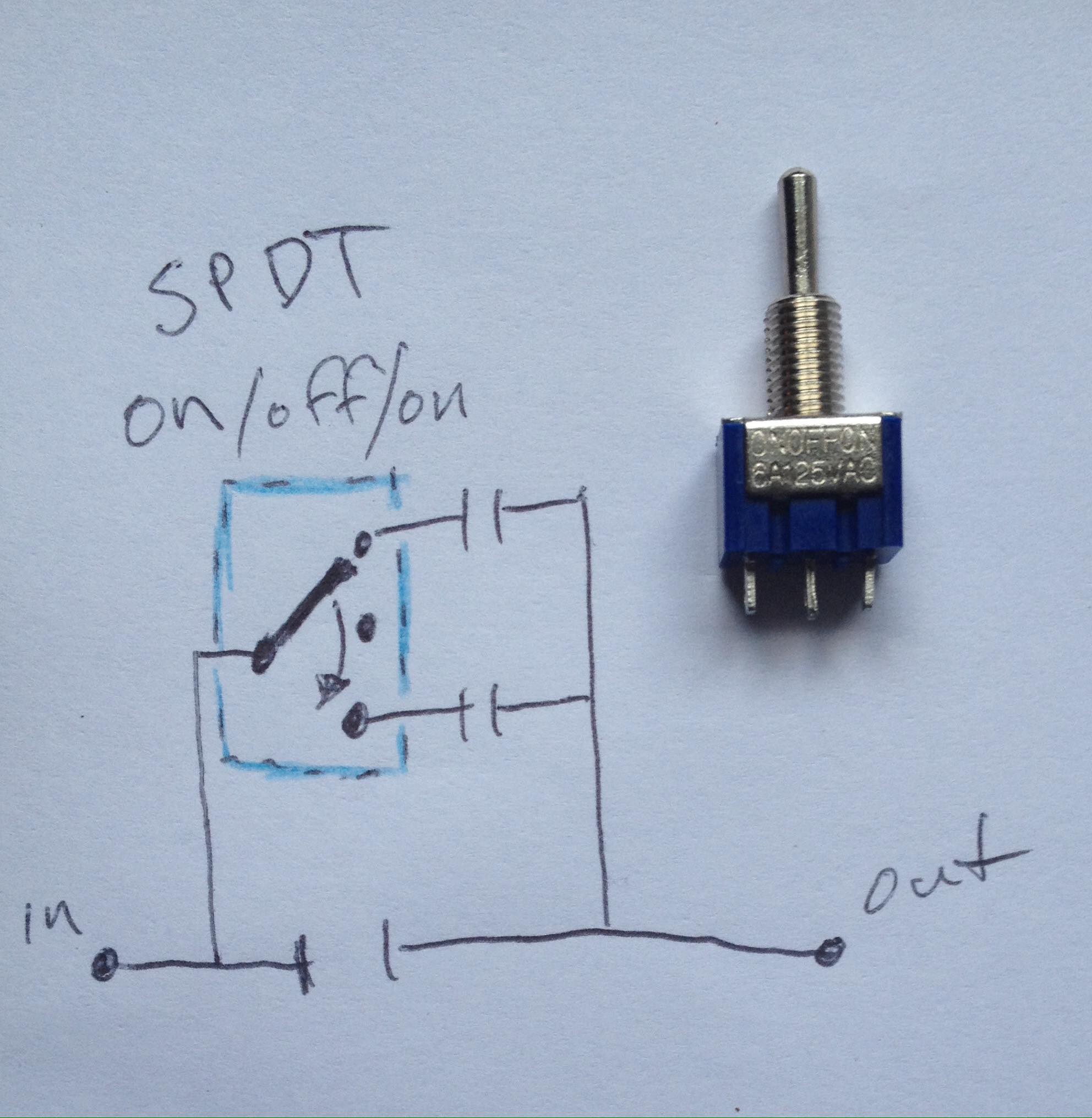

wow the binary switching is quite interesting, I was thinking to try use mostly the spdt switches i have in the top half of this photo. i can get two switching combinations from the on/on. was hoping there was a way to get three different values from the single on /on or on/off/on. maybe i could run the switching parallel to the circuit some how adding two values to a fixed existing value,
edit, figure 3 value from spdt on/off/on (photo 2)

I had the same idea as your photo 2. As long as you don't need one of your three values to be zero capacitance, that will work, and give you three different capacitances if you choose the three caps appropriately. For example, 10 nF, 10 nF, and 22 nF will give you three values of either 10 nF, 20 nF, or 32 nF.

The idea in your last diagram is fool-proof. Even if you forget how to set the switch for the capacitance you want, you'll still get some sort of usable sound out of the guitar. That's a good thing.
