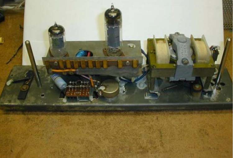

However, this amp also has a 3-head Meazzi Tape Echo on it as well. I have it in my hand now but it's missing two valves. I've been unable to find any schematics for this particular unit as well and I don't really want to guess what should be in there. Can anyone tell me what valves (and in which position) are used in this unit? The unit merely plugs in to the main amp body using a crude form of edge connector. Would be nice to get it working if it's possible.
It would also be useful to know the tape length of these units as I'll have to make one up.

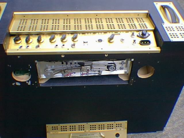

No, it's not a re-badged anything. It's a genuine Meazzi. A few pics enclosed. It's a Meazzi Manager.

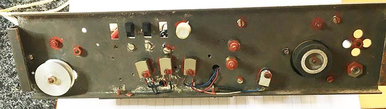

Some pics are enclosed of the amp and ts associated tape echo. I did eventually find out that the valve on the left of the pic is ECC83 and the one on the right is EL84 so I have a starting point at least.
Any further info anyone can contribute would be useful.

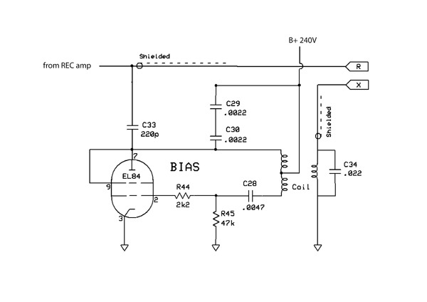

Just a guess but I think this tape echo would be really close to their echomatic, minus a few playback heads. Those heads were switched in and out of the total circuit, but you would still have basically similar record and playback circuits. You may need to trace the whole circuit out but it would be a starting guide..
schemaechomatic
schemaechomatic

the ecc83 is preamp, the guitar signal mixes with the oscillator signal to get it on the tape, the record head is just the same as the play heads but the erase is different
That el 84 is the oscillator circuit, there’s a small coil in there, be very careful with it they are hard to find, they oscillate around 50khz

if you still need it : the tubes on the reverb unit are EL84 and 12AX7. You can easily find wich goes where by looking at the heater wiring (12AX7 has pin 4 and 5 joined).
