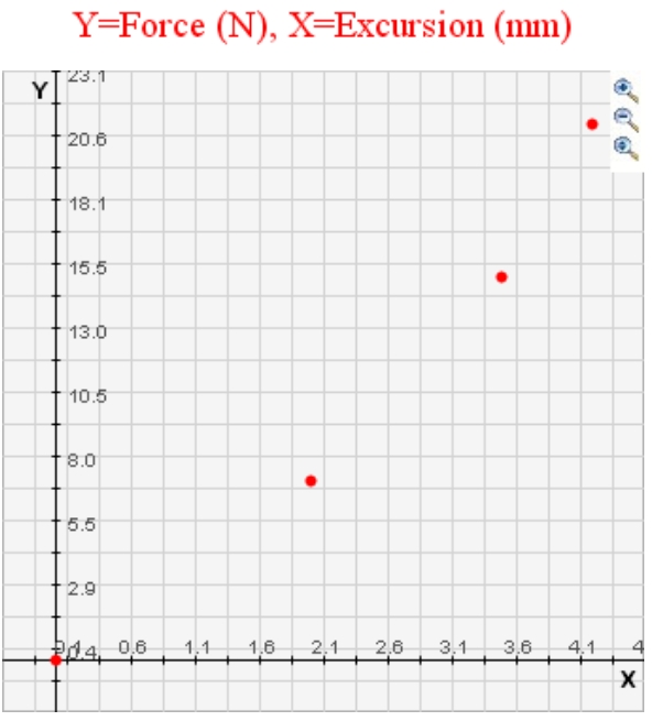

out of curiosity I measured force vs excursion of the woofer suspension. Just one way, and very "static" measurement, just put coins on the cone.
7 Newtons - 2mm excursion
15 Newtons - 3,5 mm
21 Newtons - 4.2 mm
Xmech is about 5.5 mm
I also made a graph as attachment
If my measurements are of any use, could I conclude that I will not have strong compression (due to the suspension) at the calculated 70%BL-xmax of 3,6mm? Looks kind of like progressive suspension?
