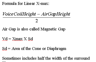

There are two types of Xmax-linear and mechanical maximum. The linear type is the most quoted kind, and is smaller than the mechanical maximum. Within the linear range, the speaker operates relatively distortion free. Outside it's linear range, distortion rises sharply until the speaker hits it's mechanical limit-Xmech. Still, the speaker is able to operate and produce sound outside it's linear range.
Unless specified as Xmech or something similar, Xmax generally means linear Xmax.
If given the Thiele-Small parameters, you usually can calculate the linear Xmax for a speaker. You need the Voice Coil Length and the Height of the Magnetic Gap, (sometimes also called Depth of the Gap, or Air Gap). Just make sure the word "gap" is in there, LOL.
Then:
Xmax = (Voice Coil Length - Height of the Magnetic Gap) / 2.
If Voice Coil length is .75" and the height of the magnetic gap is .25", then Xmax = .25".
For Voice Coil Length, most hi fi speakers run from 3/4" up to 2" for some super-pumpers. The magnetic gap is generally about 1/4"-or 6 mm to 8mm.
If anything, the calculated response gives a stricter figure than the measured response. A calculated Xmax of .25" will often show up as .29" in a DuMax test, for instance. These differences are not important.
For an 8" or larger speaker that gives no specs, assume the Xmax to be .2 inches. If it gives the Voice Coil Length, assume the Height of the Magnetic Gap to be either 1/4" or 6 mm to 8mm. So a speaker with a .75" Voice Coil, you can assume it will have an Xmax of .25". If it has a one inch voice coil, you can assume it will have an Xmax of .36"-which is very good.

I should add that it is a good idea to check the voice coil length and magnetic gap height for another reason.
Most manufacturers give the Xmax as meaning the distance the cone moves from the center position all the way forward. Or, from the center position to all the way back.
However, some manufacturers, chiefly car manufacturers, give the disatnce the cone moves from all the way back to all the way front-double the distance from center to front.
That is why speaker manufacturers frequently give their Xmax figure as (+ or -).25 in, or something similar. A plus or minus figure means they are measuring from center to front, or center to back, the way they should. A plus or minus figure they are not measuring front to back, which gives an inflated figure.
However, when you know the voice coil length and the gap height, you can double check the Xmax figures, so you can know for sure.
Thought I would just give a graphic of the formula for Xmax. Voice Coil Length is sometimes called Voice Coil Height.

Doug:
The wiz has it down on the money.

Lc= coil height, Hg = gap height. I have an Eminence 12cx with 1.6mm xmax figure and by the 70% BL factor mark formula below, would be rated `"4mm"
from DJK "The coil is 0.5" long, the top plate 0.375" thick" on my Eminence 12cx.
While the coil overhang is about 1.6mm, the 70% Bl point is about 4mm.
(Lc - Hg)/2 + 1/4(Hg) = x-max (70% Bl).\
