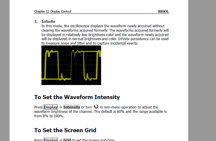

The adjustment procedure assumes an analog scope, set at a low sweep rate to see the envelope of the signal.
You should activate the "digital phosphor", or "peak" or "envelope" mode on your scope to mimic that.
If the variations are too large, it would point to mechanical problem: something off-centered for example
That's why you need to average lots of different traces.
The acquisition/display modes on this scope model look scanty.
You could try the infinite mode, in free-running mode: trigger disabled or set to an unused channel:
attachment.php
You should see a band having a more or less homogeneous brightness, and the height of that band should be 6Vpp.
If you see too many irregularities, it probably means you have some kind of mechanical issue
