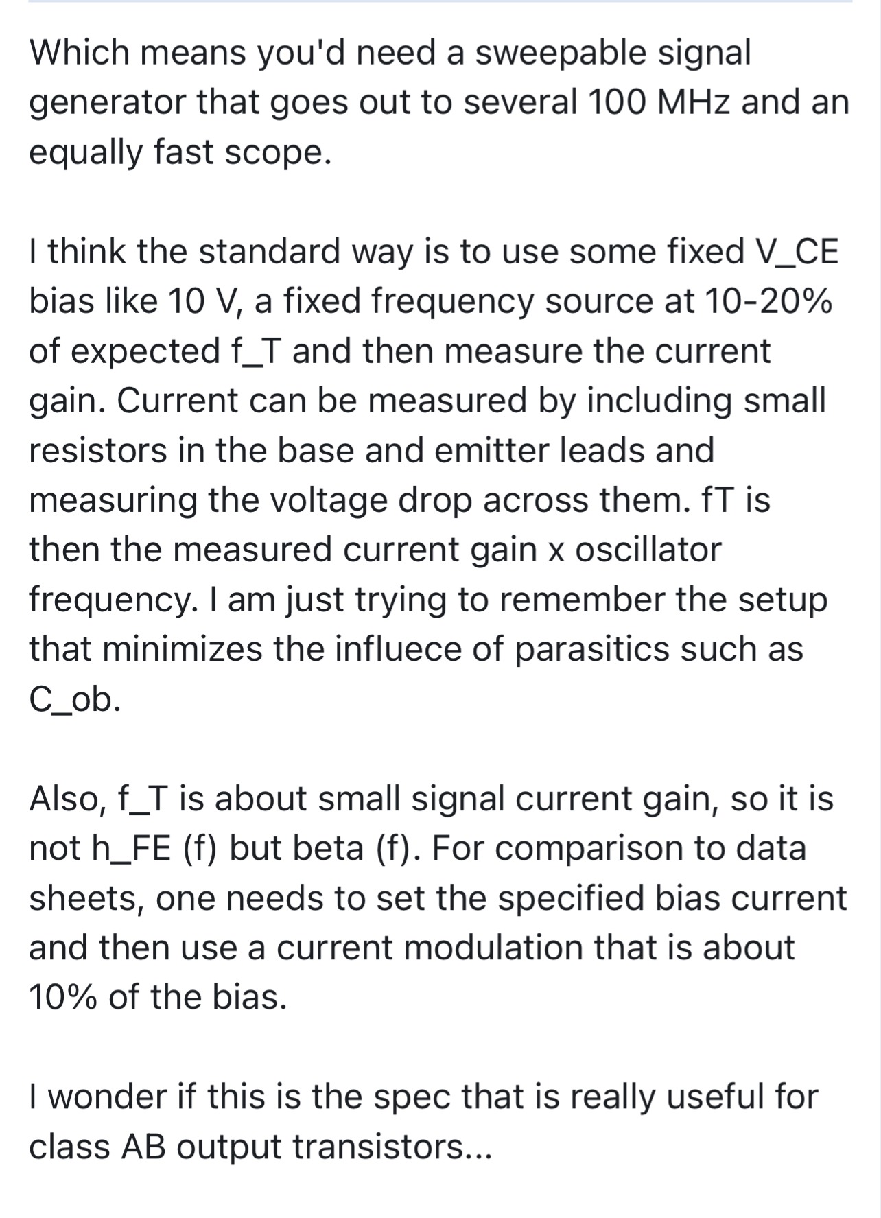

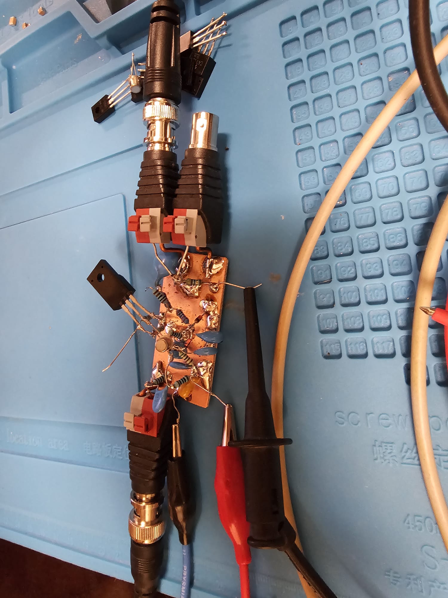

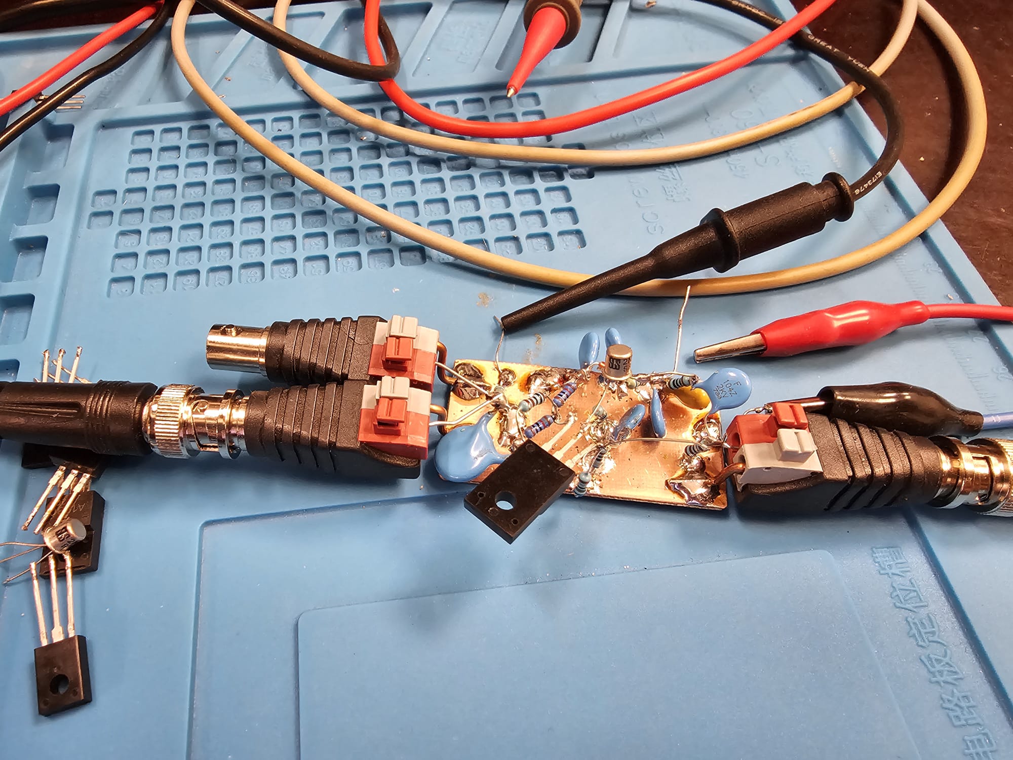

Measuring transistor parameters, specifically Ft
I’ve been reading up trying to figure out how to measure transistor Ft. I currently have three transistor testers, Peak Atlas DCA75 which I use for gain matching and checking overall health of the transistor, a Heathkit IT-3121 that has been fully restored, and a Hickok model 440 that has been fully restored. I don’t think any of these will get me Ft.
I’m not wanting to measure extremely high, maybe 120 MHz max, maybe 150. My oscilloscope is a Rigol DS1102E which is a 100 MHz scope, but if I need X-Y function I don’t think it has that. I do also have a Tek 7603 with a pair of 7A18 modules (75 MHz) and a 7B53 triggering module. I do plan on upgrading my digital scope soon though. I have a signal generator that will go to 2 GHz.
I have found small snippets of info, but nothing concrete on how it’s done.
I’m wondering if these statements can get me started. I figure it would be a good skill to learn to, if nothing, root out fake devices and help determine unknown devices.

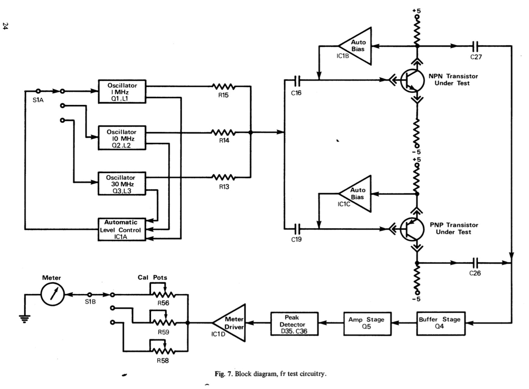

Pages 24 and 25 of the BK Precision owner's manual discuss the way their instrument measures fT. You could design and build your own hardware to work the same way.
Then pages 38 and 39 of the BK Precision owner's manual discuss the theory of fT and putting that theory into practice.
All four of those pages are collected into a single Acrobat .pdf file, which is attached to post #2 of this thread. You can read them right now if you like.

I can’t get enough info (ie, I’m not skilled enough) to come up with a schematic with the info provided on the pages. Here it is for everyone else.
Like choosing the auto biasing IC, buffer, amp, detector. Above my head.

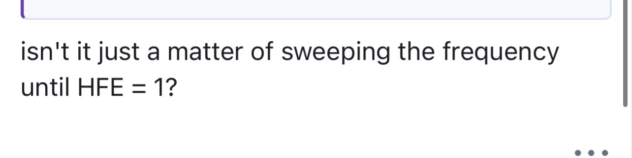

For some reason, I was thinking there was a way to use a power supply, signal generator, and a scope to see where amplification stops. I love it when I can find a neat little schematic like Nelson’s jfet and mosfet matcher. Whipped it up and then measuring across a resistor I was able to Idss match fets.

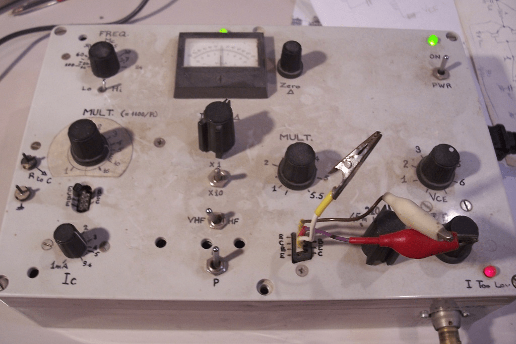

I have a home-built Ft-meter based on first principles (emitter current is modulated and the resulting base and collector are measured and compared). Vce and Ic can be set over a wide range, and the maximum frequency is in excess of 1GHz (extrapolated), but it is a big, complicated kludge, designed and built before the electronic documentation era, meaning it would be difficult to share and reproduce, unfortunately

I can try to dig my paper archives, and scan whatever I deem usable, but I promise nothing: it was a long time ago, and the documentation was meant for my own use, just to make the thing work.
I am not even sure I can still make sense of what I wrote ~25yrs ago.
I'll try, anyway but the principles are sound and universal and can be reused in a more modern instrument. IIRC, the main difficulty was the need to accommodate both polarities, switch the current and voltage ranges, etc. If you just want to measure a single transistor for a fixed set of conditions, you can probably get away with just regular lab instruments and some ingenuity.
Making a universal instrument is much more painstaking.

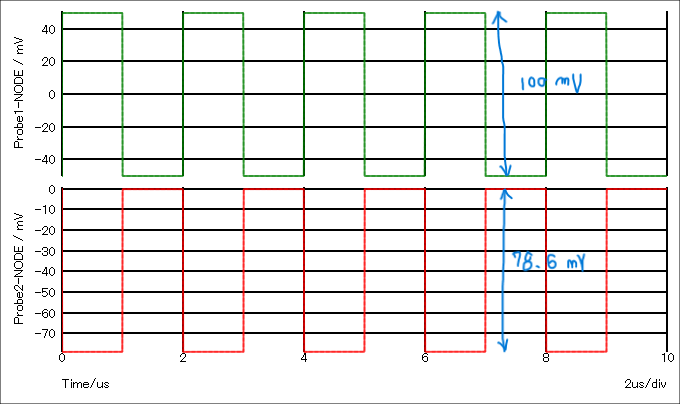

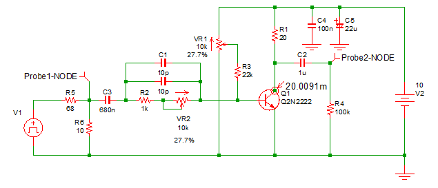

Since you seem to have a scope with sufficient bandwidth, do you have a generator capable of generating a square wave of several hundred kHz?
If you have one, you can measure ft using the following procedure with a relatively simple circuit.
1. set the collector current by adjusting VR1.

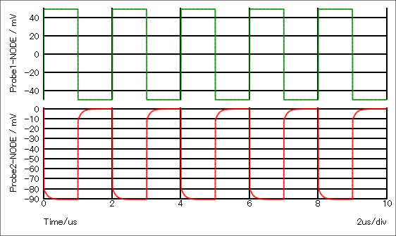

2. apply a square wave to the input (probe 1) and adjust the value of R2 (actually a trim pot) so that the output waveform (probe 2) is a square wave - a similar procedure to adjusting the probe on a 10:1 oscilloscope.
3. read the input amplitude Vin and output amplitude Vo on the scope.
4. determine Ft using the following equation.
Ft = (1/(2*πC1*R1))(Vo/Vin)
Note that there is no "Ft" in the model parameters in SPICE, but the forward transition time "TF" is specified.
Since TF = 1/(2*π*Ft)
The TF can be calculated as follows.
TF = C1*R1*(Vin/Vo)
Specific steps are shown on the simulation using the 2N2222 model as DUT.

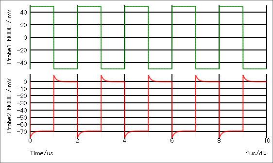

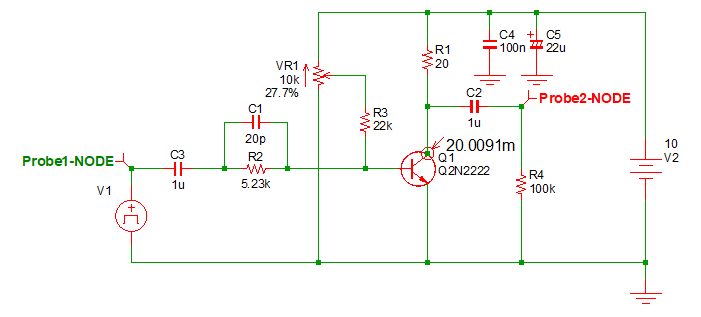

1. aiming for a measured collector current of 20 mA, VR1 was adjusted to 20 mA at the 27.7% position. In the actual measurement, measure the voltage at both ends of R1 with a DMM.
2. add a 500 kHz 100 mVpp square wave to the input. Adjust the value of R2 while checking the output waveform: if R2 is 6 kΩ, the rising and falling edges overshoot;
if R2 is 4.5 kΩ, the rising and falling edges round off;
if R2 is 5.23 kΩ, the output waveform is a clean square wave.
3. The output amplitude at this time was 78.6 mVpp.
4. Ft = (1/(2*π*20p*20))(78.6m/100m) = 312.7MHz.
 TF = 20p*20*(100m/78.6m) = 0.509nsec.
I checked the parameters for my 2N2222 model and found TF = 4.00E-8 i.e. 0.4nsec.
This difference could be reduced by increasing the collector current value a little more. However, be aware of the heat generated by the DUT in the actual measurement.

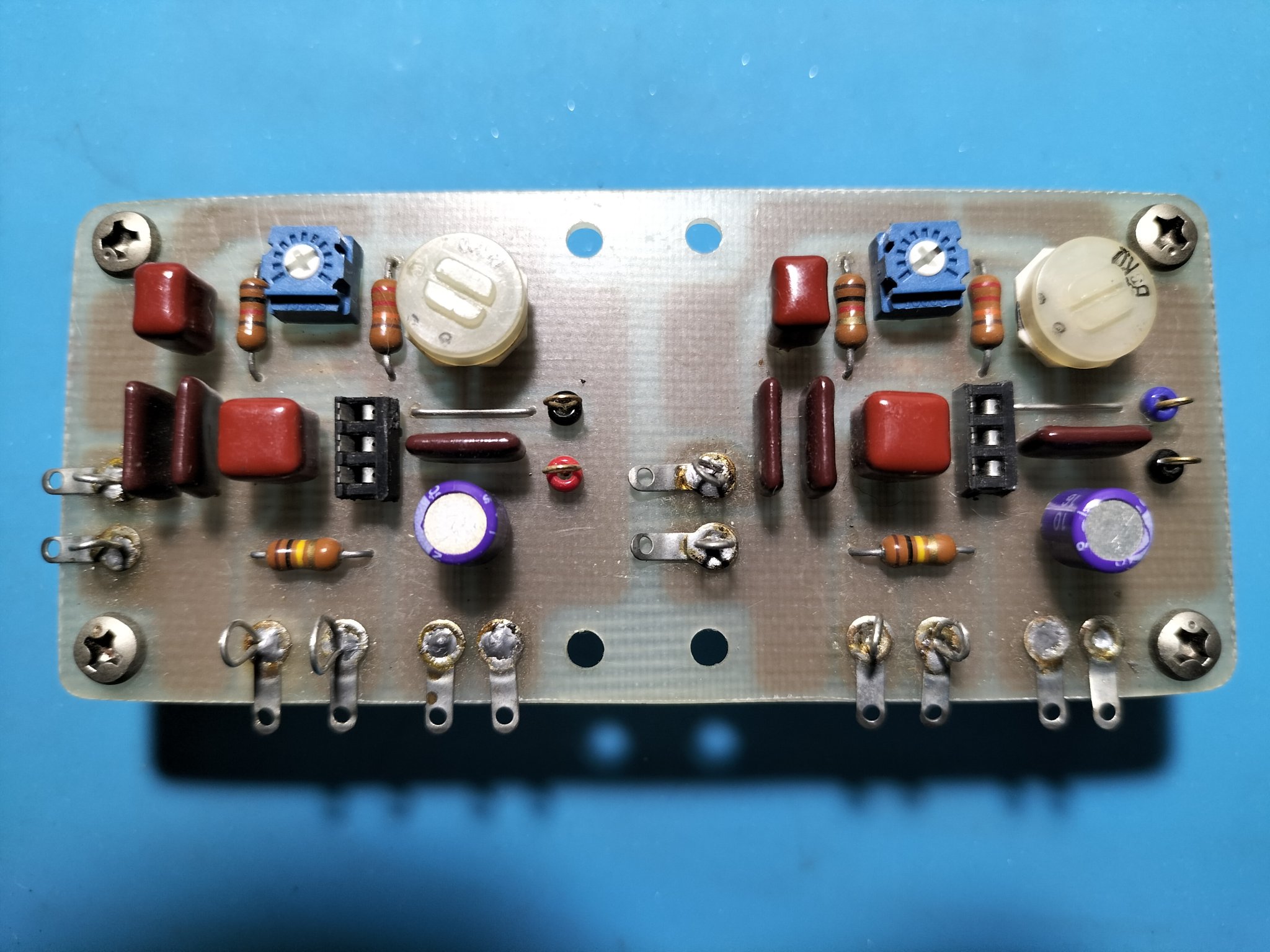

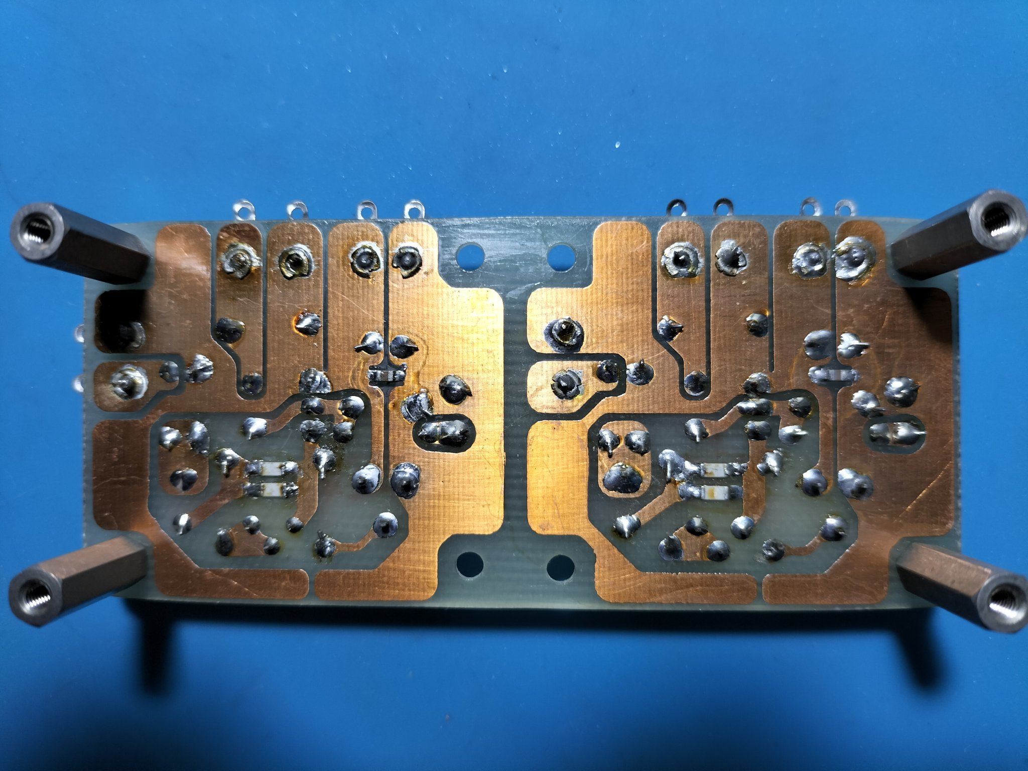

I built and used a board for this measurement almost 20 years ago. The left one is for NPN and the right one for PNP. The traces on the boards are exactly the same, only the polarity of the power supply and electrolytic capacitors is different.
(Some differences from the circuit diagram above)
R1 uses a plate resistor with low inductance, but SMD is better. Due to the availability of parts on hand at the time of production, 20pF seems to use two 10pF SMDs. (It was a long time ago, so I don't have a very accurate memory.) If it is a circuit of this level, I think it is possible to produce it with a perfboard.
View attachment 1340781(Some differences from the circuit diagram above)
Awesome! Something like this is exactly what I was looking for. You say certain components are better being SMD, with the circuit as a whole be better if it wasn’t entirely SMD?
Dan
SMD is only desirable in low resistance areas, such as load resistor R1. This is because at low resistance values it may not be possible to reproduce a clean square wave due to parasitic inductance effects. My board has an input attenuator, which is not shown in the circuit diagram, and its resistance value is also low, so I use a plate resistor. Other precautions are to keep the impedance of the power supply low to high frequencies (0.1uF SMD ceramic CAP + OS-CON near R1) and to use a small trim pot for R2 to reduce parasitic capacitance.
The circuit diagram of the actual board is attached for reference.
These values are suitable for measuring BJTs for small signals. When measuring BJTs for high currents, a larger value for C1 and lower values for R1 and other resistors would be desirable.
