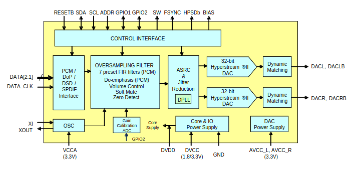

All ESS dac chips operating in the default (single clock) mode apply ASRC internally to all digital inputs. Thus they are non-bit perfect at that point in the processing.

But that is happening after the digital filters, that is, the filter's output stream is resampled but not the input stream.All ESS dac chips operating in the default (single clock) mode apply ASRC internally to all digital inputs. Thus they are non-bit perfect at that point in the processing.
And these filters are present in any DAC (except NOS) and they always destroy bit-perfectness by sheer definition.

It is possible turn off ESS oversampling filters, as Benchmark does in DAC-3. They use their own FPGA instead. The ASRC can be turned off tooBut that is happening after the digital filters, that is, the filter's output stream is resampled but not the input stream.
I did say we could go on and on. I was thinking of the complex processing common in oversampling dacs. However, I thought the point was sufficiently made by then that "bit-perfect" usually only remains intact for a limited time.And these filters are present in any DAC (except NOS) and they always destroy bit-perfectness by sheer definition.
