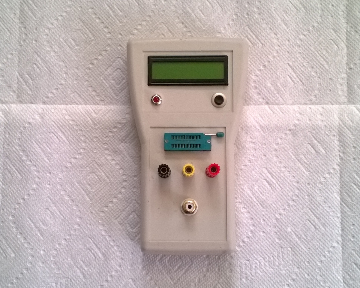

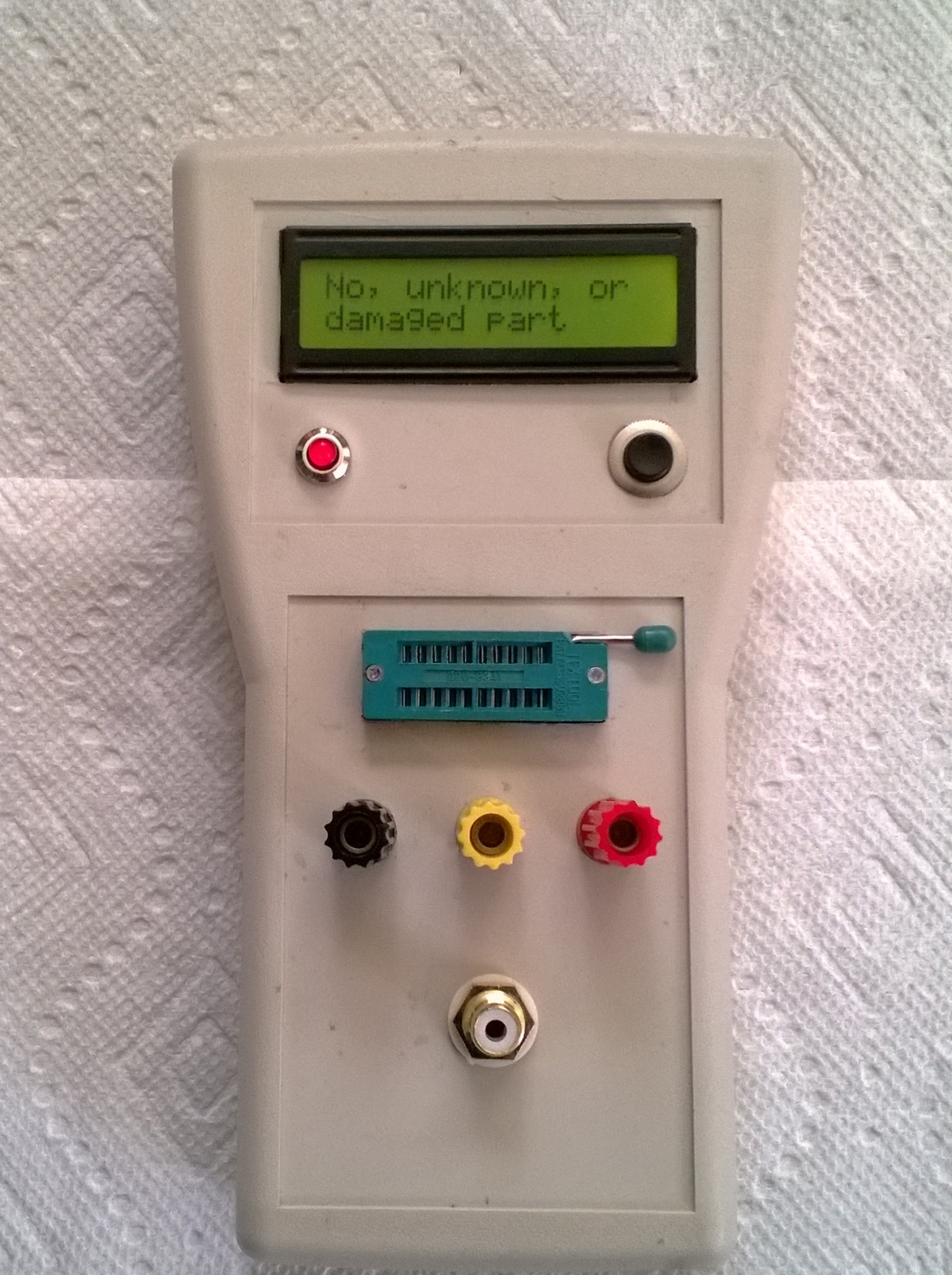

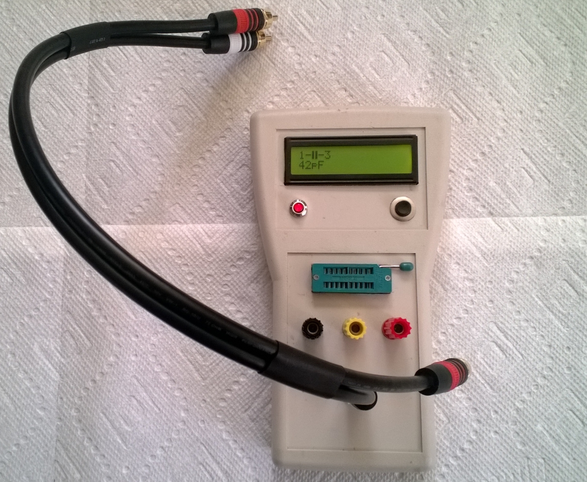

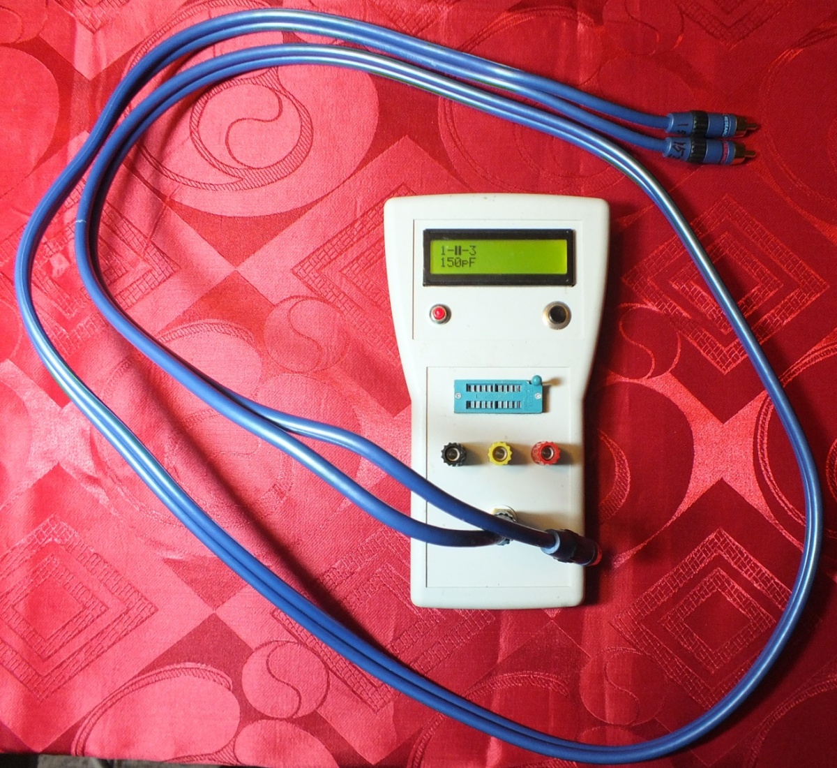

As a result, I got myself a device capable of measuring cable capacitance with an accuracy of up to 1 pF. The device can be seen on the pictures below:
I then measured the capacitance of all RCA cables that I had in my possession.

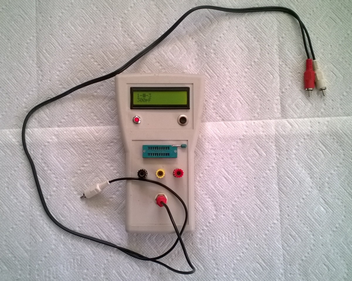

I started with regular/generic RCA cables that came bundled with some of my DVD and CD players. All those cables have a length of 3-6 feet and their capacitance measured from 300 to 600 pF. The best generic cable had a capacitance of 328 pF per meter, which is too high for my tastes.
Generic RCA cable (328 pF per meter):
After that, I turned my attention to some of the premium cables that I had lying around. Surprisingly, the relatively cheap, Monoprice-branded cables were not worse (and sometimes even better) than much more expensive, premium RCA cables.
Monoprice 1.5ft Premium RCA 22AWG Cable (92 pF per meter) (1.5ft Premium 2 RCA Plug/2 RCA Plug M/M 22AWG Cable - Black - Monoprice.com):

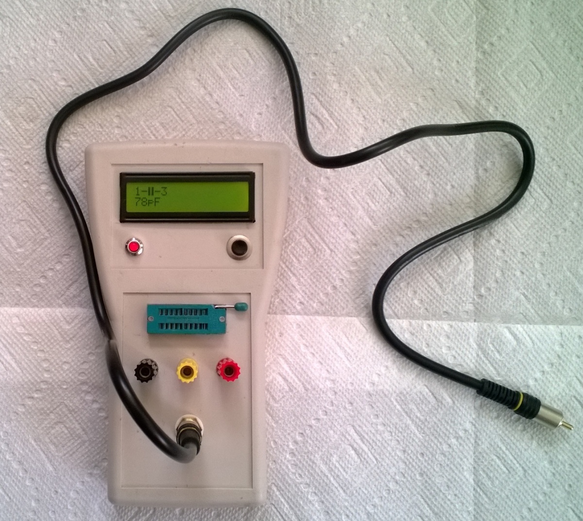

ATLONA Double Shielded Composite Video RCA Cable (78 pF per meter) (1M 3ft Atlona Composite Video RCA Cable TV DVD VCR Double Shielded Gold Plated | eBay):

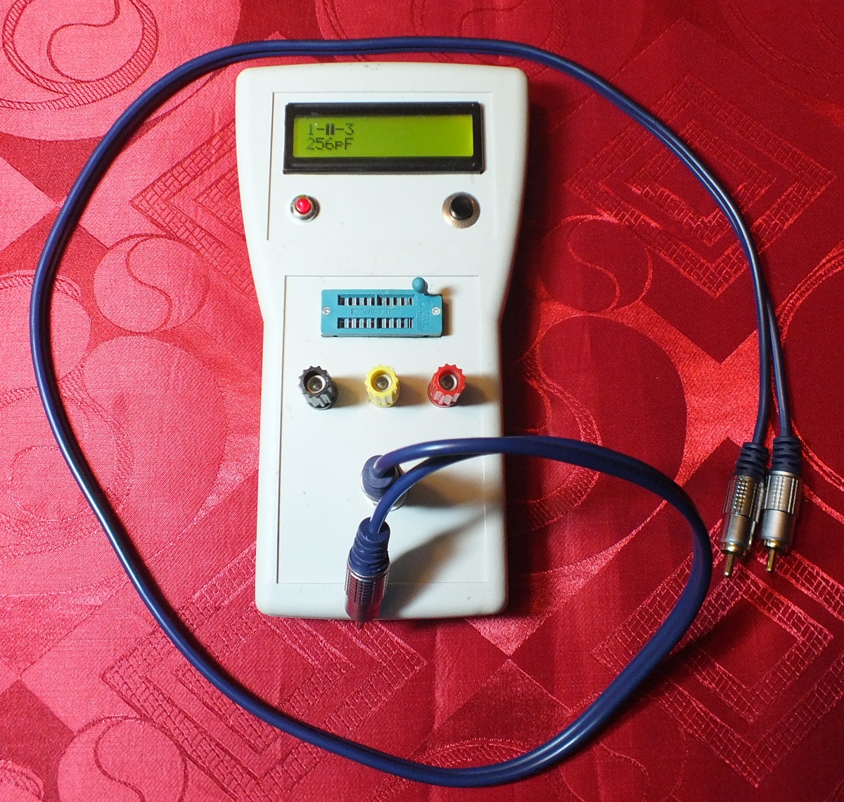

kenable Pure OFC HQ 2 x RCA Phono Plugs (256 pF per meter) (Amazon.com: kenable Pure OFC HQ 2 x RCA Phono Plugs to Plugs Stereo Audio Cable Gold 1m (~3 feet): Electronics):
Acoustic Research Performance Series Component Video Cable (82 pF per meter) (Amazon.com: Acoustic Research Performance Series Component Video Cable: Computers & Accessories):

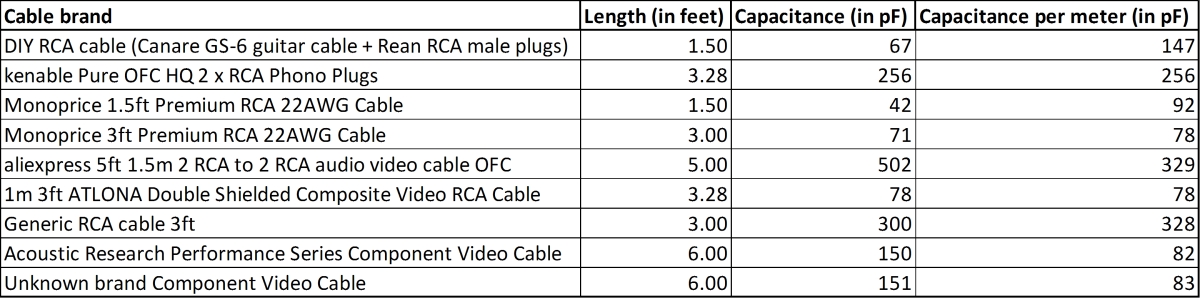

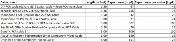

Edit: There was a silly error in my Excel formula for converting feet to meters. The original post has been updated to show the correct values. I apologize for any inconvenience.
Here is the fixed table:

I notice that the figures in the first post have now changed! The 25pF cable is now 83pF.
Video cable should have an RF characteristic impedance of 75ohms, and will normally have solid PVC dielectric giving a velocity factor of 0.66. It should therefore have a capacitance of 66pF/m. Either it isn't genuine video cable, or you have a measurement problem.
The low capacitance of cheapo RCA cable may be a sign of very poor shielding.
You were right! There was a silly error in my Excel formula for converting feet to meters. The original post has been updated to show the correct values.
