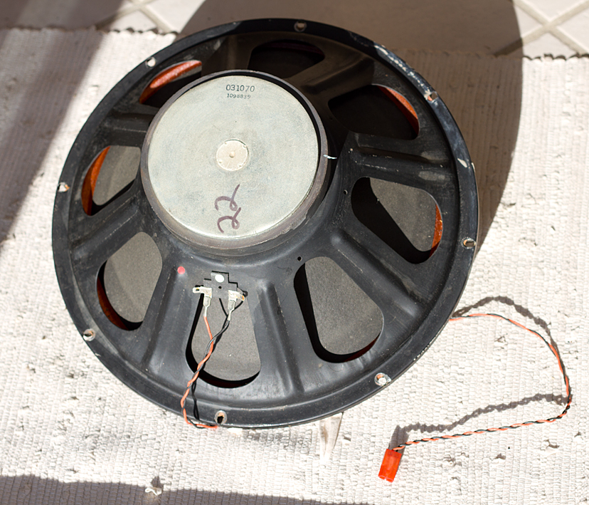

I bought an old not working Leslie 822 and ripped the motors and speakers from it. It was build in Denmark like many of the ´newer´ Leslies we see here, but it had 117v motors. A Leslie 960 I have, have 230v motors.
It had an original Jensen V20 or V21, 16 ohms that works, and the woofer is 4 ohms. That didn’t matter at that time because it had 2 transistorized amps that could be tuned individually. I am going to make it passive, hopefully in a smaller cab, so I can hook up a valve amp top, and just have a pedal for the motor controls.
I have not been able to find any T/S parameters for the old Jensen’s anyshere, and I have for a long time had an interest in trying to measure T/S parameters myself. I have the necessary equipment to do it, and I found a very good practical introduction on the ESP web site. It has a thorough explanation how to do the measurements, and a well working spreadsheet to calculate the T/S parameters afterwards (be aware it is using 2 sheets).
I used the Added Weight method to measure Vas, because it is easier and because I have a weight that is precise down to 2 decimals in grams.
I suspended the woofer in free air and used 1 volt output and I hooked my Fluke meter over the amps output to be sure about the output at all times, and to my surprise I had to adjust the output slightly at every frequency. The amp is a small Class T ´50w´ amp. Does it mean that the amp is unstable? And how does Class T amps distort- pleasing or not pleasing in a MI sense?
All in all I took great care in the whole process to measure correctly, and the sanity check in the spreadsheet were very close (58.54 vs. 59 Hz), but I got some quite weird results:

Jensen C15? Jensen models normally began with a 'P'. University with a 'C'.
Regardless, back then these drivers were 'all of a same', so they could be cross loaded with each other and to the 'class leader', Altec's 803; ergo an Fs in the low 50s [often closer to 60], Vas in the 6-7 ft^3 and Qts in the 0.2-0.28 ranges, so 'batting' two out of three.
Even if this one was made long after SS amps became the norm, the Qts should still only have risen to the 0.4-0.7 range depending on the date code, so at >2x this, no clue why, what with the others being ~spot on.
BTW, what is the date code?
GM
Hi GM,
Jensen P were Alnico and C were Ceramic, or actually still is.
It has a Leslie part number which is 031070, and another number which is 1098839.
They were OEM´d by Leslie.
There is also a number on the backside of the cone, but it is totally smeared, so it is not readable.
Best regards
Arthur.

Just curious, how do you know it's a Jensen speaker? (and not a Rola / Oxford / Utah / CTS / Eminence / EV)
Please post all codes found on it.
Jensen in general would have stamped a 6 digit code (220 something) in white ink somewhere on the frame, usually the frame edge (where the mounting holes are) , sometimes with black ink on the magnet, very few times on black ink on the (light grey/brown) gasket edge, I see none of that, only a 109 something.
031030 is the internal Hammond/Leslie code for that speaker, actual manufacturer might have been anybody who won the bid that year.
Fahay,
there are no more codes on the frame, just doublechecked.
I dont know exactely, but read that Leslie allways used Jensen P15 and C15 for woofers, and Jensen V20 and V21 for treble drivers.
And I have had a Jensen C12 smooth cone that exactely looked like this one, just smaller.
