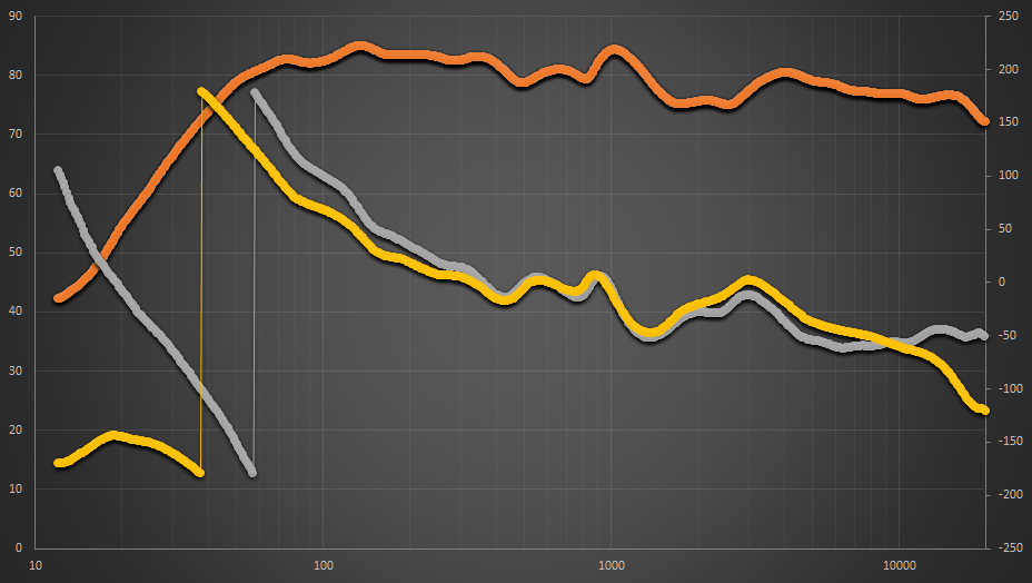

I was curious to check this; I visited a neighbour running a pair of KEF coaxial bookshelves (Q1 if memory serves) and measured them. Of all multiway speakers, coaxials should definitely be close to minimum phase.
Yes indeed, the measured phase using OmniMic and the extracted minimum phase from the FRD spreadsheet are close enough. Though, I wonder where the delta in the phase jump frequency (55Hz measured, 35Hz calculated) comes from? Based on the speaker high pass ~3dB point I believe the measured phase is correct.
Orange, Gray - measured "far field" FRD (about 10cm away, pointing at the half way between the cone and the port), 250mS window
Yellow - extracted minimum phase

Most coaxial driver combinations complete with cross-over are not minimum-phase. Computers are great for measuring phase, because measuring phase by old-fashioned analogue means is difficult, yet computers are not to be trusted.
Well, the KEF Q1 seems to be minimum phase 😕. The match between the measured and the calculated phase is remarkable. KEF seem to target this on purpose, at least in the past:
